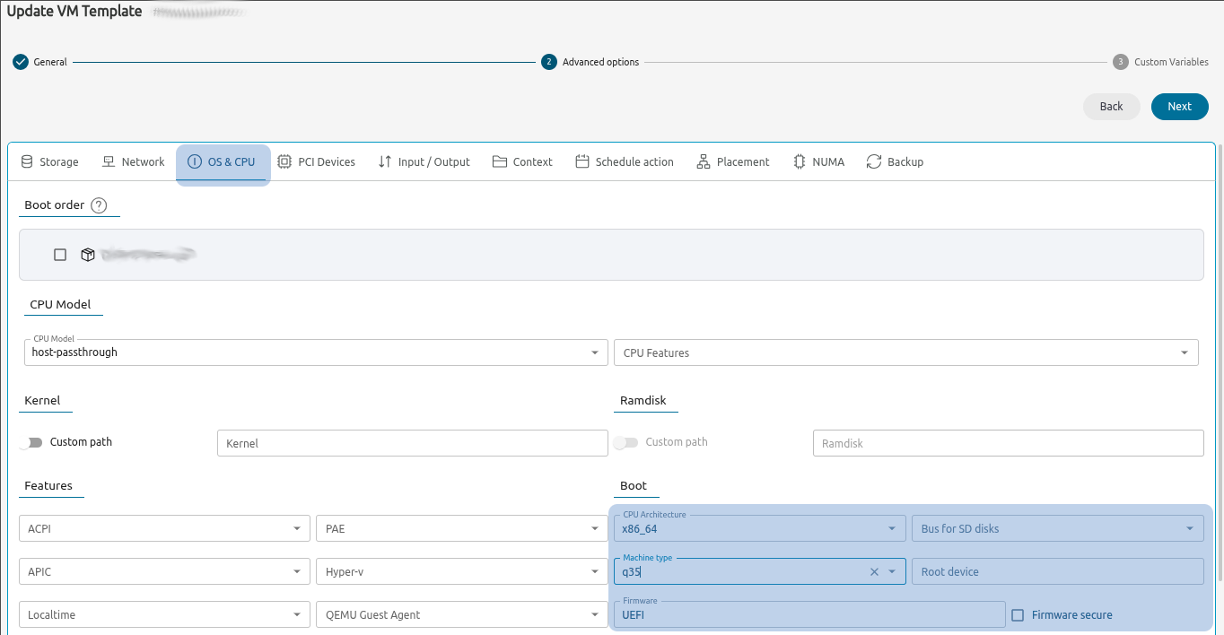

Virtual machines with UEFI BIOS
OneSwap normally detects if the VM boots in UEFI mode and sets up the OpenNebula template accordingly (including Secure Boot detection), but in some strange cases autodetection may fail. The firmware paths configured in the template can be customized with the --uefi-path and --uefi-sec-path options (by default OneSwap uses the OVMF firmware files shipped by the distribution, e.g. /usr/share/OVMF/OVMF_CODE_4M.fd on Ubuntu). If autodetection fails, modify the following options on the OpenNebula template:
CPU architecture:
x86_64Machine type:
q35UEFI firmware: UEFI (for secure firmware the box must be checked)

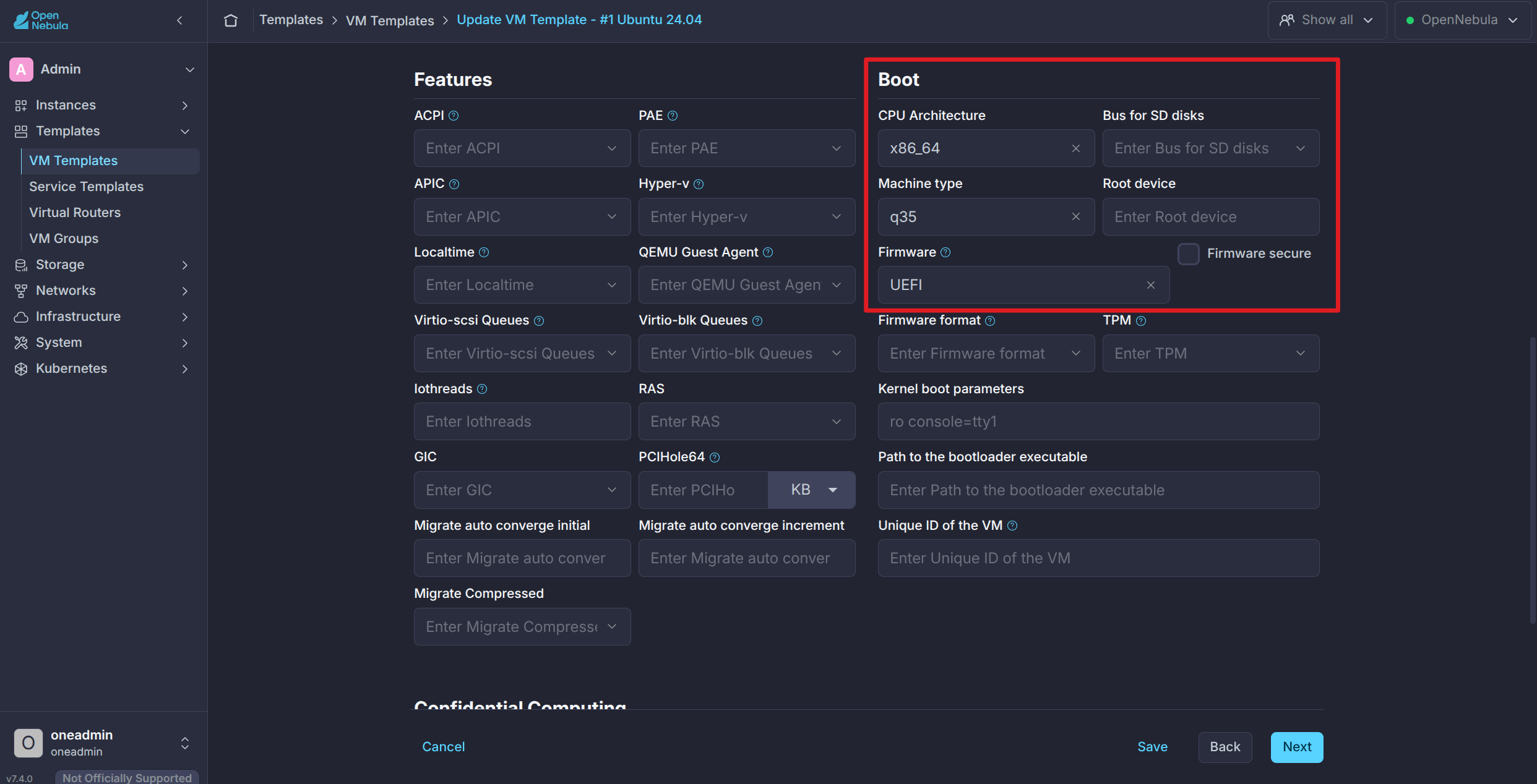

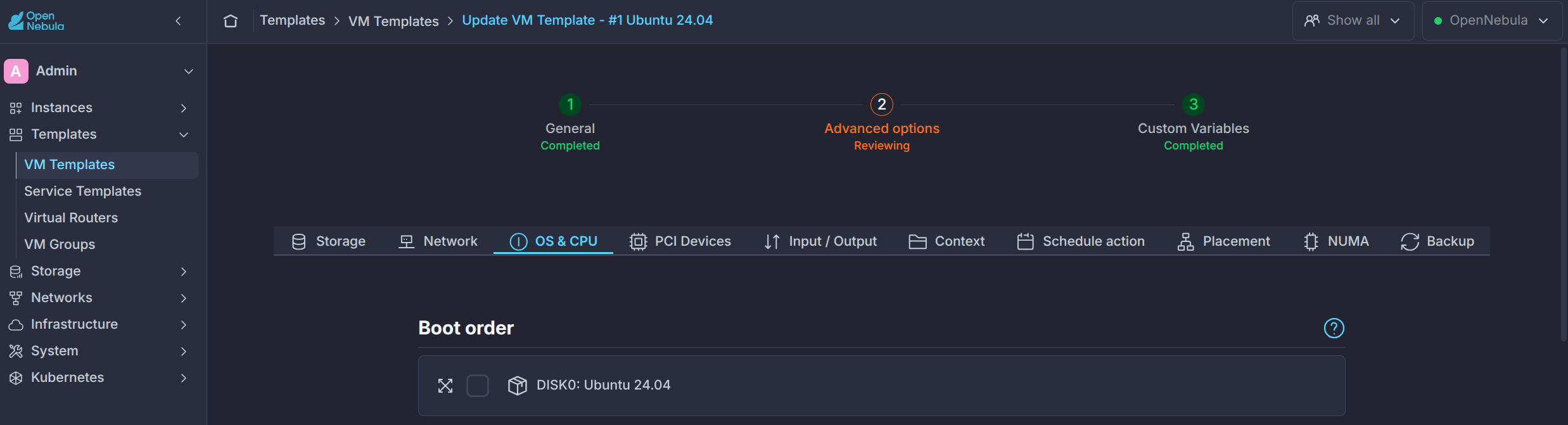

- In step 2 of the wizard Advanced options choose the OS & CPU tab:
- Scroll down to the Boot section and adjust the settings:
