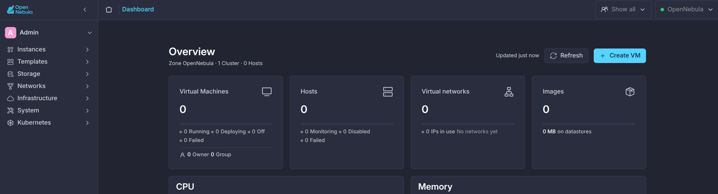

The screen will display the Sunstone Dashboard:
Sunstone dashboardSunstone dashboard
As you can see, the Dashboard indicates the following installed components:
  • 1 VM template
  • 1 image
  • 1 Virtual Network

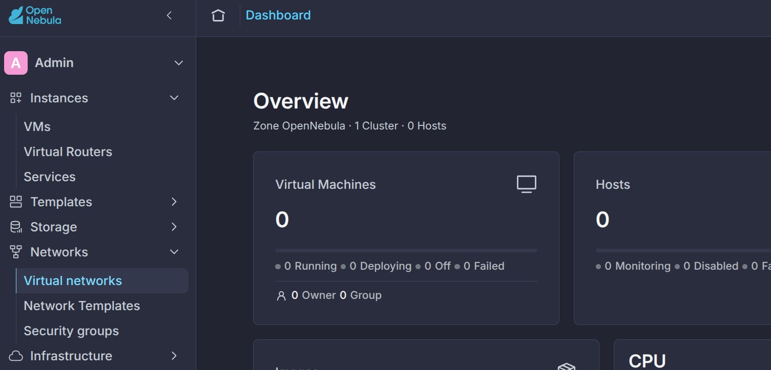

The existing Virtual Network is a bridged network attached to a local interface named vnet. To inspect this network, in Sunstone open the left-hand menu (hover the mouse over the left-hand sidebar), then click Networks –> Virtual Networks:
Sunstone select vnetSunstone select vnet

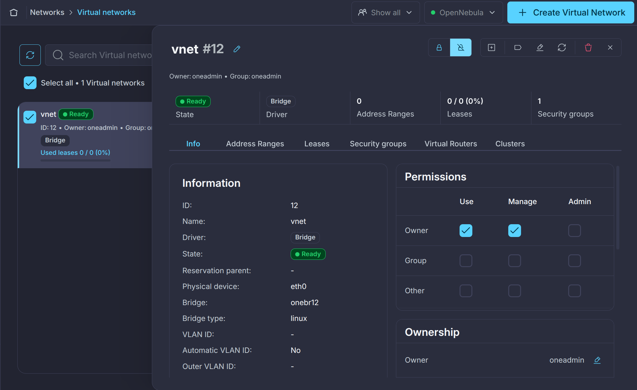

Sunstone will display the Virtual Networks screen. Click the item labelled vnet to display information about this network:
Sunstone vnet screenSunstone vnet screen

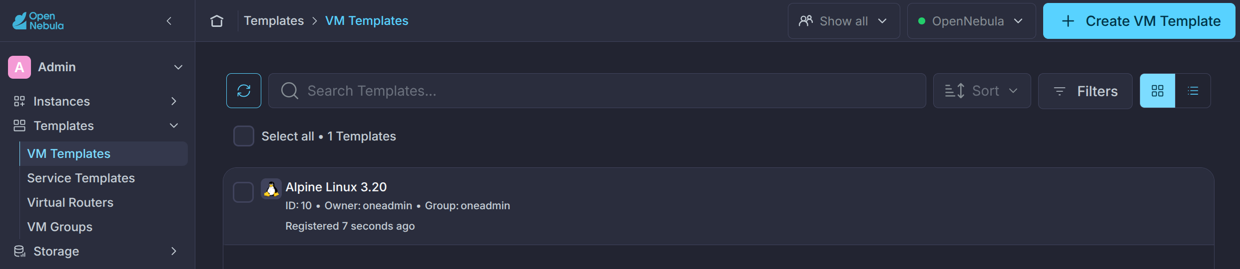

To deploy the Alpine Linux VM, in the left-hand sidebar go to Templates -> VM Templates. This screen displays a list of all VM templates installed on the system. In this case, only the Alpine Linux 3.20 template is installed:
Sunstone loginSunstone login
To instantiate the VM template, click the template item and click the Instantiate icon at the top.

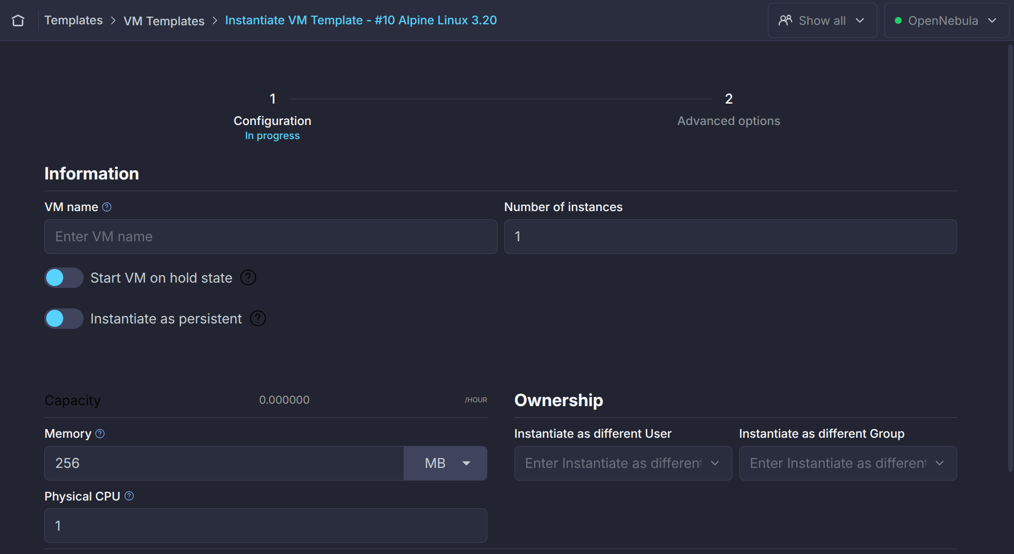

Sunstone will display the first screen of the Instantiate VM Template wizard:
Sunstone instantiate VM 1Sunstone instantiate VM 1
Leave the Capacity, Ownership and VM Group parameters with their default values. Click Next.

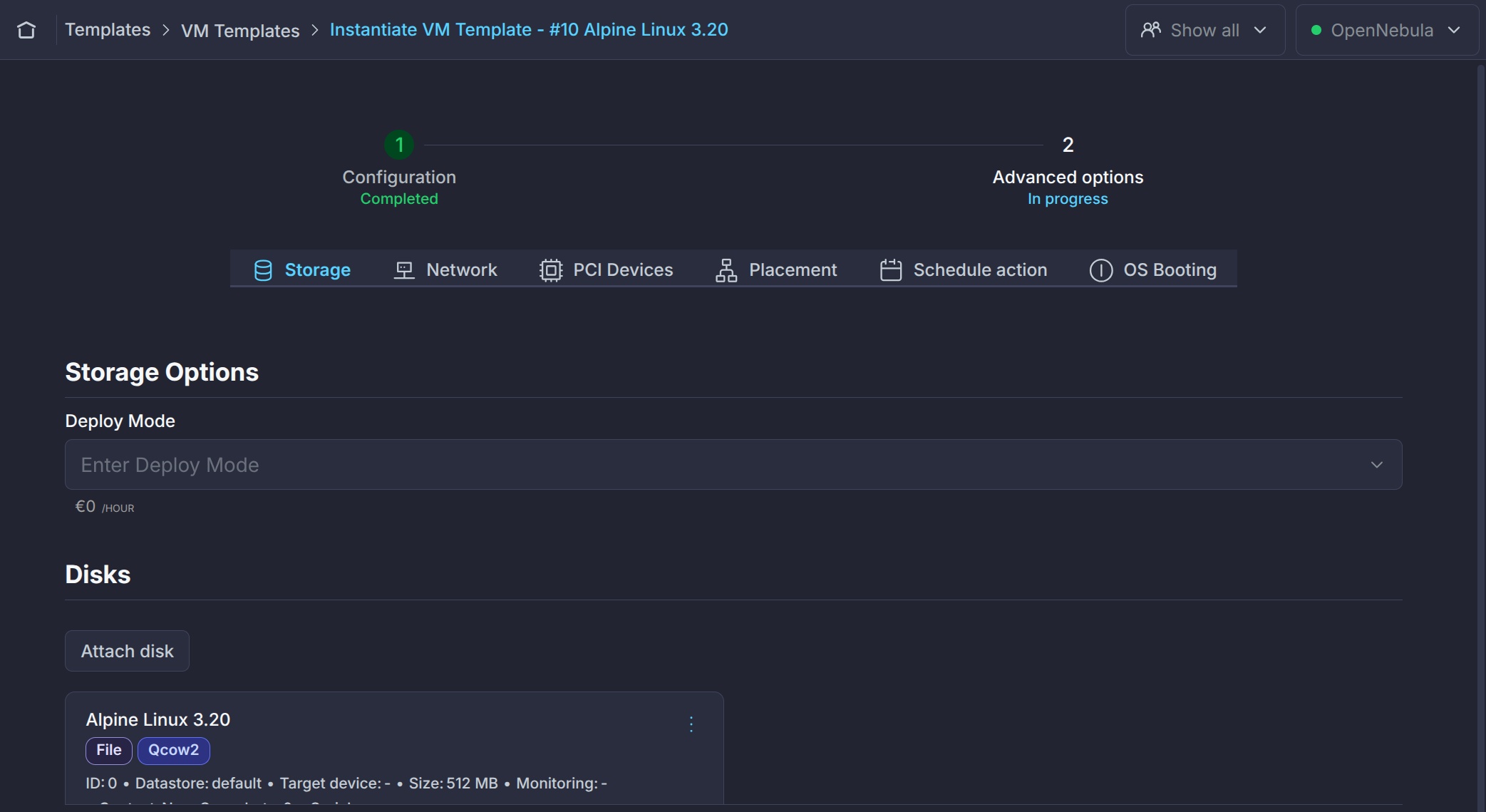

The next screen allows you to see and modify further parameters for the VM, including selecting the Virtual Network or scheduling actions.
Sunstone instantiate VM 2Sunstone instantiate VM 2
Click Finish.

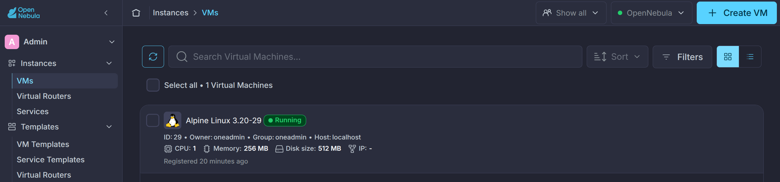

OpenNebula will instantiate the VM template. For the Alpine Linux VM, this should take just a few seconds. Once instantiation is complete, Sunstone should display the Instances -> VMs screen, with the Alpine Linux VM as the sole instance:
The green dot to the left of the VM name indicates that the VM is running. Note that you may need to click the Refresh icon at top left for the VM to display the running state.

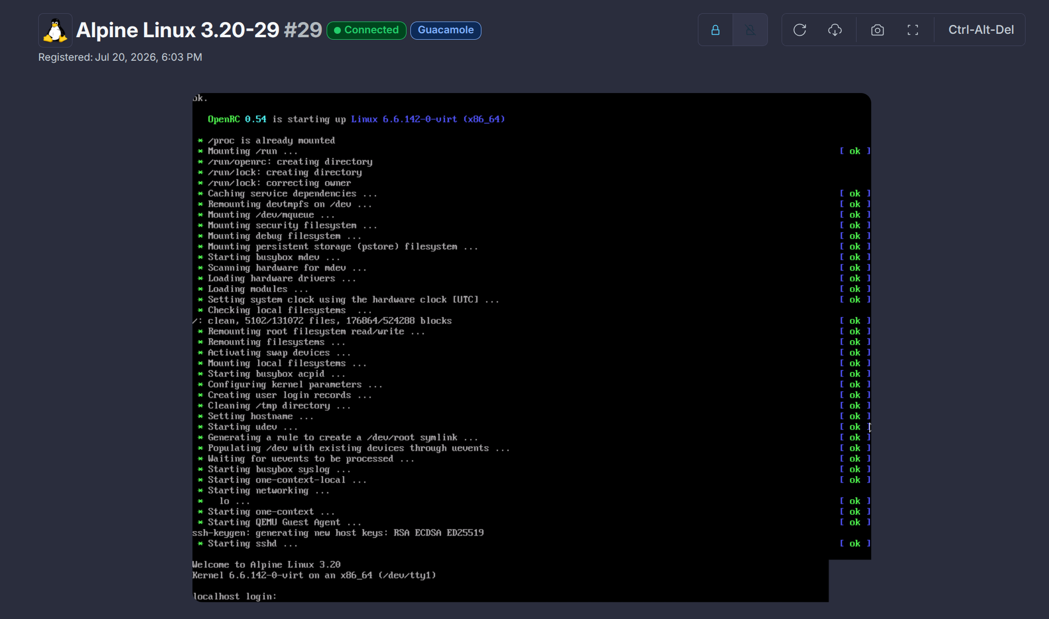

The quickest way to log into the VM is by VNC, available directly in Sunstone. Just click the VNC icon and Sunstone will display the VM boot messages screen directly in your browser in another tab.
Log in as root with password opennebula. You can then use the command line to explore the VM and run processes:
  • Try running ping 1.1.1.1 to test the internet connection
  • Try running top to see the processes running on the machine
If the above procedure works, you have successfully installed miniONE and it is ready to deploy and manage your cloud infrastructure.
