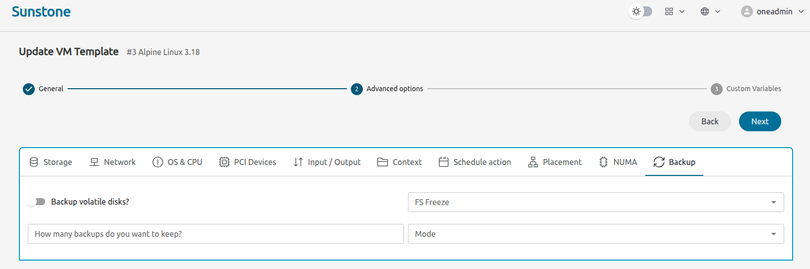

To configure using the Sunstone GUI, select the Backup tab:
VM Template Backup tabVM Template Backup tab

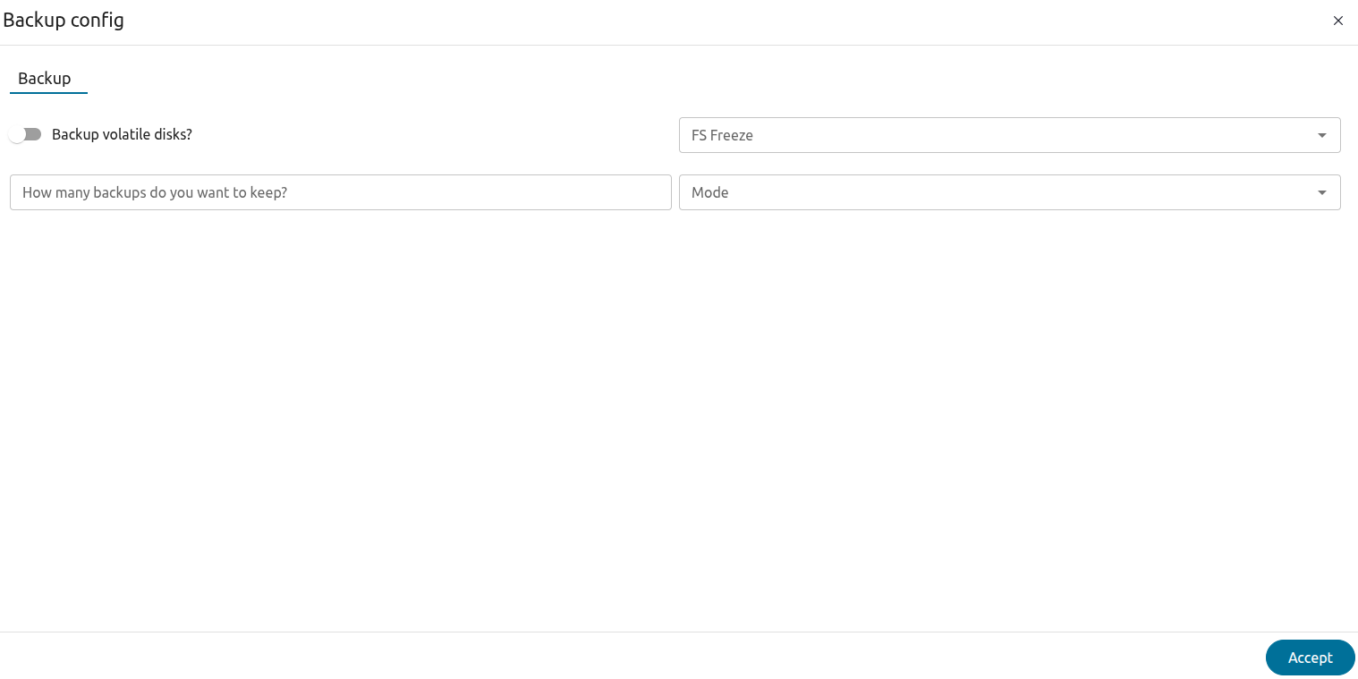

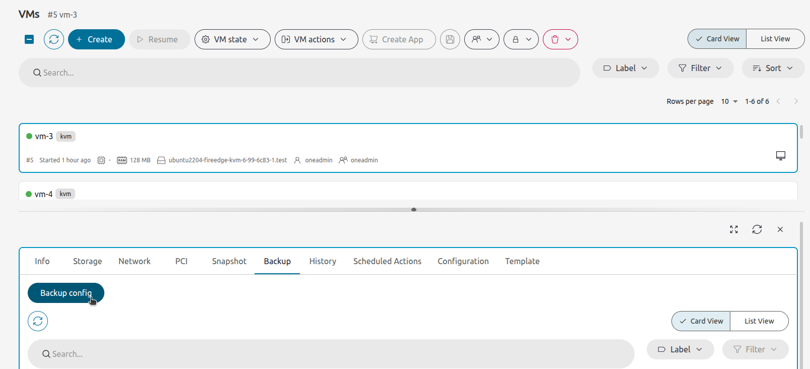

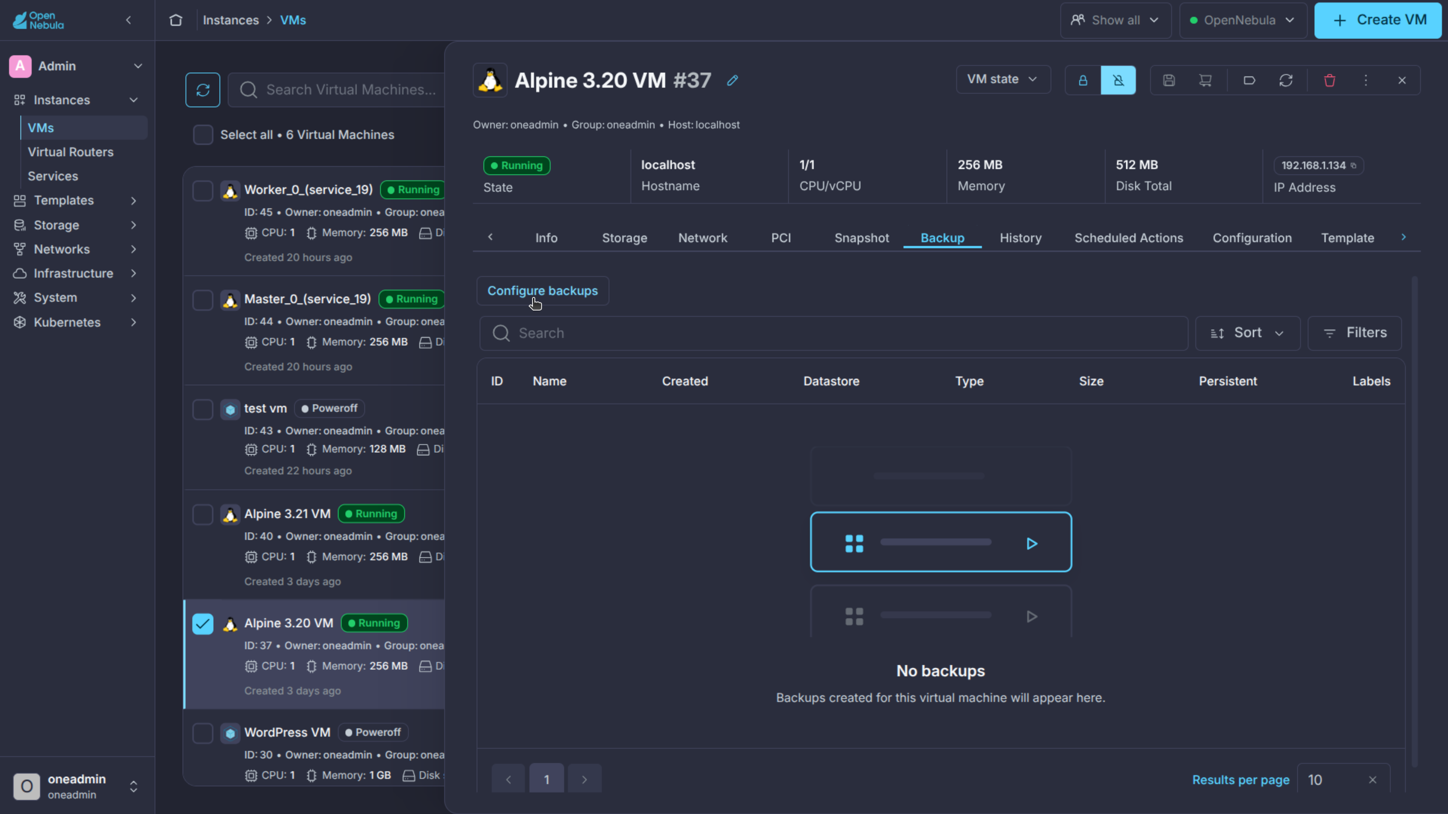

To configure using the Sunstone GUI, click on the virtual machine, select the Backup tab and click on the Backup config button:
VM Backup tabVM Backup tab

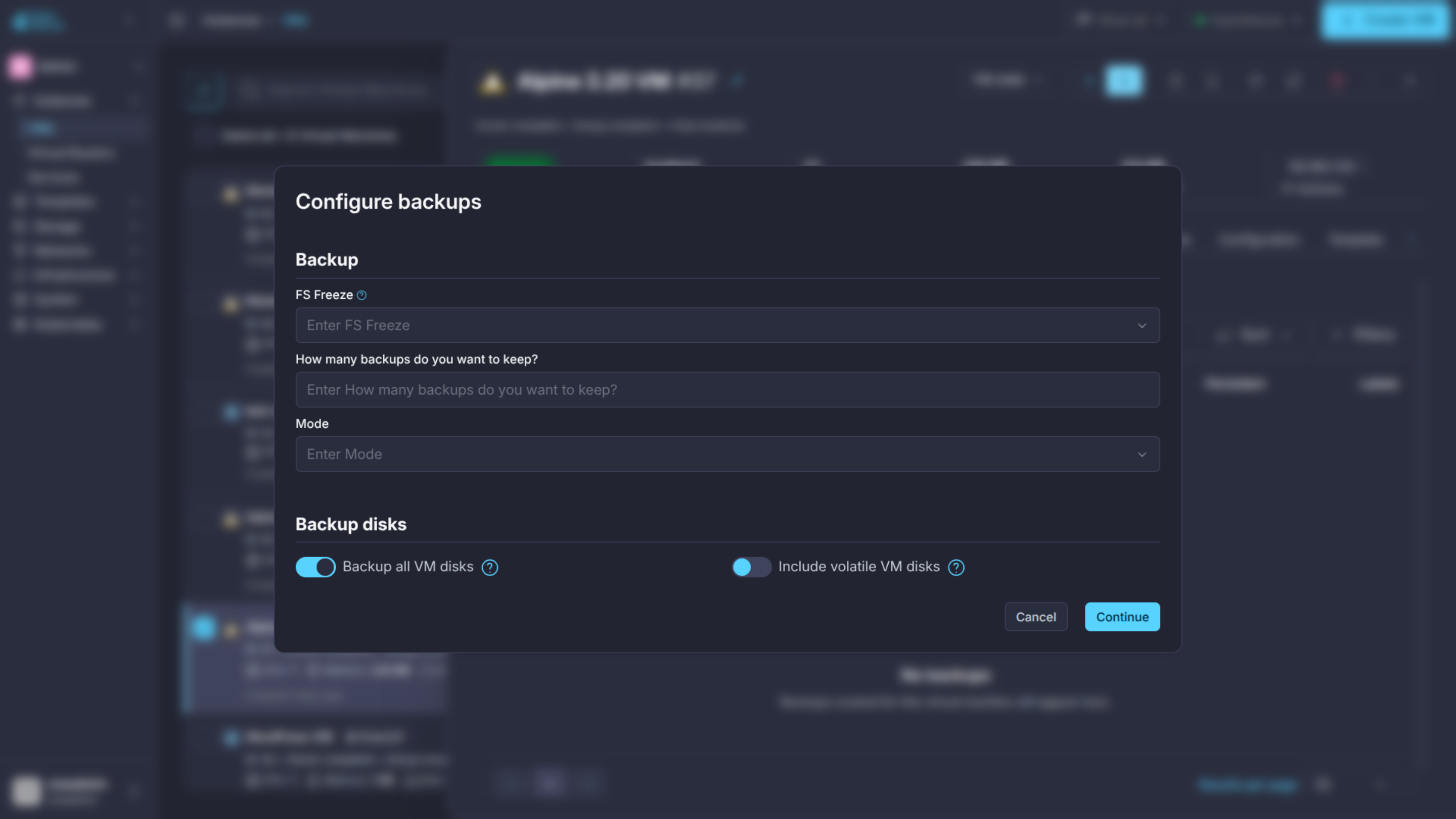

Sunstone will display the screen to update the VM Configuration.
VM Backup configurationVM Backup configuration

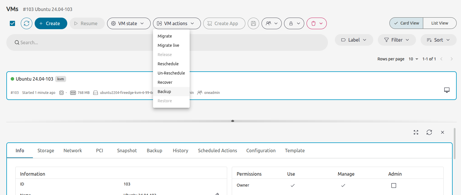

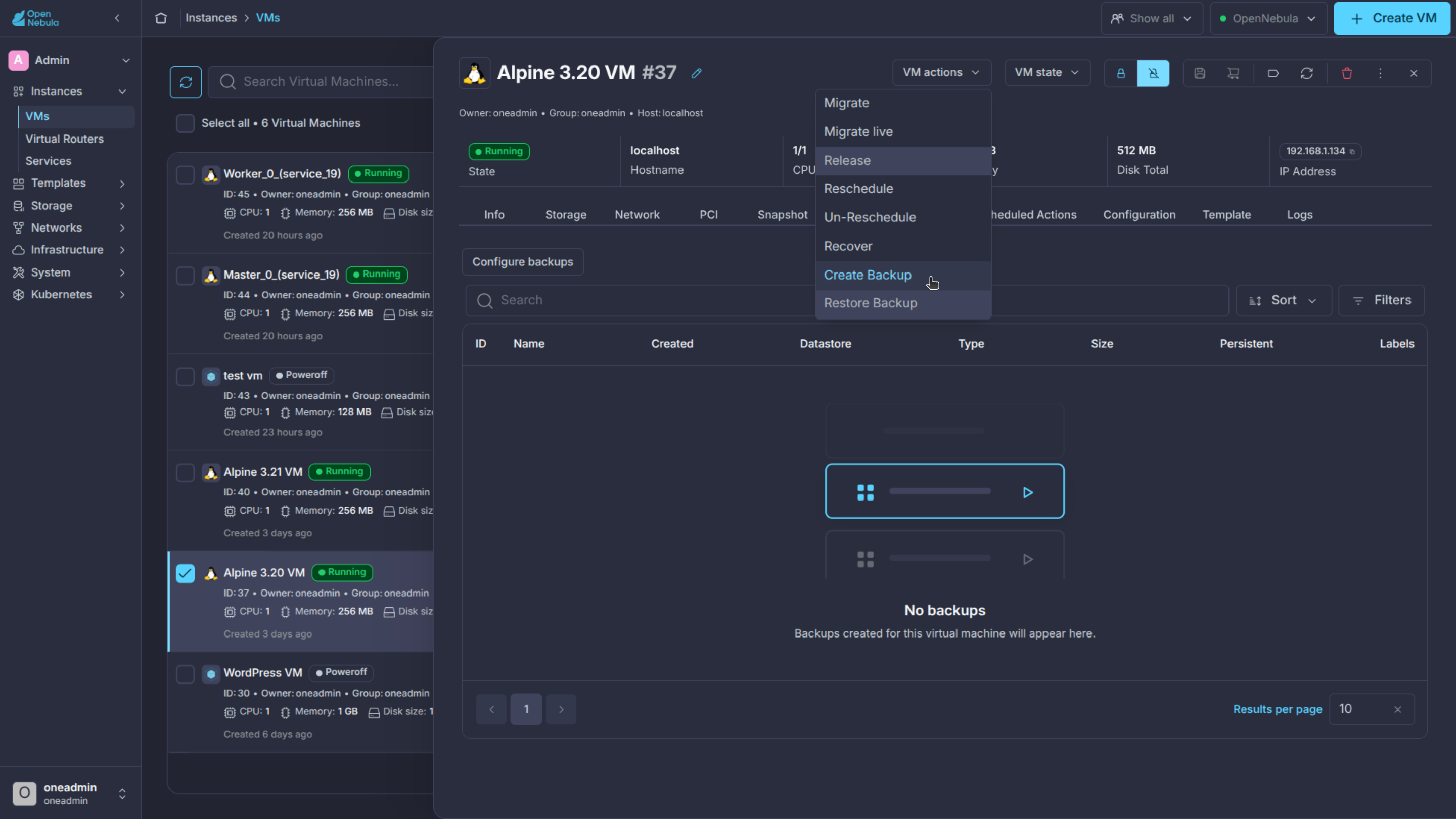

You can take backups (one-shot) using the onevm backup operation (or the equivalent Sunstone action). The backup will use the configured attributes for the VM (e.g., MODE) and two additional arguments:
  • Datastore ID: The datastore where the backup will be stored
  • Reset (optional): When doing incremental backups, you can close the current active chain and create a new one by passing this flag
Important, only the oneadmin account can initiate backups directly, regular users needs to schedule the operation. See example:
$ onevm backup --schedule now -d 100 0
VM 0: backup scheduled at 2022-12-01 13:28:44 +0000
Using Sunstone to take one-shot backup:
Create VM backupCreate VM backup

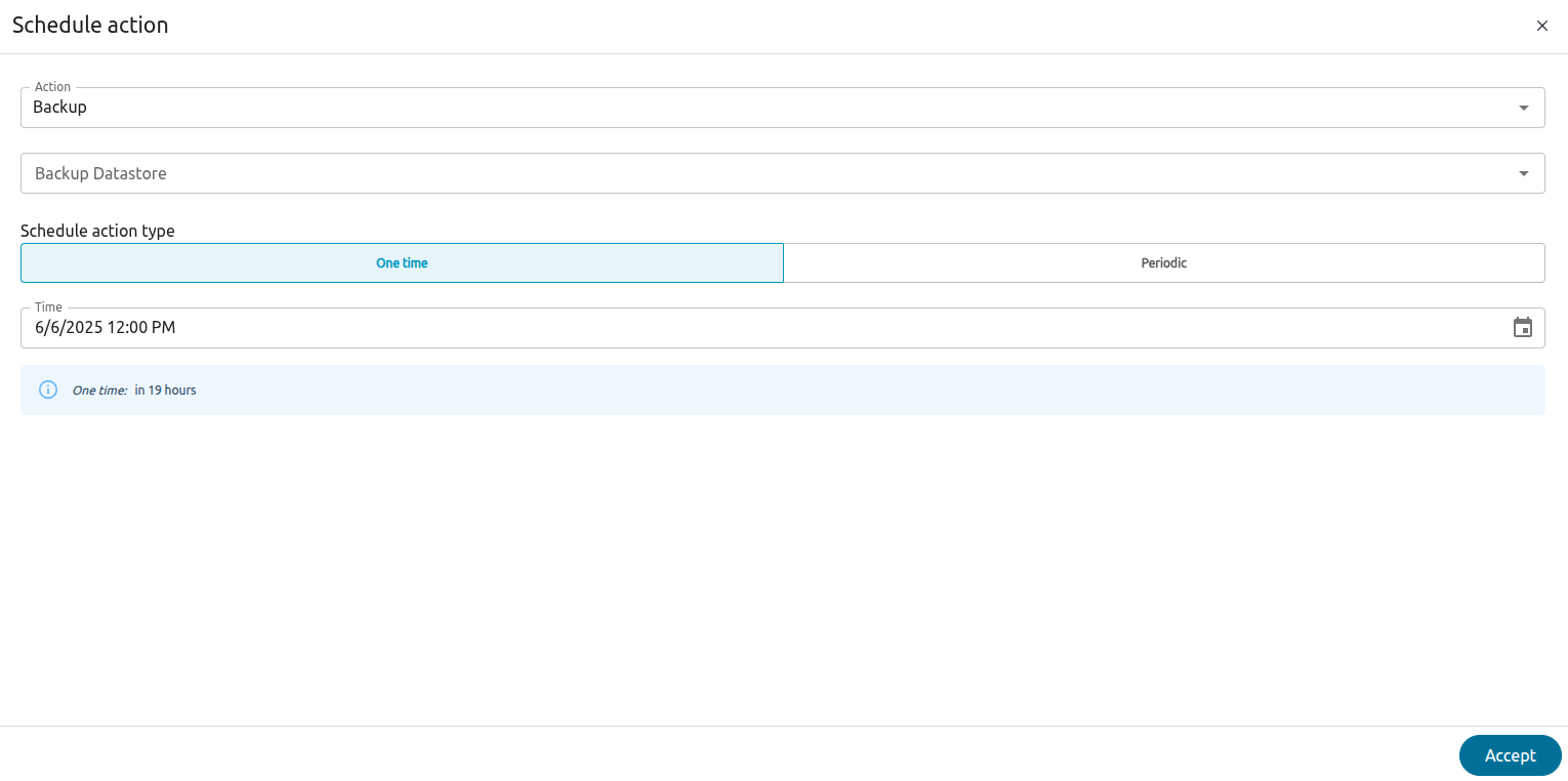

Scheduling Backups

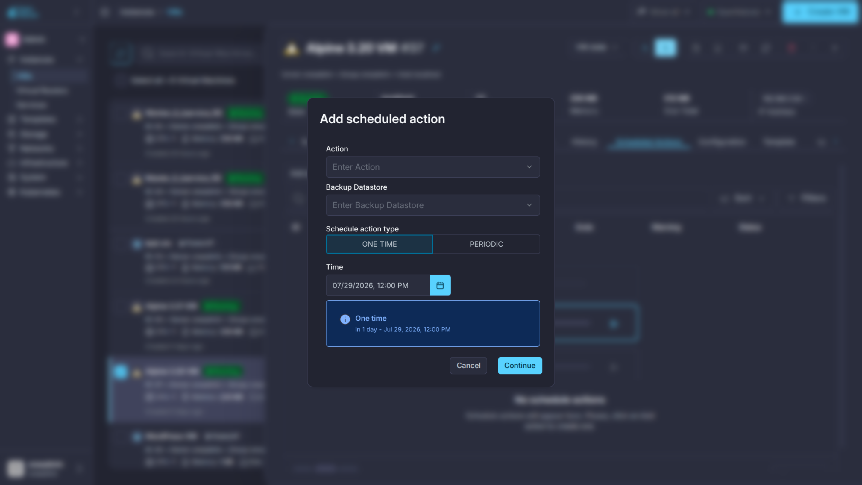

You can program periodic backups through the schedule actions interface. Note that in this case, you have to pass the target datastore ID as argument of the action. You can create a periodic backup with the --schedule option in the CLI, or through Sunstone in the Schedule Action dialog (to open the dialog, click the Sched Actions tab then click Add action).
Schedule VM backupSchedule VM backup
Note: As with any other schedule action, you can plan for several backup operations or add a pre-set backup schedule in the VM template.

Multi-tier Backup Policies (Full Backups)
If you are using FULL backups you can schedule backups in different servers (i.e., different datastores) using different schedules. For example:
  • Schedule a backup in the Datastore “in-house” every Friday.
  • Schedule a backup in the Datastore “cloud-storage” once every month.
