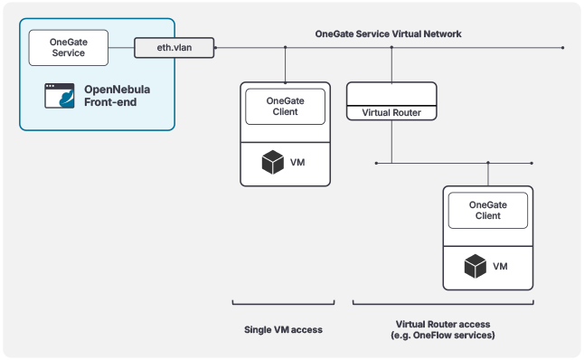

Recommended Network Setup
To use the OneGate Service, VMs must have connectivity to the service. We recommend setting up a dedicated Virtual Network, ideally on a separate VLAN, for OneGate access. To accomplish this, simply add a Virtual Network Interface (NIC) to the OneGate Service network for the VMs requiring access to the service. In cases where you’re deploying a multi-tier service, you can just add the virtual router to the OneGate Service network. The recommended network layout is illustrated in the diagram below:
