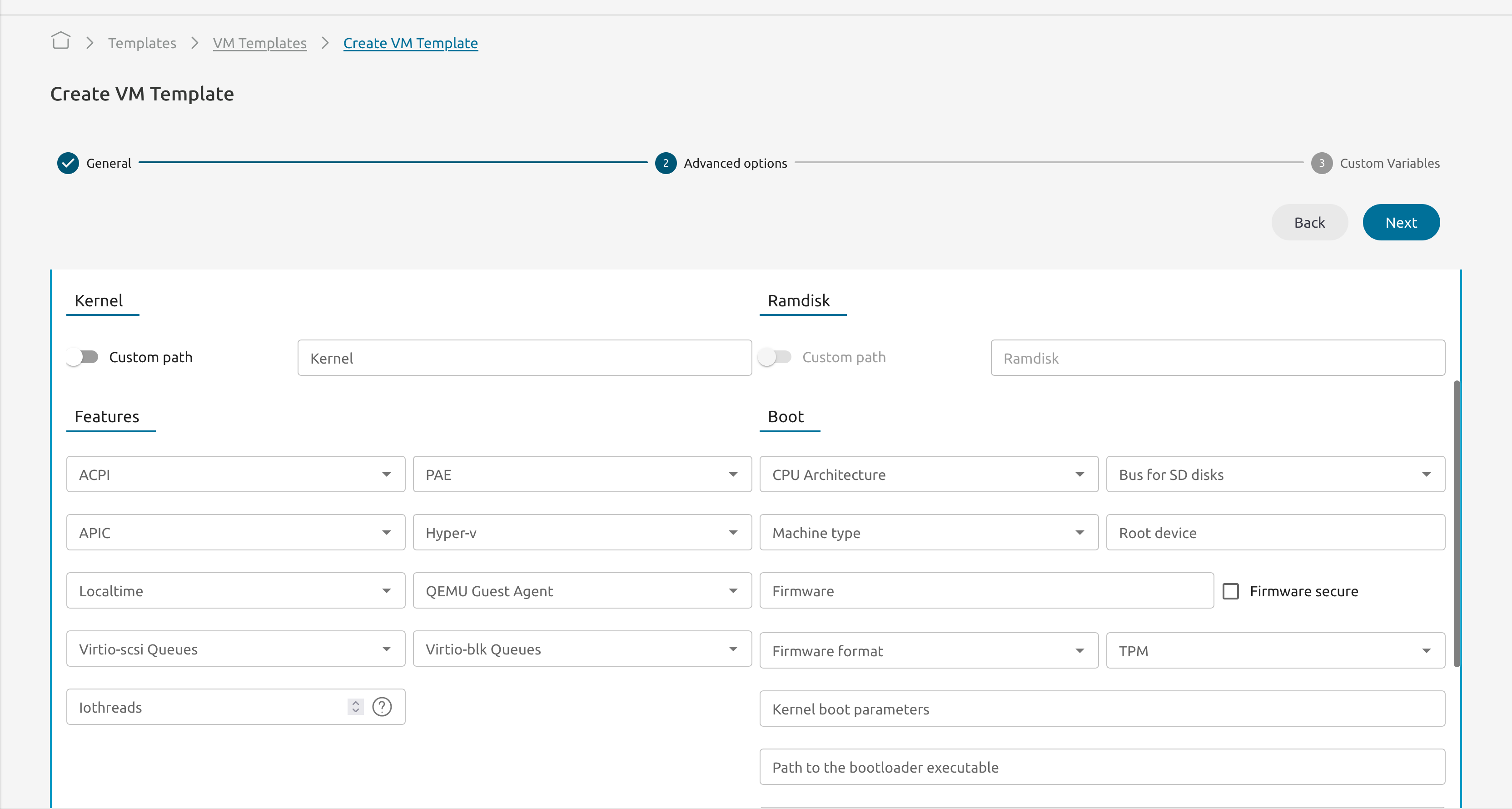

All the OS & CPU options can be accessed in Sunstone from the VM Template Update/Create dialog, in the second step (Advanced options) under the “OS & CPU” tab.
Sunstone OS and CPU tabSunstone OS and CPU tab
