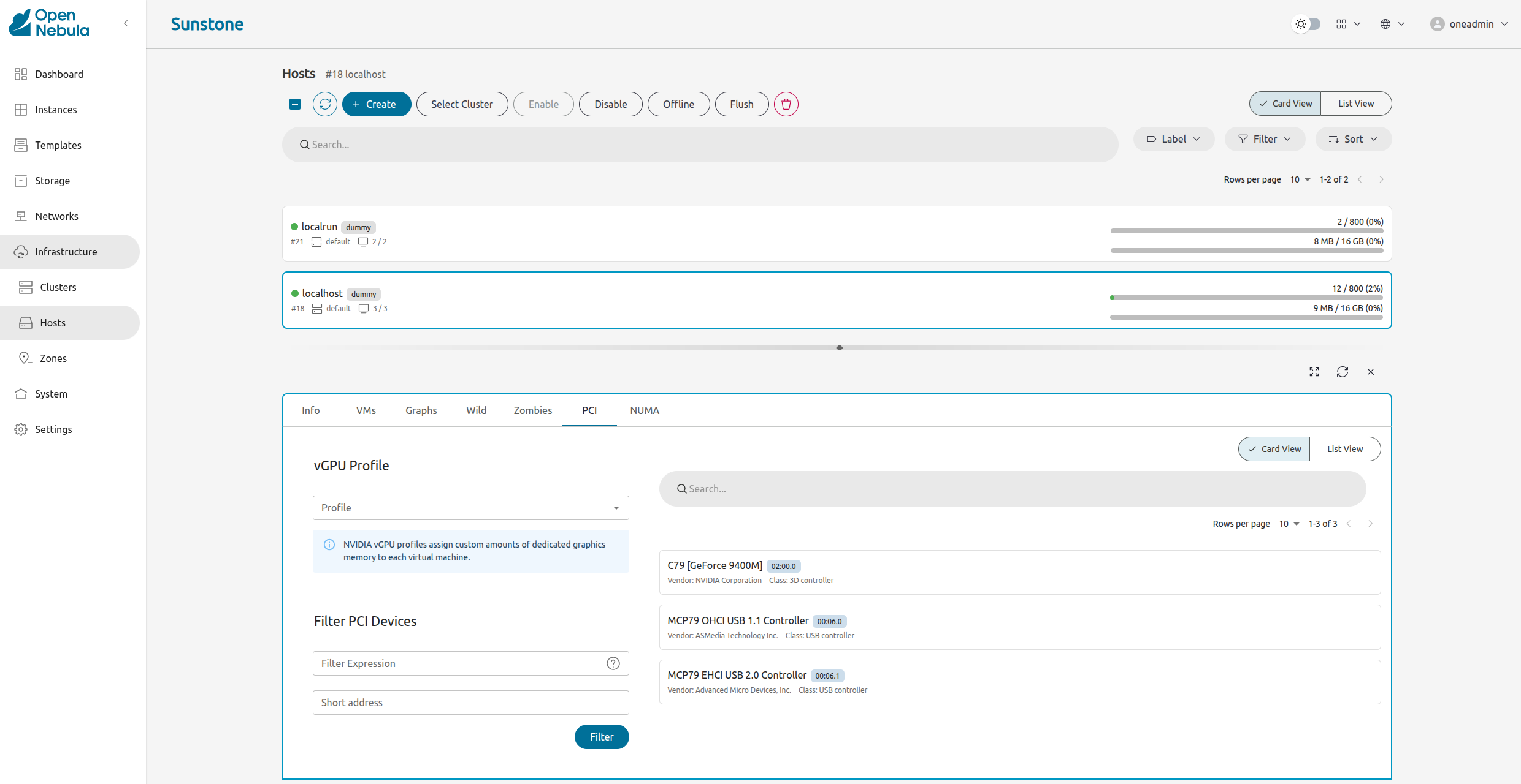

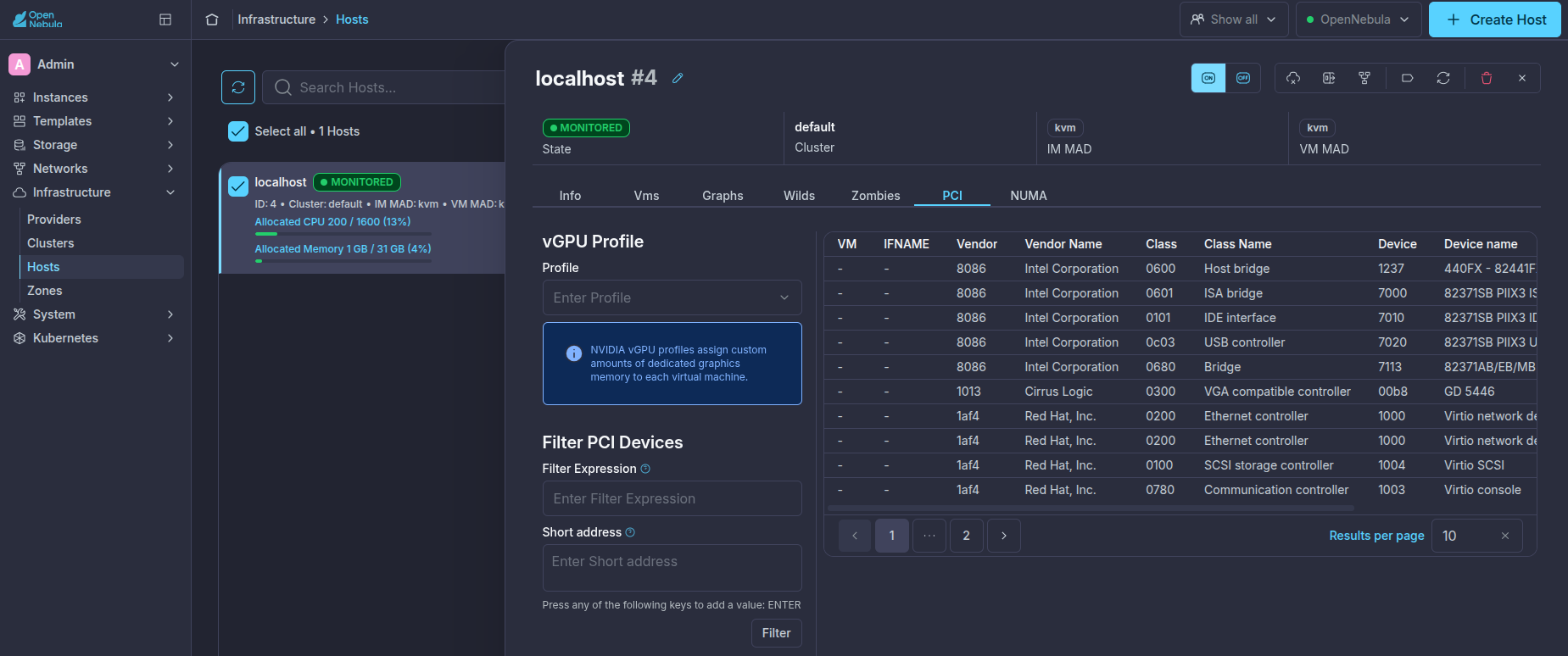

The basic workflow is to inspect the Host information, either in the CLI or in Sunstone, to find out the available PCI devices and to add the desired device to the template. PCI devices can be added by specifying VENDOR, DEVICE and CLASS, or simply CLASS. Alternatively, you can select and specific device by its address with (SHORT_ADDRESS).
Note that OpenNebula will only deploy the VM in a Host with the available PCI device. If no Hosts match, an error message will appear in the Scheduler log.
In Sunstone the information is displayed in the PCI tab of a Host:
Sunstone PCI PassthroughSunstone PCI Passthrough

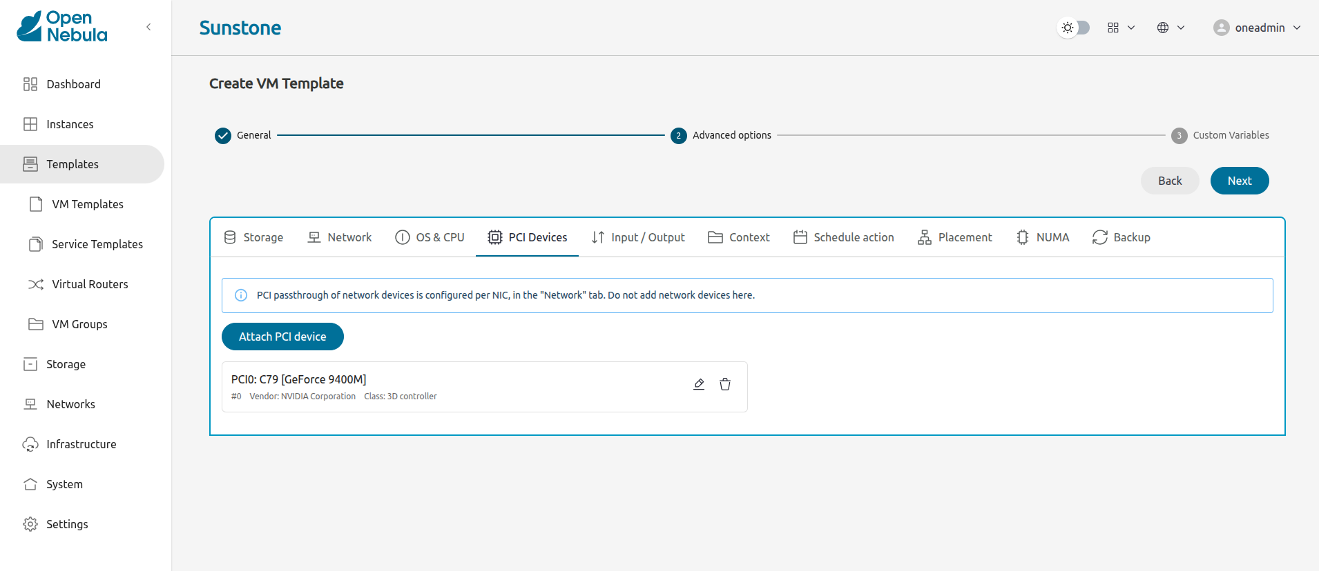

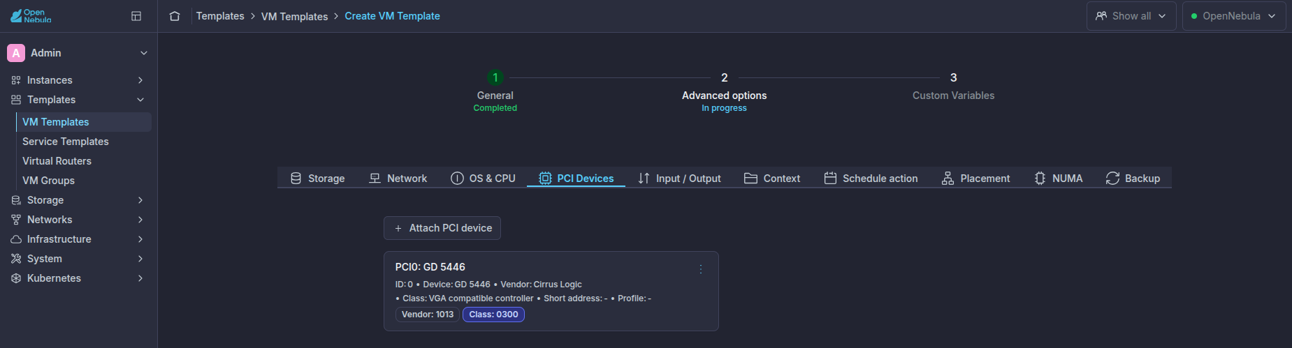

To add a PCI device to a template, select the PCI Devices tab when you are creating a Virtual Machine template:
Sunstone PCI DevicesSunstone PCI Devices

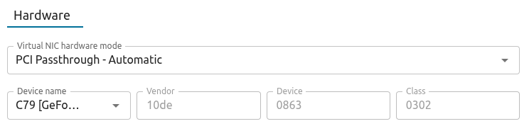

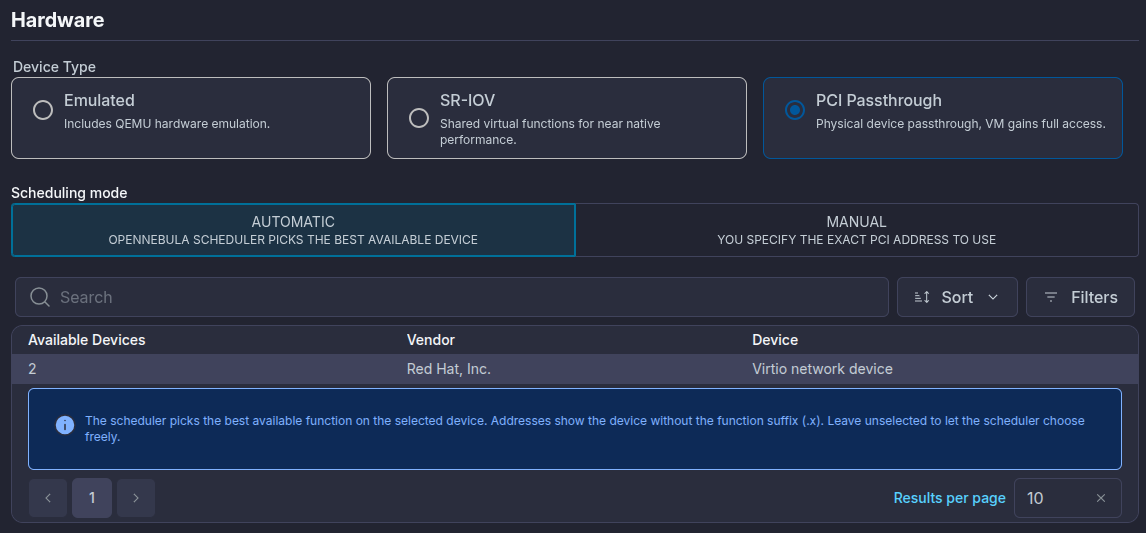

In the Network tab, under Advanced options, the hardware profile of the interface can be one of three types:
  • Emulated: It includes the hardware model emulated by Qemu.
  • PCI - Automatic: OpenNebula hardware scheduler will pick the best PCI device for the NIC.
  • PCI - Manual: User can specify the PCI device by its short-address as shown in Host information.
Use the rest of the dialog as usual by selecting a network from the table.
