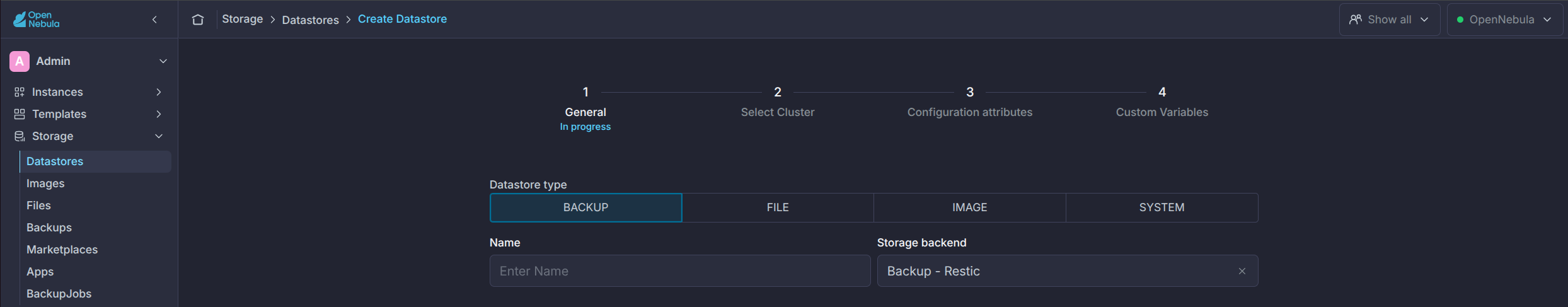

Sunstone
You can create Restic Backup Datastores for SFTP, AWS S3, and S3-compatible backends through the Sunstone interface. Go to Storage -> Datastores, click Create, select Backup as the Datastore type, and select Backup - Restic as the Storage backend:
Create Restic BackupCreate Restic Backup
In the Configuration attributes step, use Restic backend to select SFTP or S3. SFTP is selected by default. When S3 is selected, Sunstone displays the fields described in the S3 Backend Attributes section.
For AWS S3, you can leave the endpoint empty to use s3.amazonaws.com; path-style access is normally not required. For S3-compatible backends, set the endpoint explicitly and enable path-style access if required by the service.
For S3 datastores, OpenNebula does not discover the bucket quota automatically. The total capacity is taken from the TOTAL_MB datastore attribute. The examples above set TOTAL_MB="512000" to configure a custom 500G capacity. If TOTAL_MB is omitted, the driver uses 1048576 MB (1024G) as the default capacity. Used capacity is computed from backup images registered in OpenNebula.
OpenNebula creates a separate restic repository inside the SFTP path or S3 bucket for each VM or backup job.
