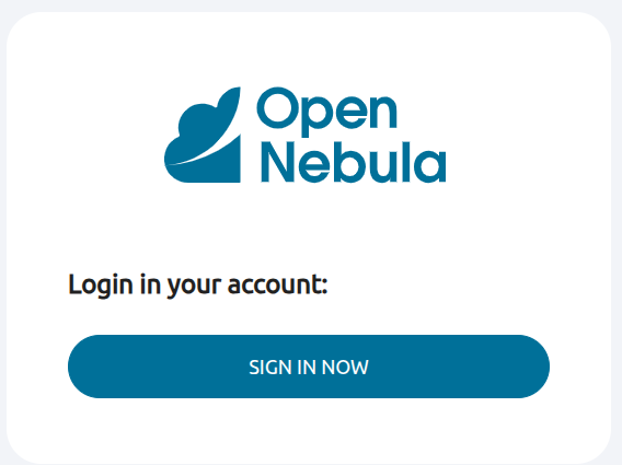

The login screen will not display the username and password fields anymore, as all information is fetched from the user certificate:
Sunstone remote login
Note that OpenNebula will not verify that the user holds a valid certificate at the time of login: this is expected to be done by the external container of the Sunstone server (normally Apache), whose job is to tell the user’s browser that the site requires a user certificate and to check that the certificate is consistently signed by the chosen Certificate Authority (CA). The setup with Apache/SAML is the more common and tested. However, it can rely on Apache/Nginx for OIDC.

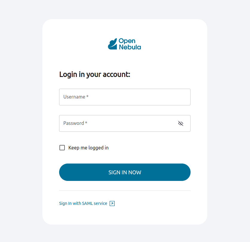

To enable the link at the bottom of the Fireedge login, you must configure :auth_redirect: <SAML_LOGIN_ENDPOINT> and restart Fireedge. Example: if using Keycloak as a SAML service, the URL must have this pattern:
:auth_redirect: ‘http://<URL_SAML_SERVICE>/realms/<REALM>/protocol/saml/clients/<CLIENT>’
In case that the redirection is invalid, please check the Master SAML Processing URL on your provider (should be similar to http(s)://<FIREEDGE_SERVER>/fireedge/api/auth/acs)

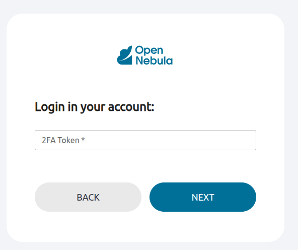

You can get an additional authentication level by using a two-factor authentication that not only requests the username and password but also the one-time (or pre-generated security) keys generated by an authenticator application.

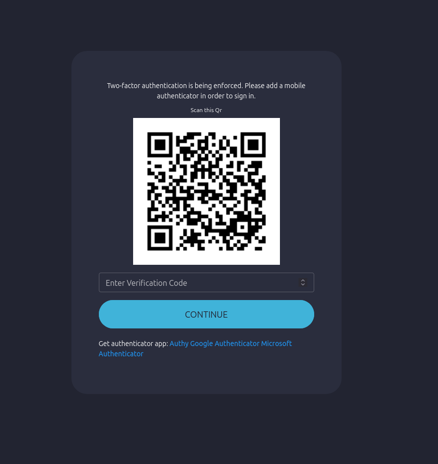

Attempting to log in without a TFA authenticator set will present the following screen, prompting the user to add one.
Sunstone 2FA enforce

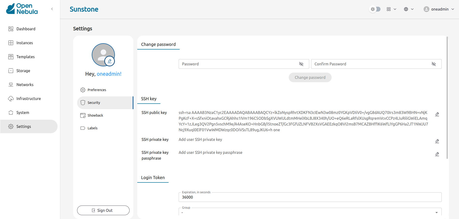

  • Log in to Sunstone and select menu Profile Settings from the dropdown menu at the lower left corner. Find the section named Two Factor Authentication.
  • In this section, find and select the button Register Authenticator App.

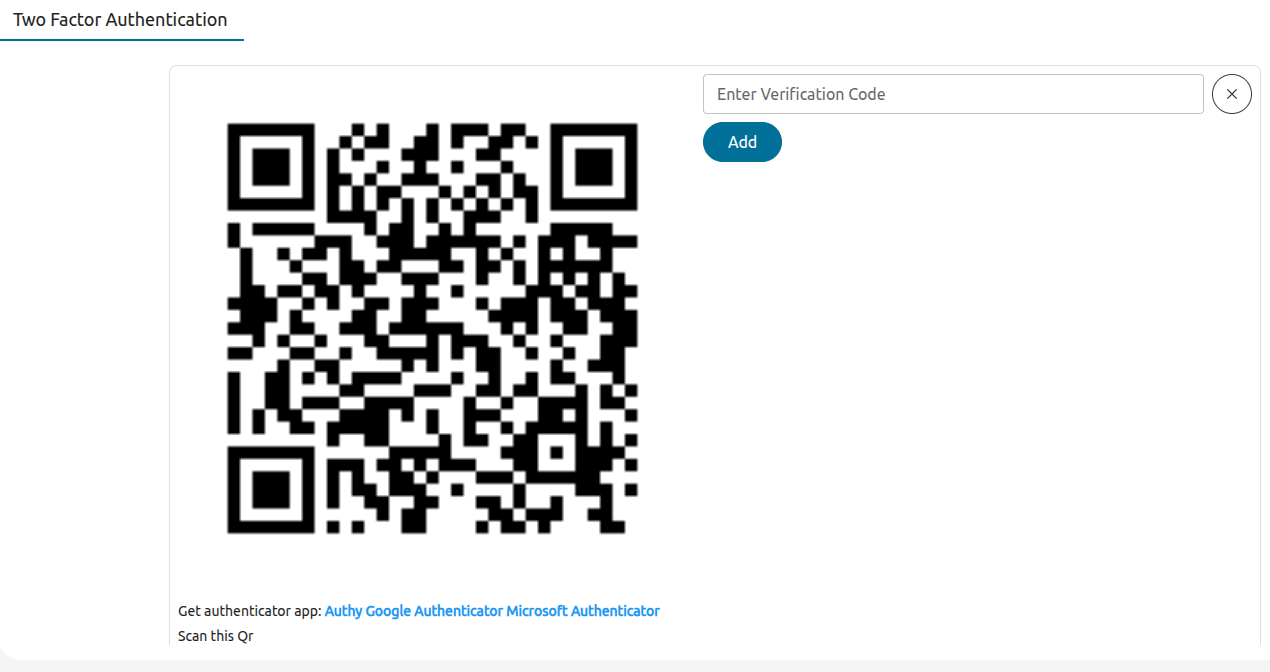

  • Scan the Qr code with the aforementioned apps and enter the verification code.
Sunstone 2FA register app

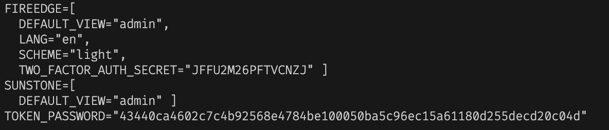

Internally Sunstone adds the field TWO_FACTOR_AUTH_SECRET.
Sunstone 2FA auth secret
