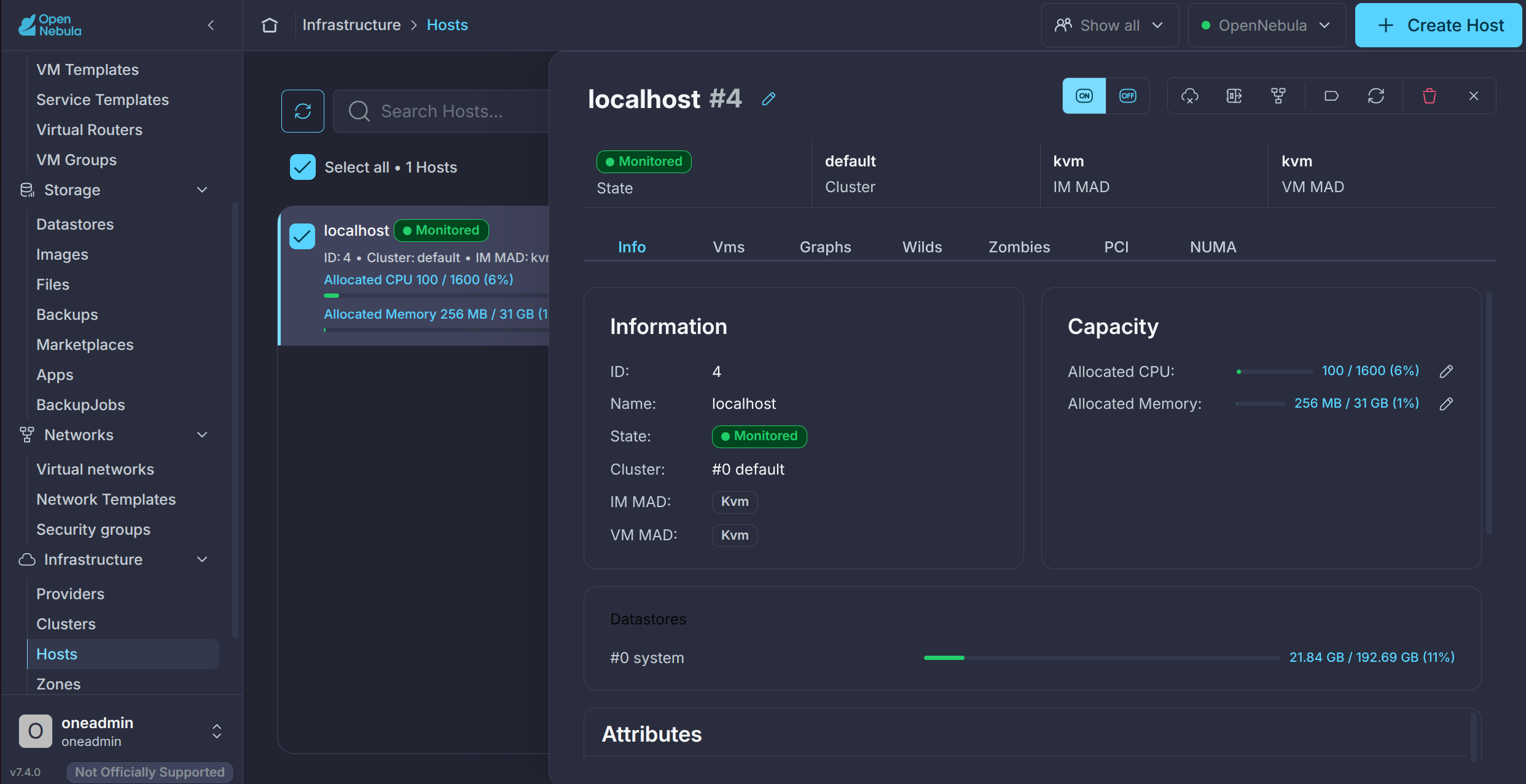

Hosts
A Host is any entity that is capable of running a VM or a container. Besides running them, it retrieves all monitoring information. A Host has two important attributes:
  • VM_MAD: the virtualization technology used on the Host.
  • IM_MAD: the driver that retrieves all monitoring metrics from the Host.
As mentioned above, miniONE installs a KVM Host and following the ISO deployment the KVM Host is added in onefemenu.
The screenshot below displays the information about the Host. The important information here is:
  • The State of the Host: MONITORED indicates that the Host is currently being monitored.
  • The Attributes section displays the monitoring metrics.
  • The tabs to the right of the Info tab display additional information, such as the VMs running on the Host.
Sunstone KVM HostSunstone KVM Host
The basic operations you can perform on the Host are:
  • Offline: take the Host totally offline.
  • Disable: disable the Host, for example to perform maintenance operations.
  • Enable: enable the Host, so that OpenNebula monitors it and it switches back to MONITORED state.
For a complete overview of Hosts management, see Hosts.

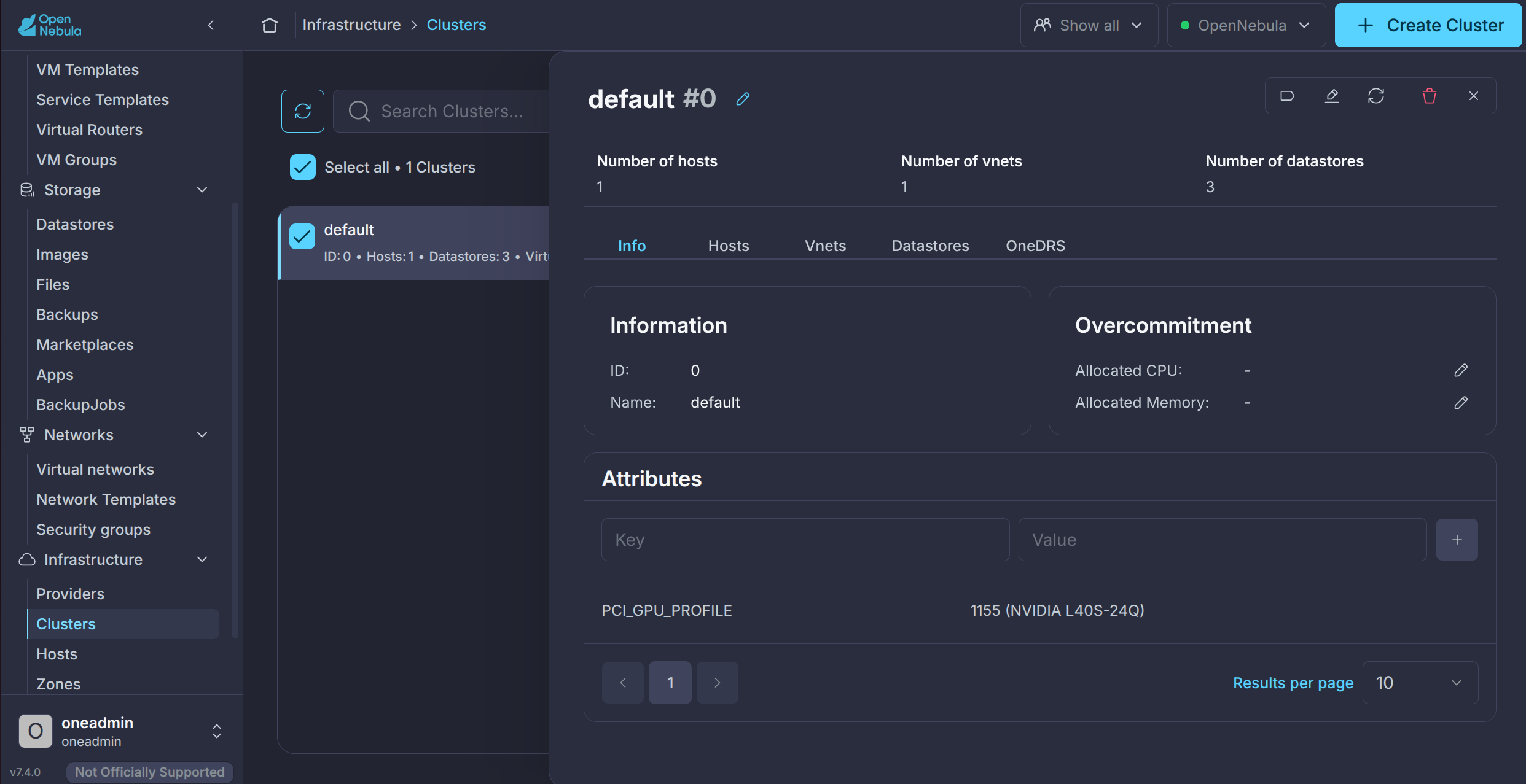

Cluster
A Cluster is the main object that groups all the physical resources and ensures that everything works correctly in terms of scheduling and the resources required. In this very simple scenario the Cluster includes only the local KVM Host, the Virtual Network, and datastores.
Sunstone ClustersSunstone Clusters
For a complete overview of Cluster management, see Clusters.

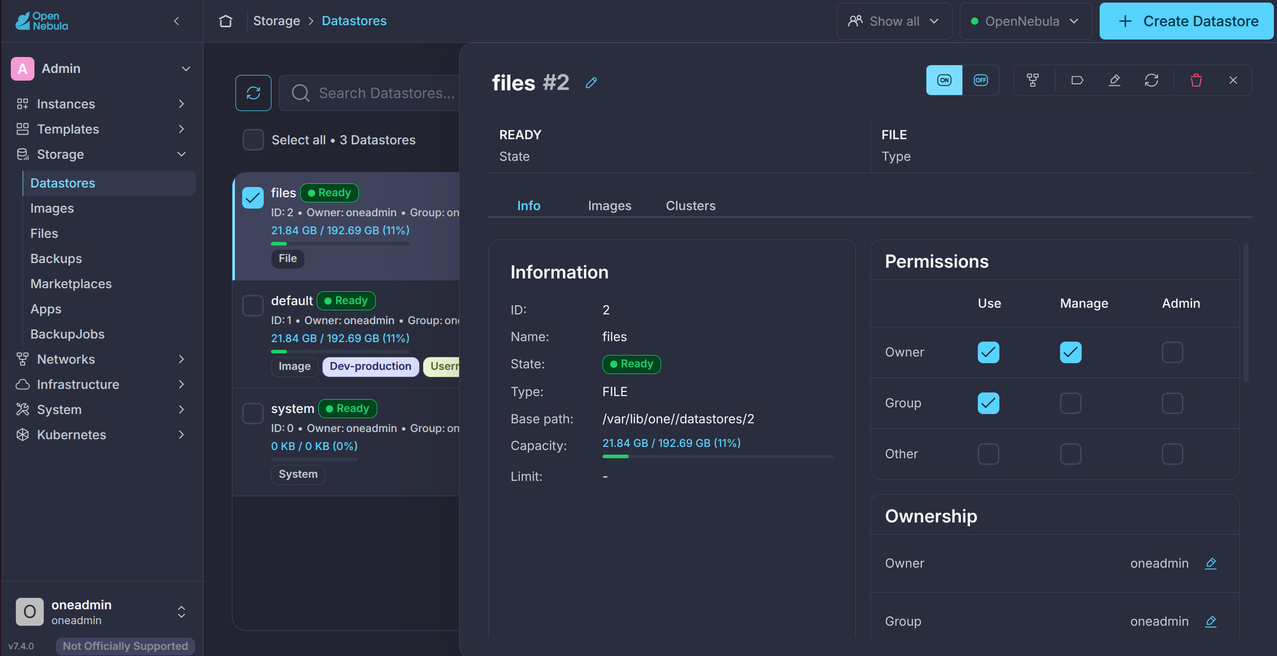

Datastores
There are three types of datastores:
  • System: contains the information of running VMs, such as disks or context CD-ROM.
  • Image: stores the images in your cloud.
  • Files: Stores plain files used in contextualization or VM kernels used by some hypervisors.
In the on-prem Cluster the default datastore is the Image datastore.
Sunstone DatastoresSunstone Datastores
For a complete overview of Datastore management, see Datastores.

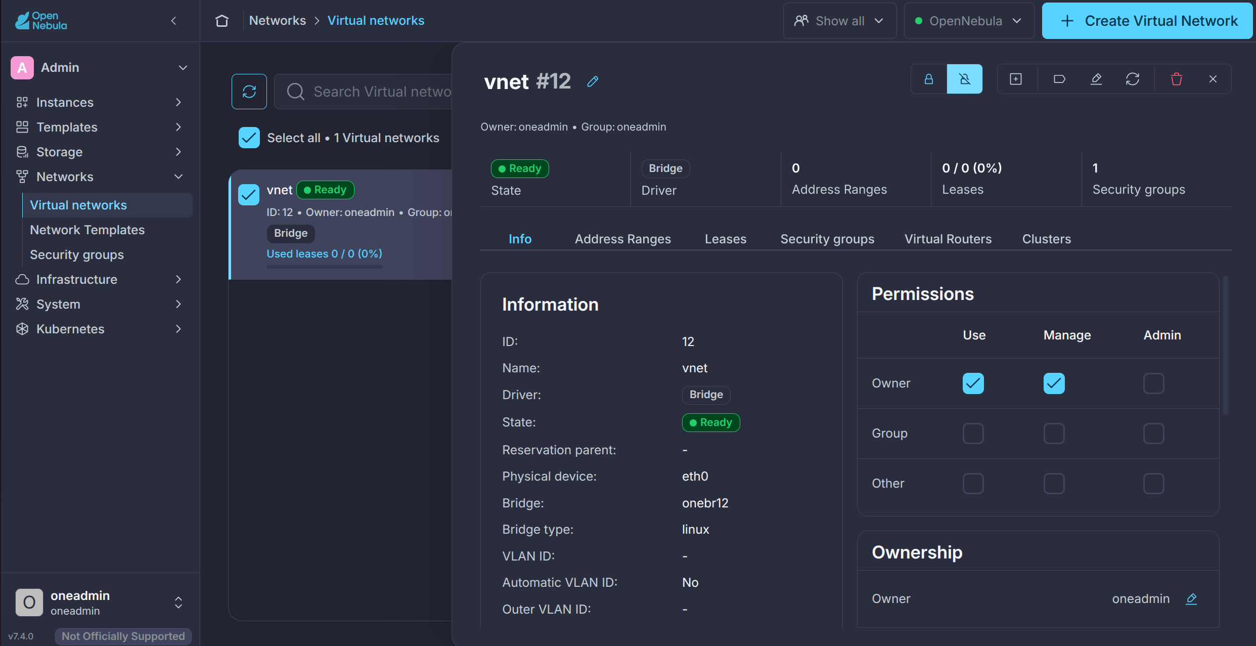

Virtual Networks
A Virtual Network in OpenNebula basically resembles the physical network in the data center. Virtual Networks allow VMs to have connectivity between them and with the rest of the world. The default miniONE installation creates a private network, by default called vnet with a base address of 172.16.100.1, with access to public networks via NAT. In the ISO deployment, this network is created manually and the gateway and the NAT must be configured.
Sunstone Virtual NetworksSunstone Virtual Networks
For a complete overview, see Virtual Network Templates.

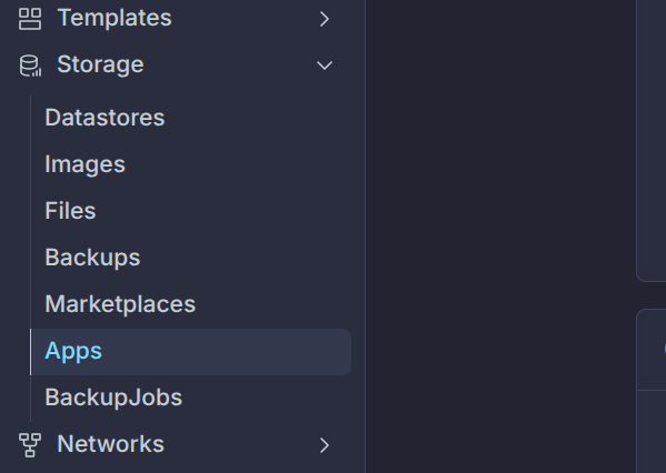

To access the Marketplace, first log in to Sunstone on your OpenNebula Front-end, as user oneadmin.
Open the left-hand pane (by hovering the mouse over the icons on the left), then select Storage, then Apps:
Sunstone AppsSunstone Apps

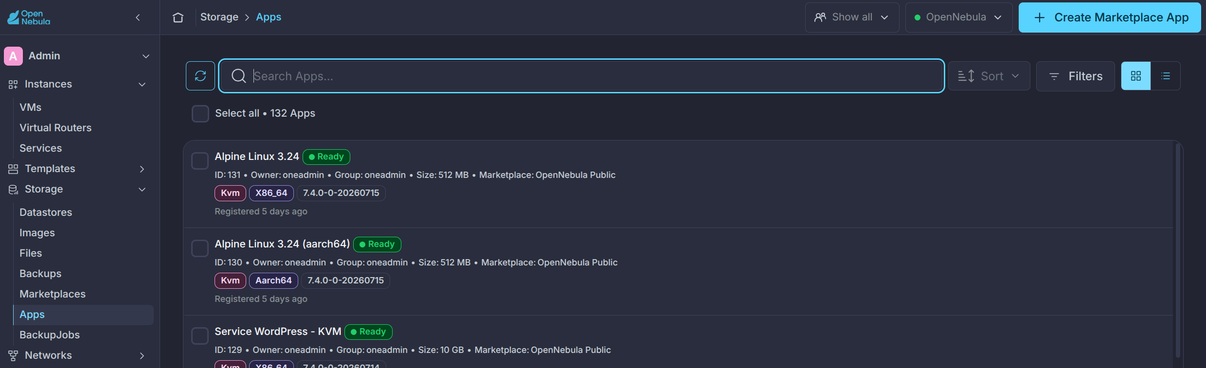

Sunstone will display the Apps screen, showing the first page of apps that are available for download:
Sunstone Apps ListSunstone Apps List

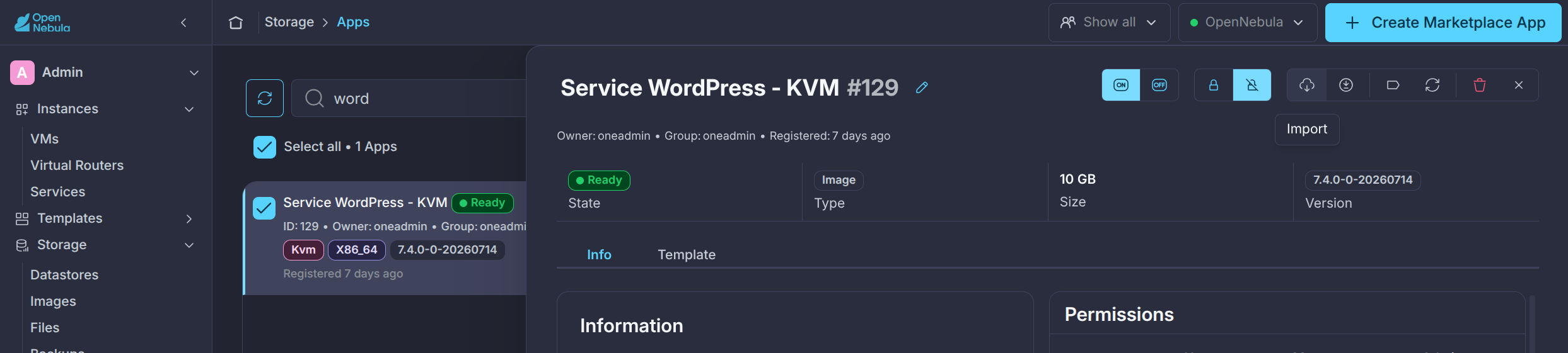

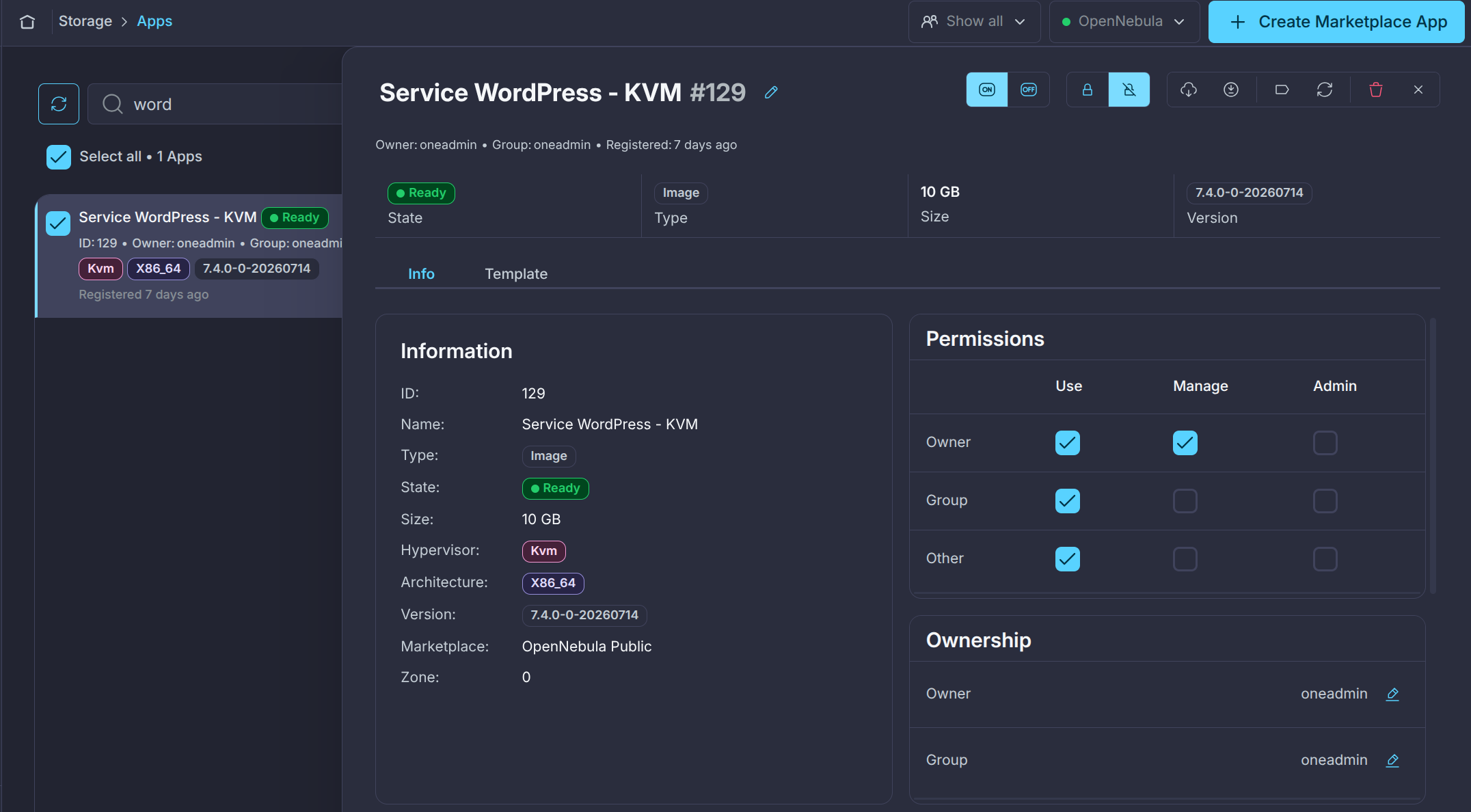

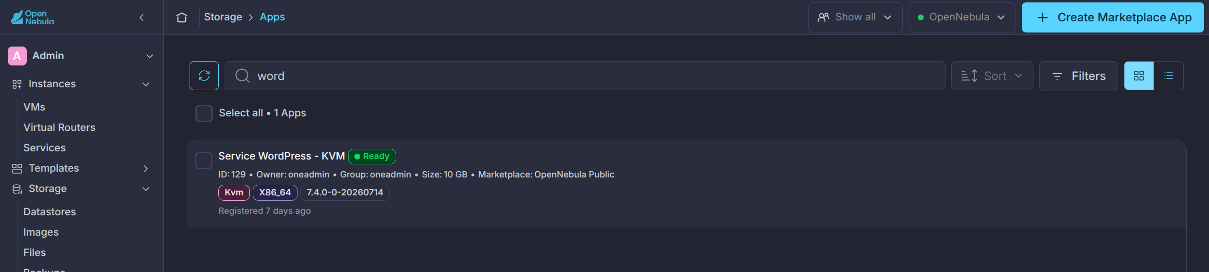

Search for the app called Service WordPress - KVM. If it’s not on the list, type wordpress in the search field at the top to filter by name:
Sunstone Apps WordpressSunstone Apps Wordpress
Click Service WordPress - KVM to select it, then click the Import into Datastore icon1 icon:
Sunstone Import WordpressSunstone Import Wordpress

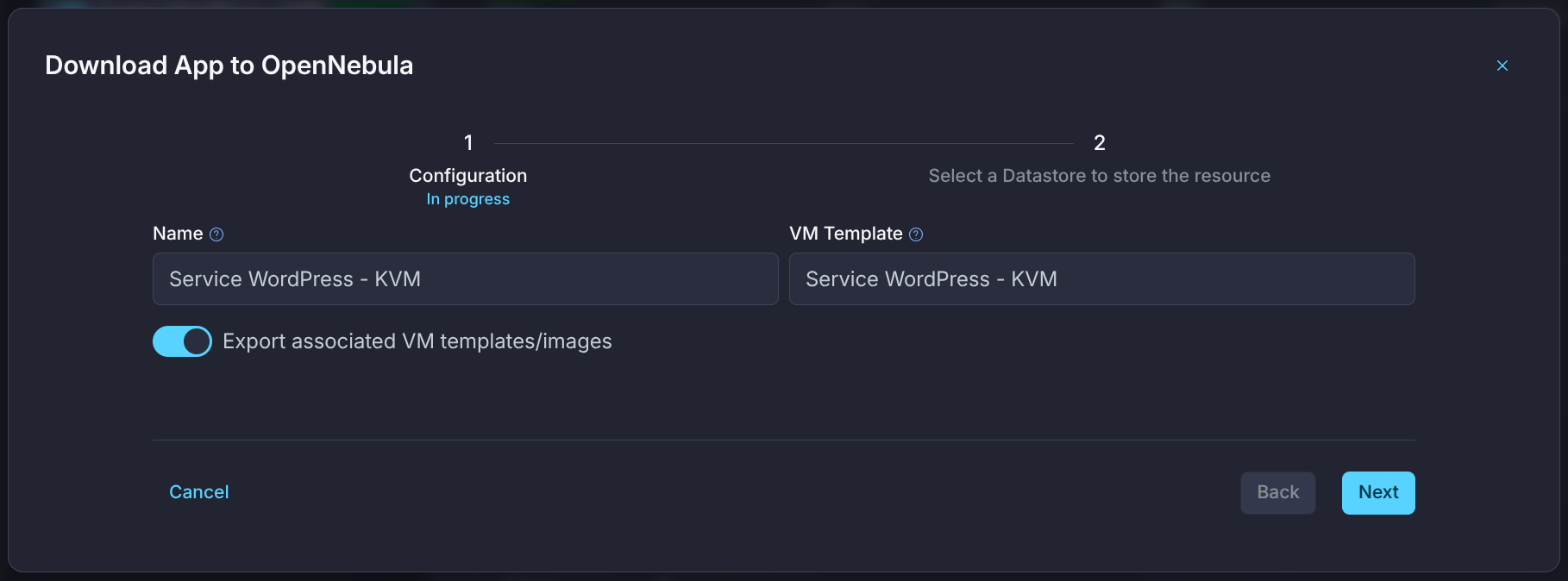

Sunstone will display the Download App to OpenNebula dialog:
Sunstone Download Wordpress AppSunstone Download Wordpress App

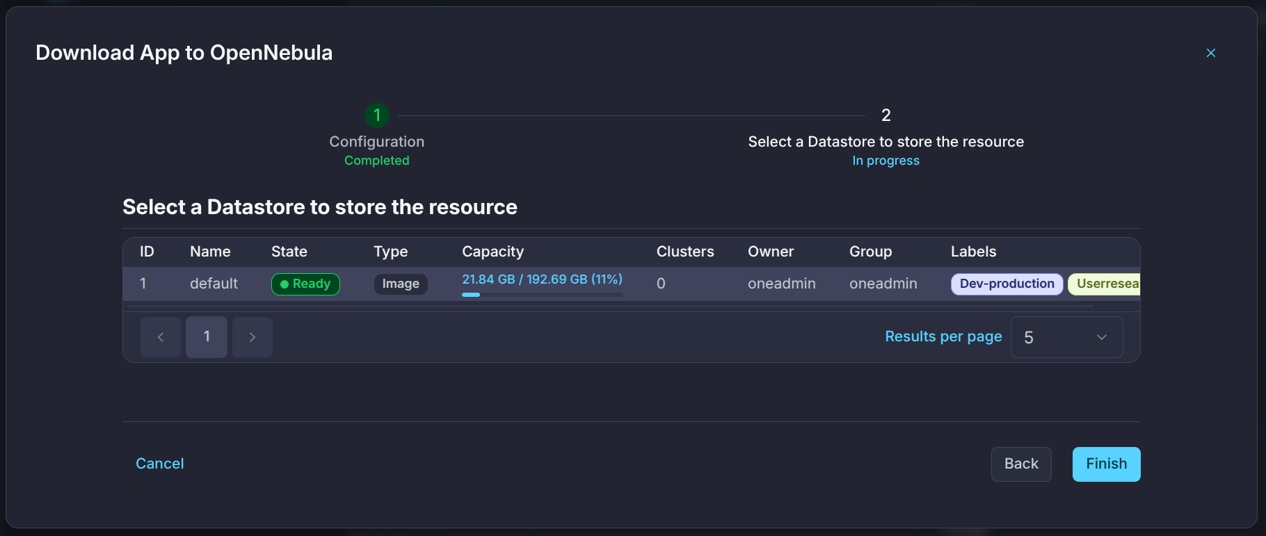

Click Next. The next screen prompts us to select a datastore, which in this case is the default Image datastore installed locally:
Click Finish. Sunstone will download the appliance template and display basic information for the appliance, shown below in the Info tab:
Sunstone Imported Wordpress AppSunstone Imported Wordpress App
Wait for the appliance State to indicate READY. When it does, the VM will be ready to be instantiated.

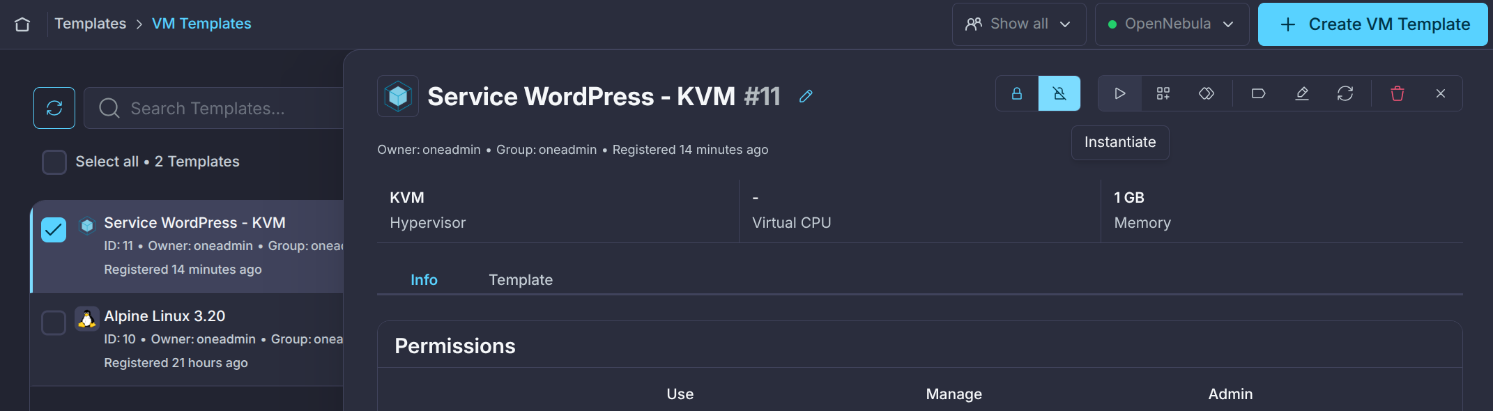

Step 2. Instantiate the VM
The Wordpress appliance VM was imported as a Virtual Machine template. To instantiate, follow these steps:

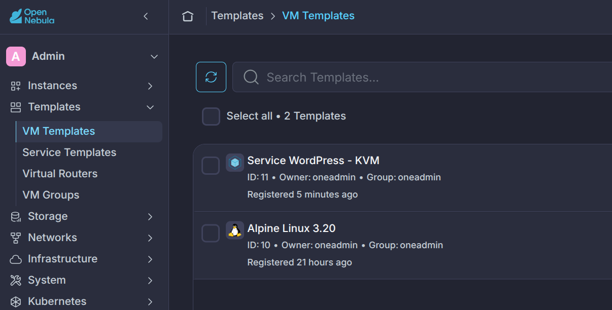

In the left-hand pane click Templates, then VM Templates:
Sunstone VM TemplatesSunstone VM Templates
Select Service WordPress - KVM, then click the Instantiate icon2 icon at the top:
Sunstone VM InstantiateSunstone VM Instantiate

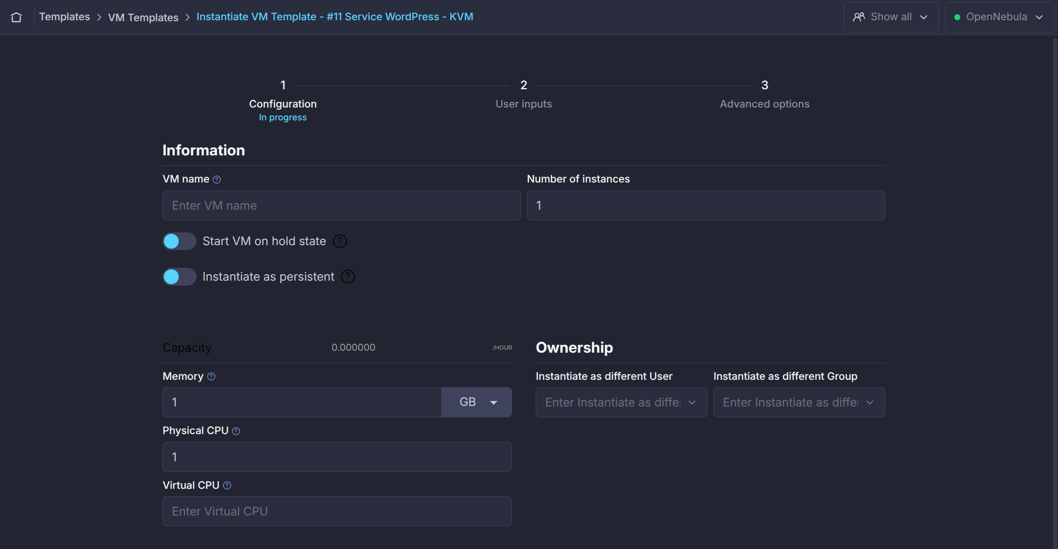

Sunstone will display the first screen of the Instantiate VM Template wizard:
Sunstone VM Instantiate Wizard 1Sunstone VM Instantiate Wizard 1
Feel free to modify the VM’s capacity according to your requirements, or leave the default values.

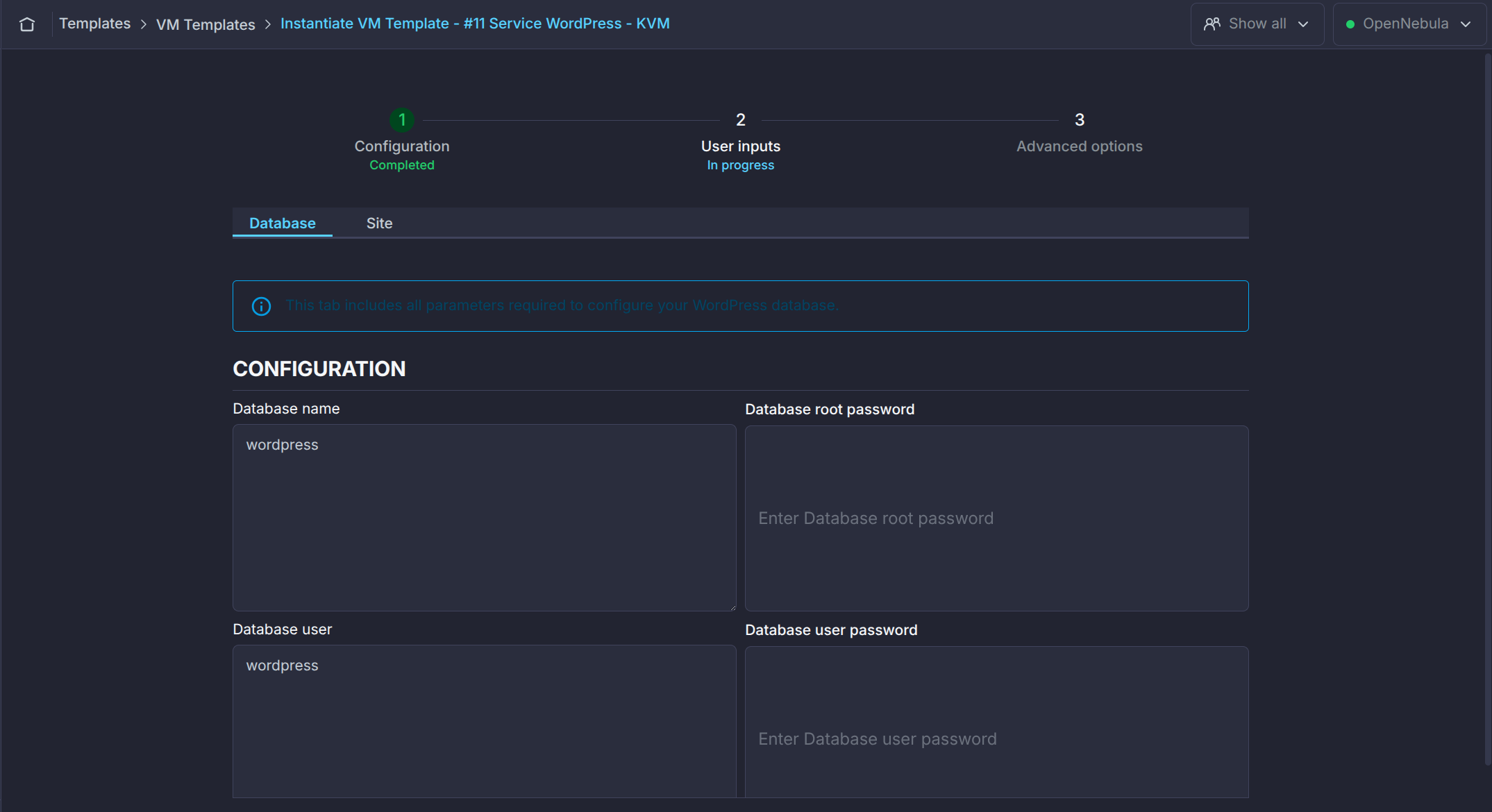

Click Next. Sunstone displays the User Inputs screen, where you can modify parameters such as the security credentials for the site administrator, or SSL certificates:
Sunstone VM Instantiate Wizard 2Sunstone VM Instantiate Wizard 2

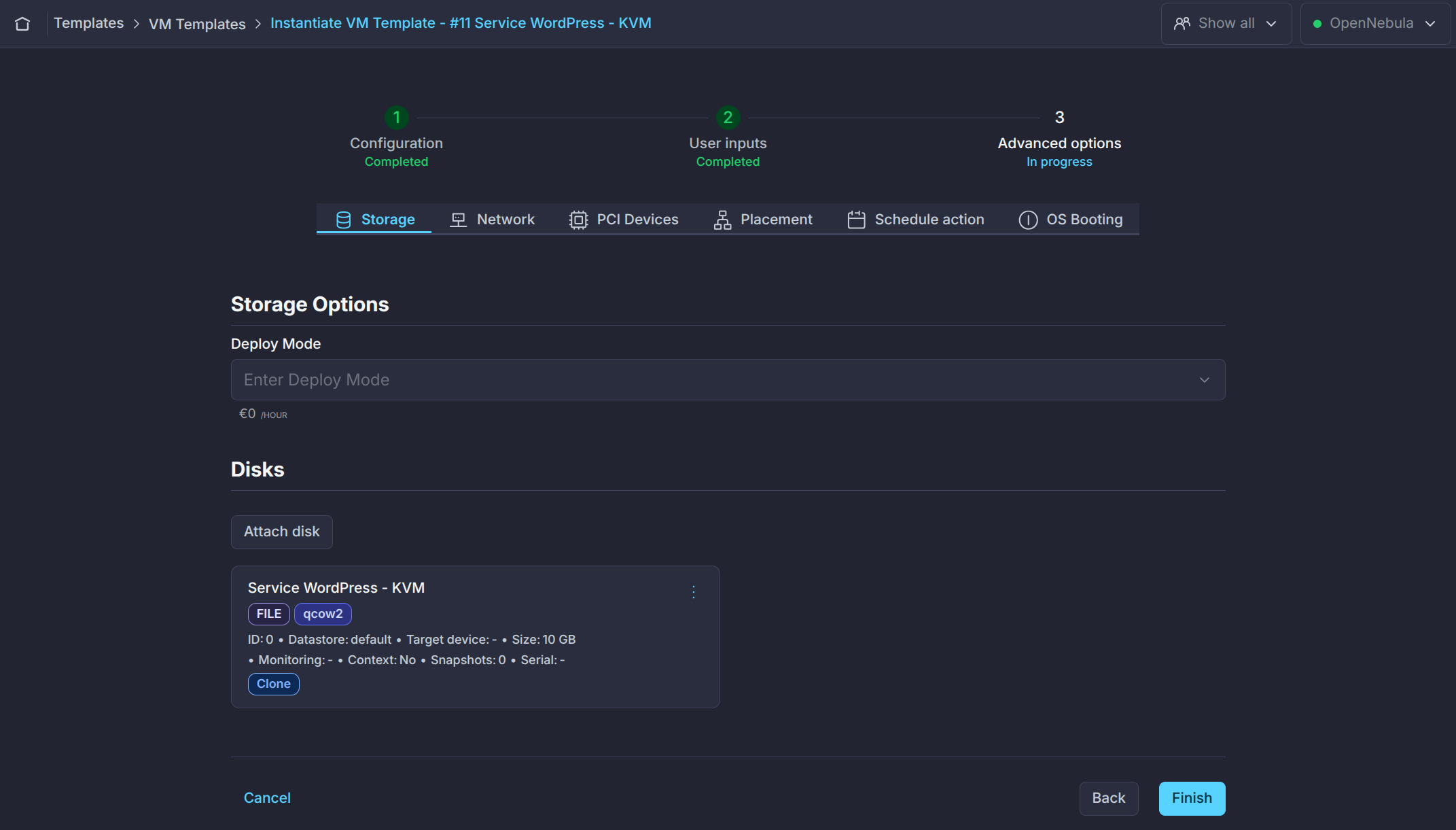

Click Next. Sunstone displays the last screen of the wizard, Advanced Options:
Sunstone VM Instantiate Wizard 3Sunstone VM Instantiate Wizard 3

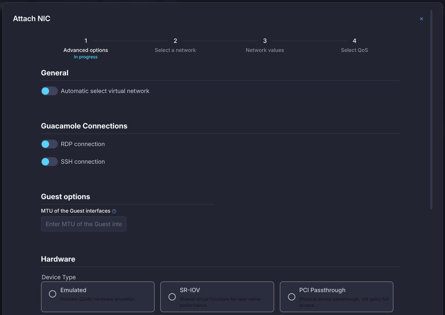

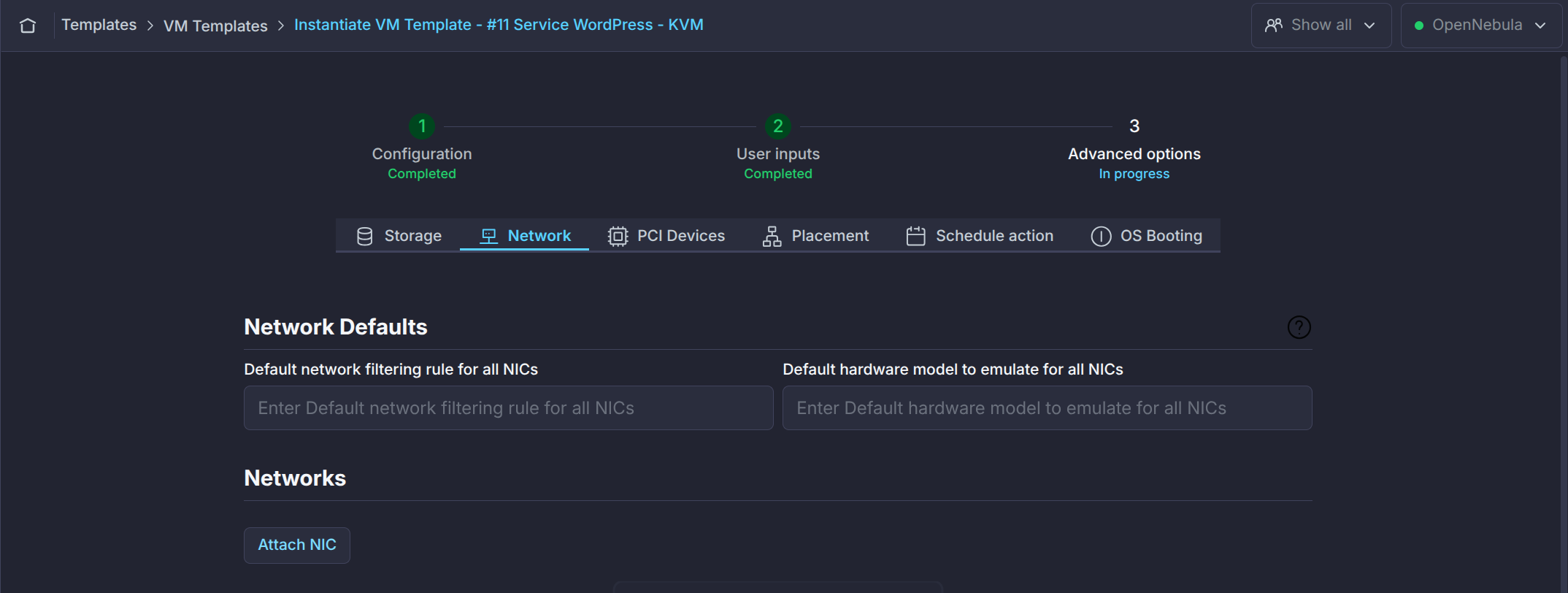

In this screen we need to specify what network the VM will connect to. Select the Network tab, then click the Attach NIC button:
Sunstone VM Instantiate Wizard 4Sunstone VM Instantiate Wizard 4
Sunstone will display a wizard with network parameters:
Sunstone Attach NIC 1Sunstone Attach NIC 1

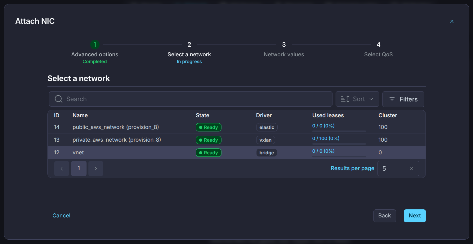

Click Next. Sunstone displays the Select a network screen:
Sunstone Attach NIC 2Sunstone Attach NIC 2

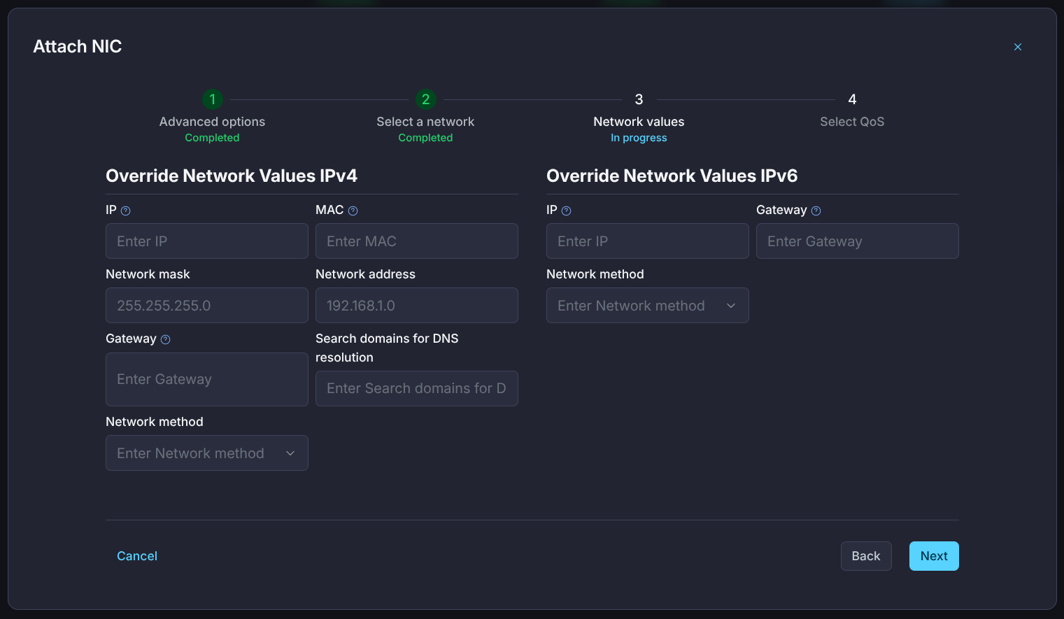

Click Next. Sunstone displays the Network values screen:
Sunstone Attach NIC 3Sunstone Attach NIC 3

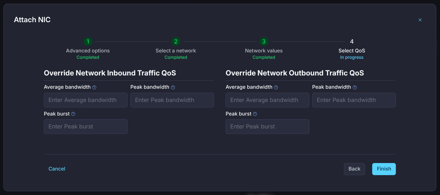

Select vnet, then click Next. Sunstone displays the final screen, Select QoS:
Sunstone Attach NIC 4Sunstone Attach NIC 4
To instantiate the VM, click Finish. Sunstone will take you to the last screen of the Instantiate VM Template wizard. To deploy the VM, click Finish.

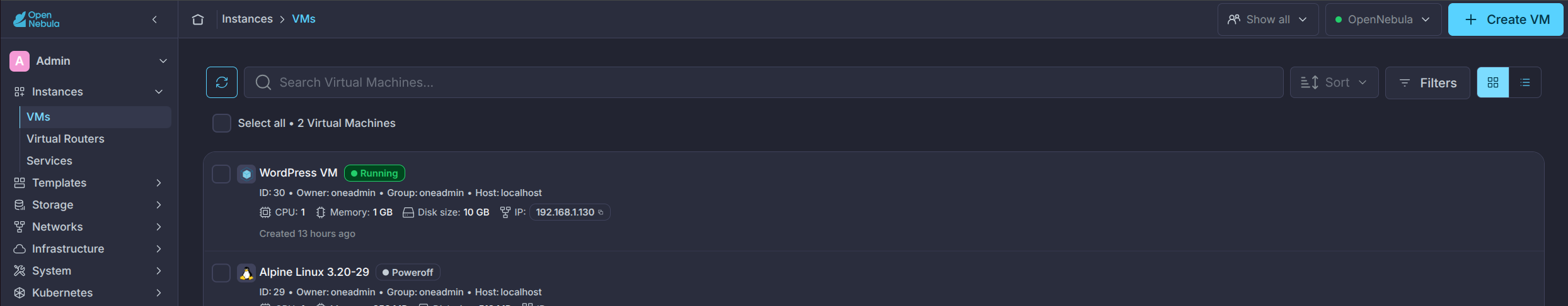

Sunstone will deploy the VM to KVM Host and display the VMs screen with the status of the VM. When the VM is running — as indicated by the green dot — it will be ready for your first login.
The image below shows the newly instantiated WordPress VM and the Alpine VM that was bundled by default with miniONE:
Word Word
As you can see in the image above, its IP address is 172.16.100.3. Note: This IP will only be reachable from localhost, bridged networks, or another instance in the same VNet.
