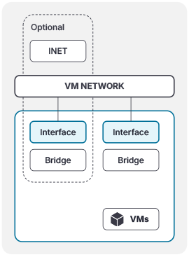

You may want to use the simplest network model that corresponds to the bridged driver. For this driver, you will need to set up a Linux bridge and include a physical device in the bridge. Later on, when defining the network in OpenNebula, you will specify the name of this bridge and OpenNebula will know that it should connect the VM to this bridge, thus giving it connectivity with the physical network device connected to the bridge. For example, a typical Host with two physical networks, one for public IP addresses (attached to an eth0 NIC for example) and the other for private virtual LANs (NIC eth1 for example) should have two bridges:
# ip link show type bridge
4: br0: ...
5: br1: ...
# ip link show master br0
2: eth0: ...
# ip link show master br1
3: eth1: ...
br0, br1, etc…), however it’s important that the bridges and NICs have the same name in all the Hosts.Step 6. Storage Configuration

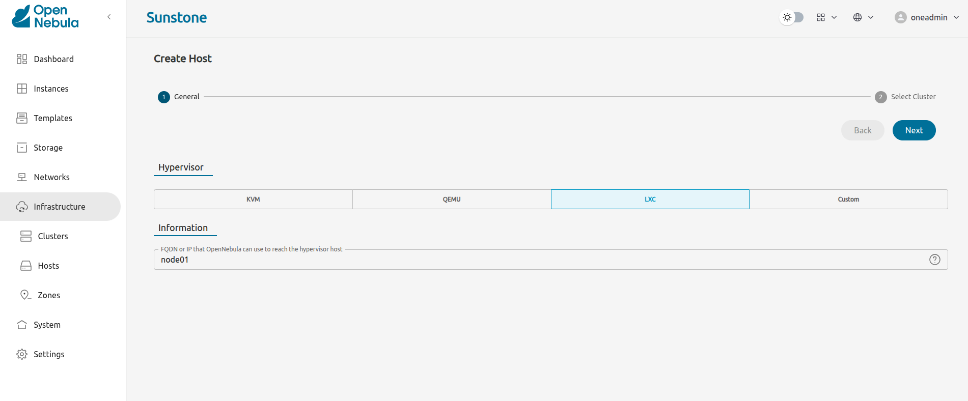

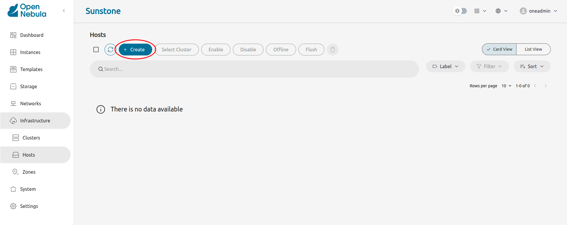

Open Sunstone as documented here. On the left side menu go to Infrastructure → Hosts. Click on the + button.
Then fill in the hostname, FQDN, or IP of the node in the Hostname field.

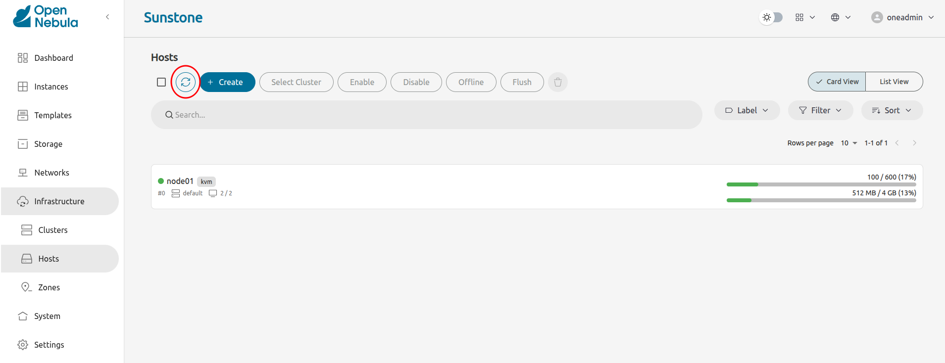

Finally, return back to the Hosts list, and check that the Host has switched to ON status. It can take up to one minute. You can click on the refresh button to check the status more frequently.
