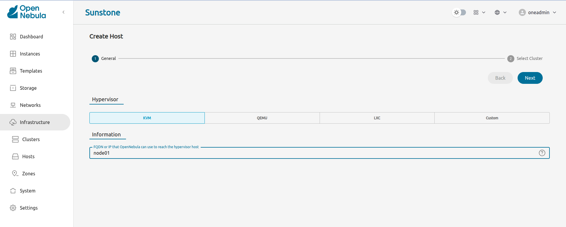

Step 7. Adding Host to OpenNebula
In this step, we’ll register the hypervisor node we have configured above into the OpenNebula Front-end, so that OpenNebula can launch Virtual Machines on it. This step is documented for Sunstone GUI and CLI but both accomplish the same. Select one of the two options only.
Learn more in Hosts and Clusters Management.
err state instead of on, check OpenNebula log /var/log/one/oned.log. The problem might be with connecting over SSH.Add Host with Sunstone
Open Sunstone as documented here. On the left side menu go to Infrastructure → Hosts. Click on the + button.
Then fill in the hostname, FQDN, or IP of the node in the Hostname field.
Finally, return back to the Hosts list, and check that the Host has switched to ON status. It can take up to one minute. Click on the refresh button to check the status more frequently.
