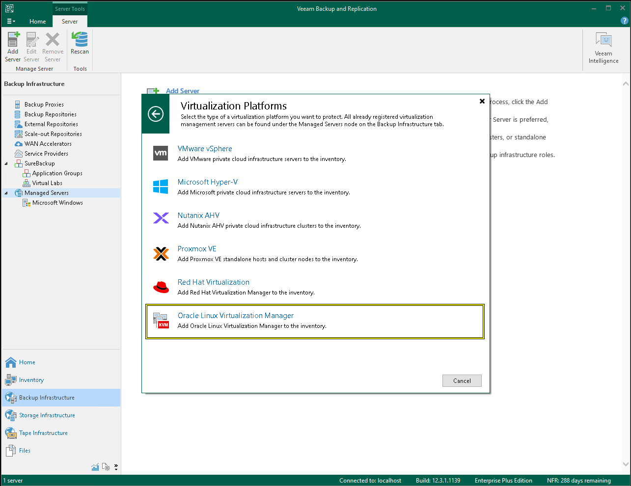

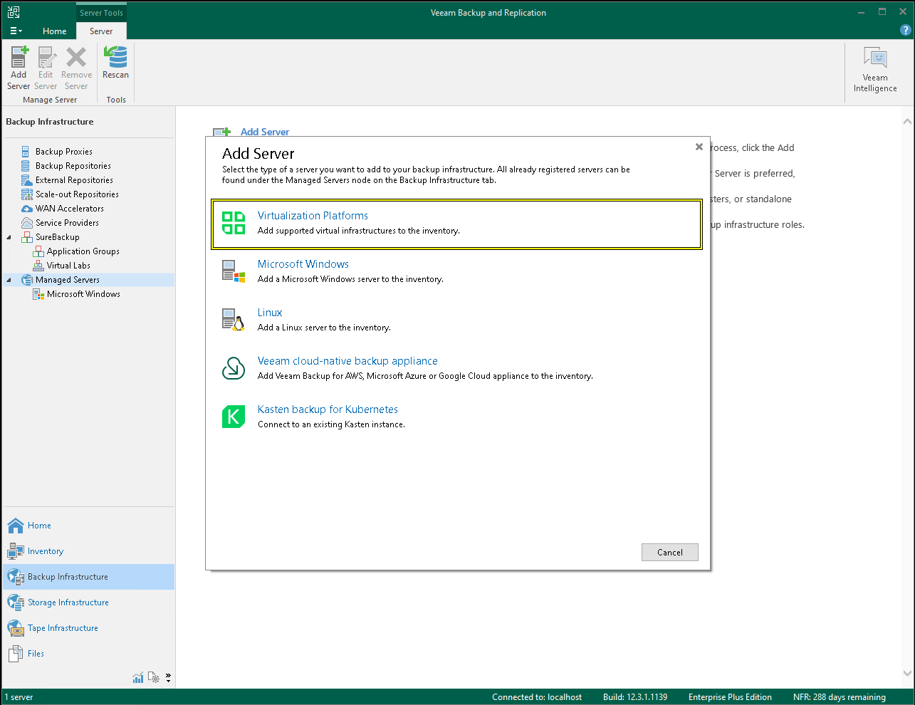

4.1. Add the new virtualization manager

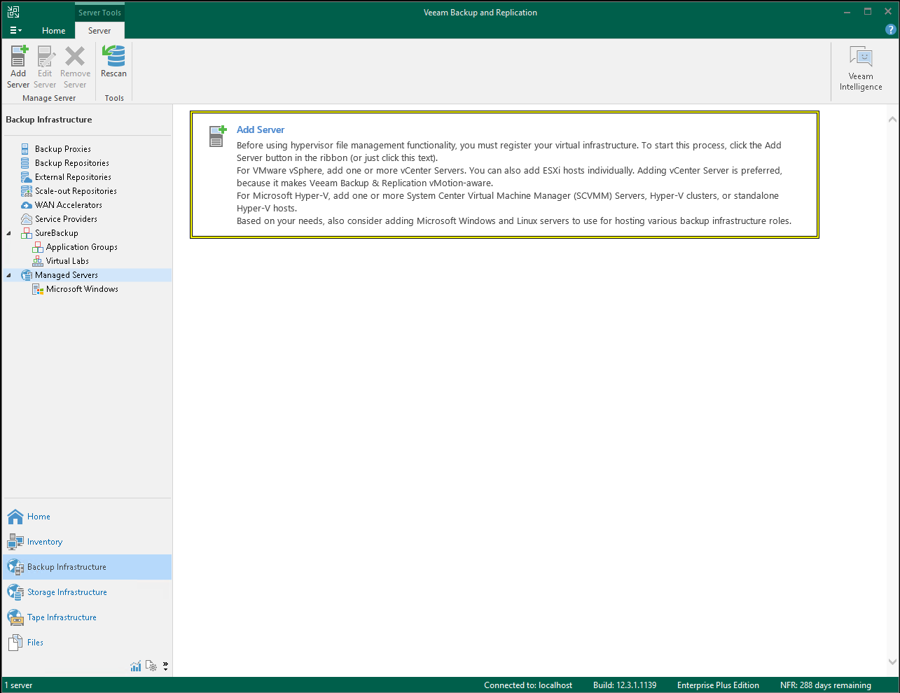

The first step should be to add the ovirtAPI Backup server to Veeam. Head over to Backup Infrastructure, then to Managed Servers, and then click Add Manager:

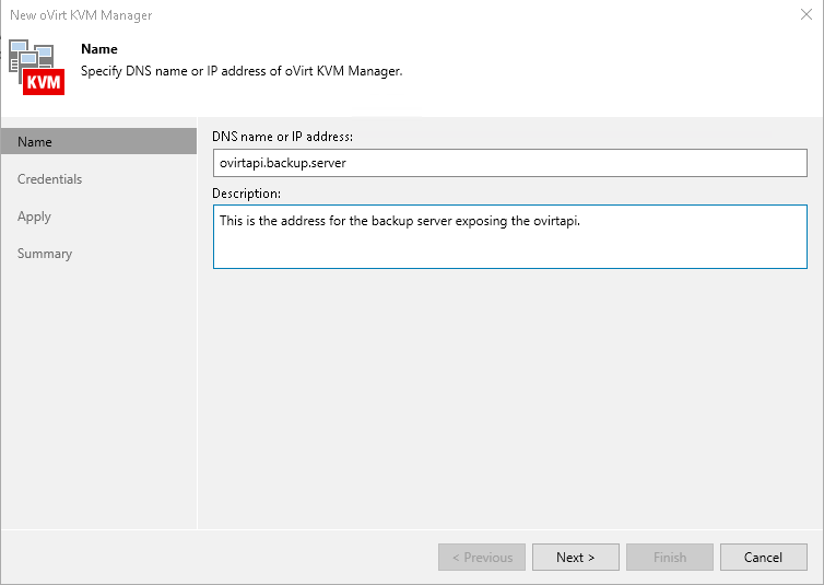

Then, choose to add a new Virtualization Platform and select Oracle Linux Virtualization Manager:
This will open a new dialog box. In the address field, you must make sure that it points to the IP address or DNS name of the server where the ovirtAPI module is installed and the backup datastore is hosted:

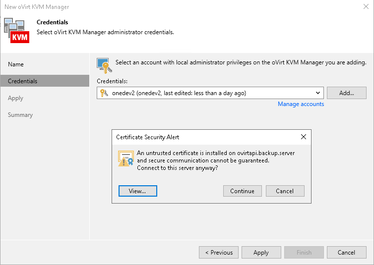

On the Credentials tab, you should set the user and password used to access the OpenNebula Front-end. You can either choose the oneadmin user or create a new user with the same privileges as oneadmin. Please remember that this user is an OpenNebula user, NOT a system user, meaning that this is a user such as the ones used to access the OpenNebula Fireedge web interface, which should be listed in the System/Users tab of Fireedge or through the CLI with oneuser list.
If you are using the default certificate, you may receive an untrust certificate warning, which you can disregard:

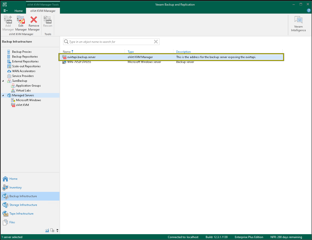

As a last step, you can click finish and the new ovirtAPI server should be listed under Managed Servers as a oVirt KVMhypervisor.

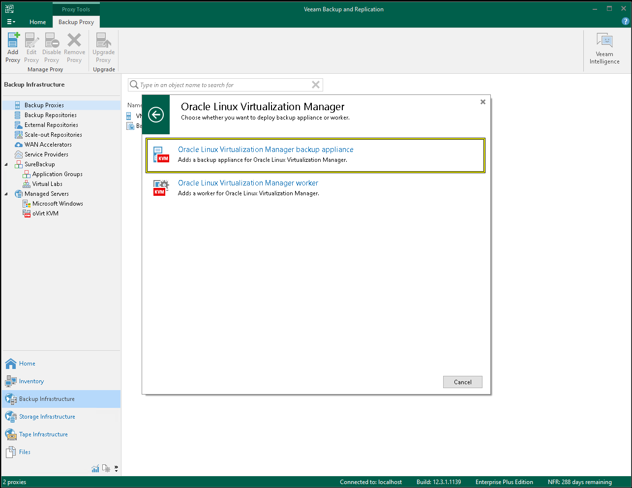

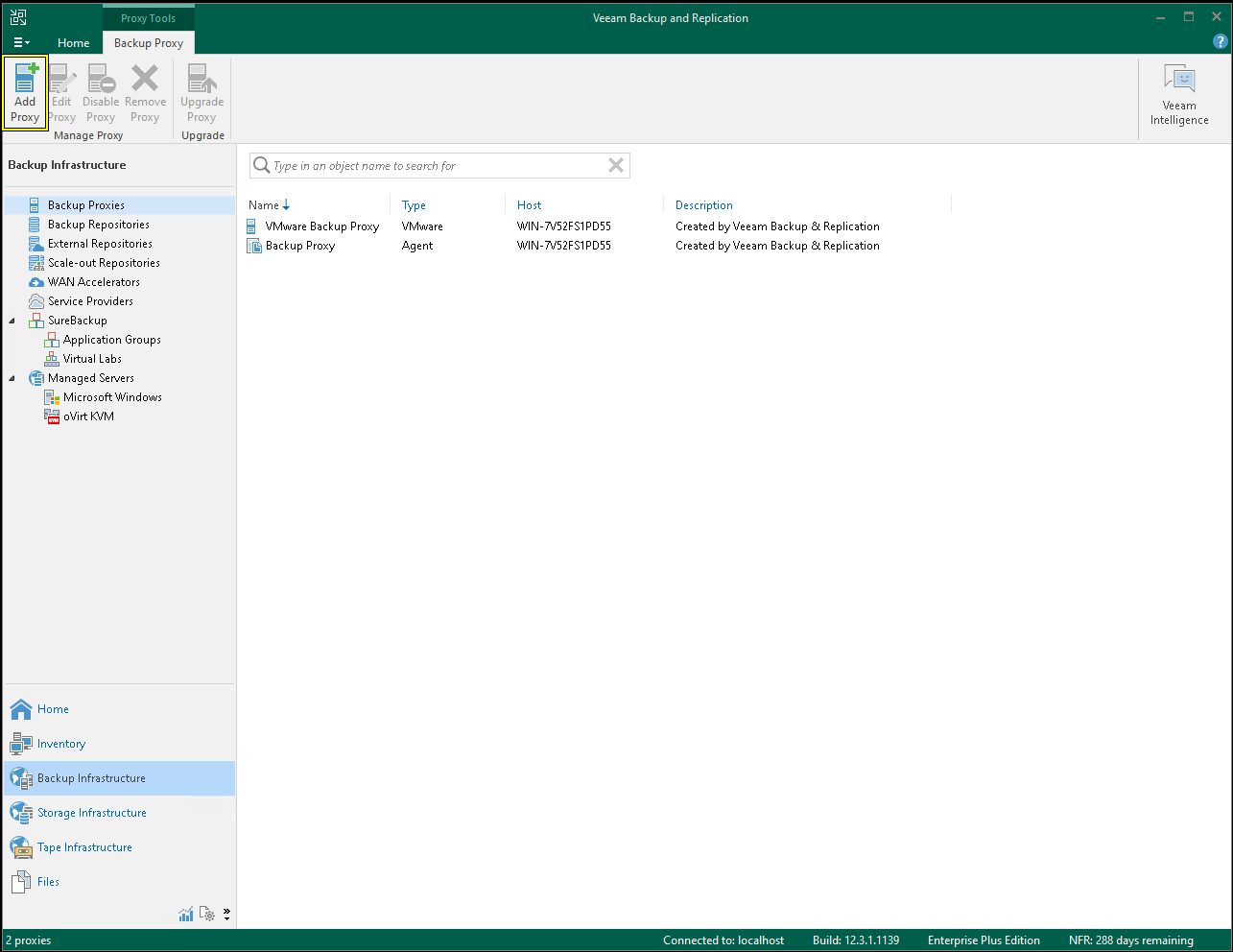

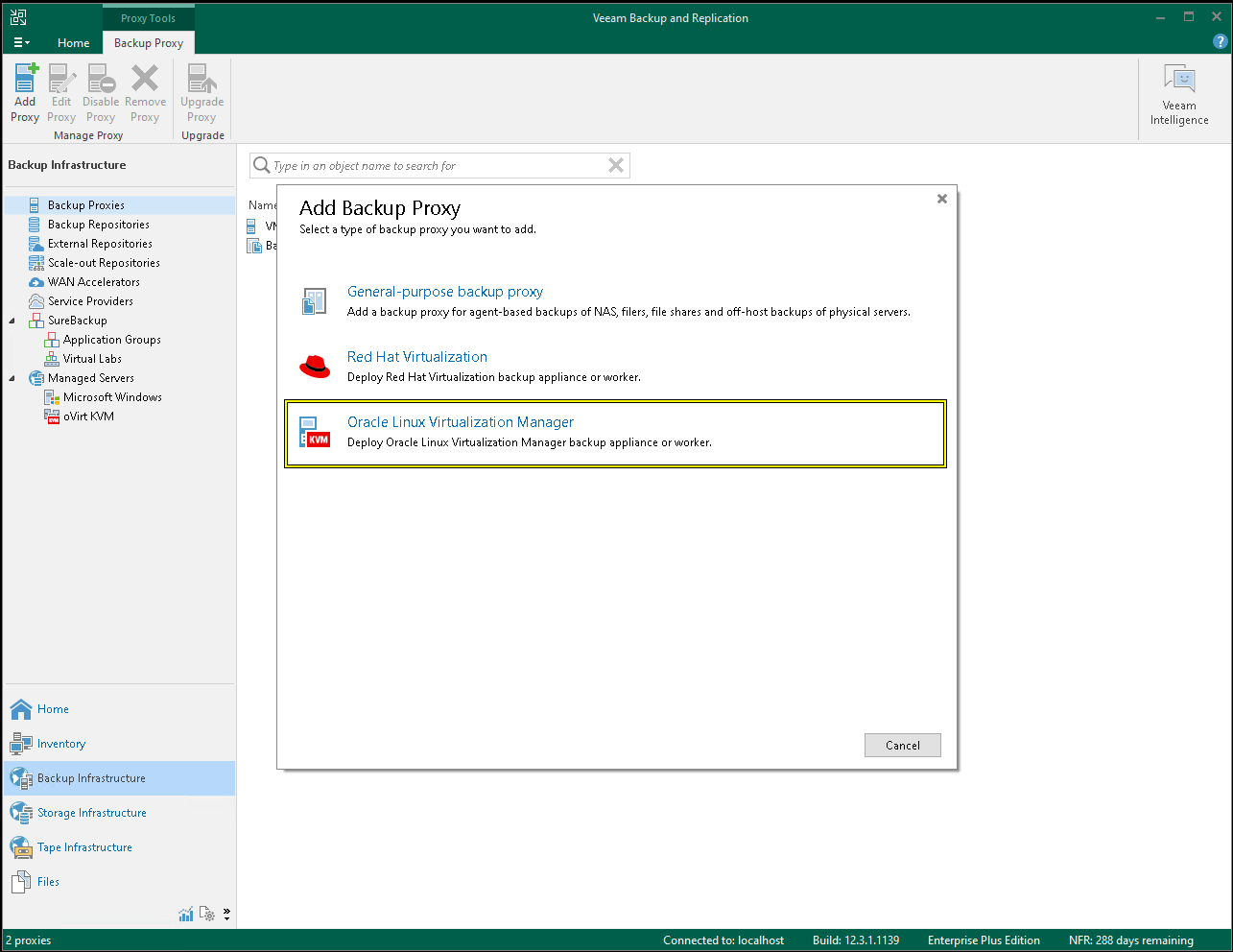

4.2. Deploy the KVM appliance

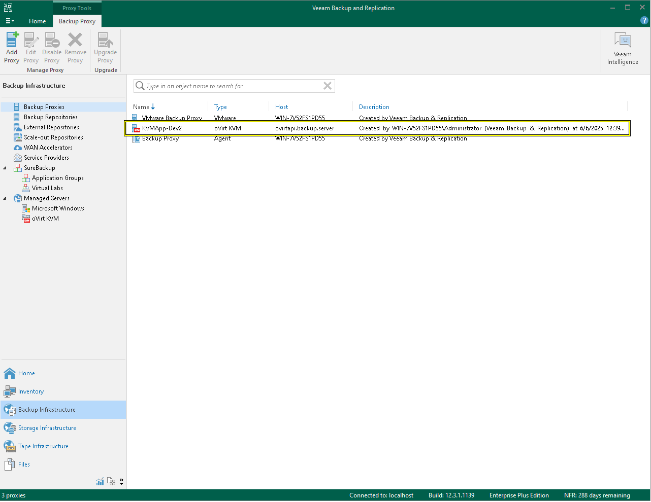

In order for Veeam to be able to perform backup and restore operations, it must deploy a dedicated Virtual Machine to act as a worker. To deploy it, go to the Backup Infrastructure tab, then Backup Proxies, and click Add Proxy:
A new dialog box will open. Select the Oracle Linux Virtualization Manager, then click to deploy the Oracle Linux Virtualization Manager backup appliance:

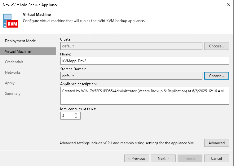

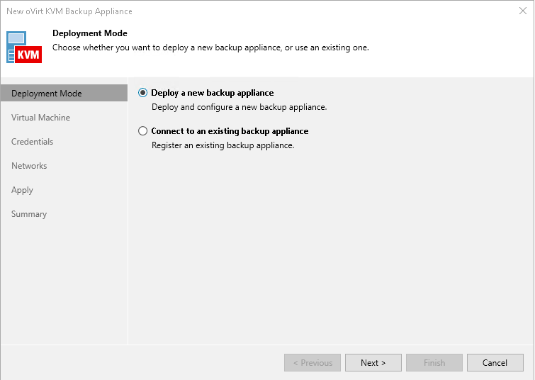

This will open a new wizard to deploy the appliance. You should choose to deploy a new appliance:
Next you should choose the Cluster on which to deploy the appliance, as well as a name and the storage domain where the appliance image should be stored:

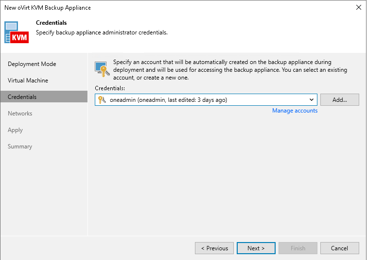

For the appliance credentials, you should choose the same ones that you set up when configuring the virtualization manager in the previous steps:

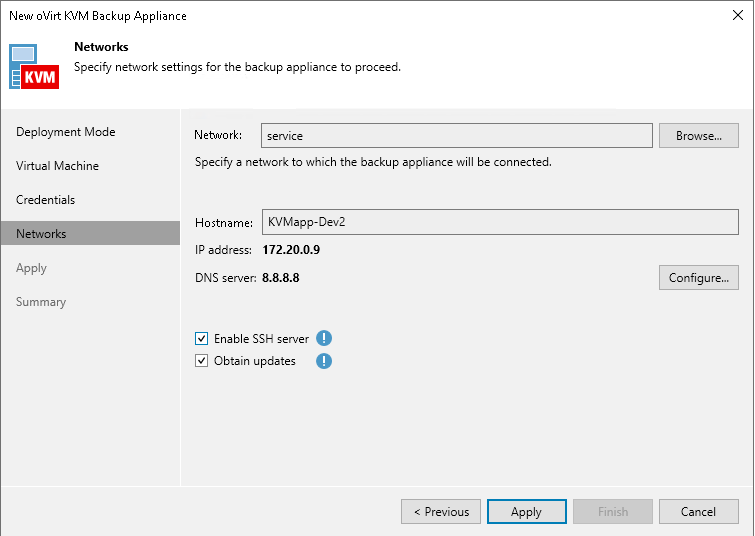

In the Network Settings tab, choose the management network that the appliance will use. It is recommended to manually choose the IP address configuration that the appliance will use. If no DHCP service is setup, use the first available free IP in the range of the management network.
In the next step, Veeam will take care of deploying the appliance. Once finished, you should see it listed in the same tab:

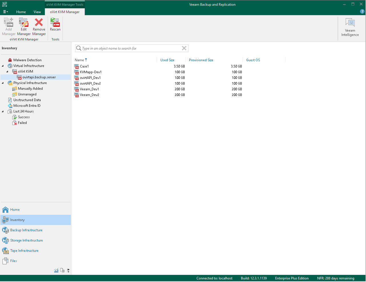

4.3 Verification
If everything is set properly, you should be able to see the available Virtual Machines in the Inventory tab under the Virtual Infrastructure -> oVirt KVM section.
