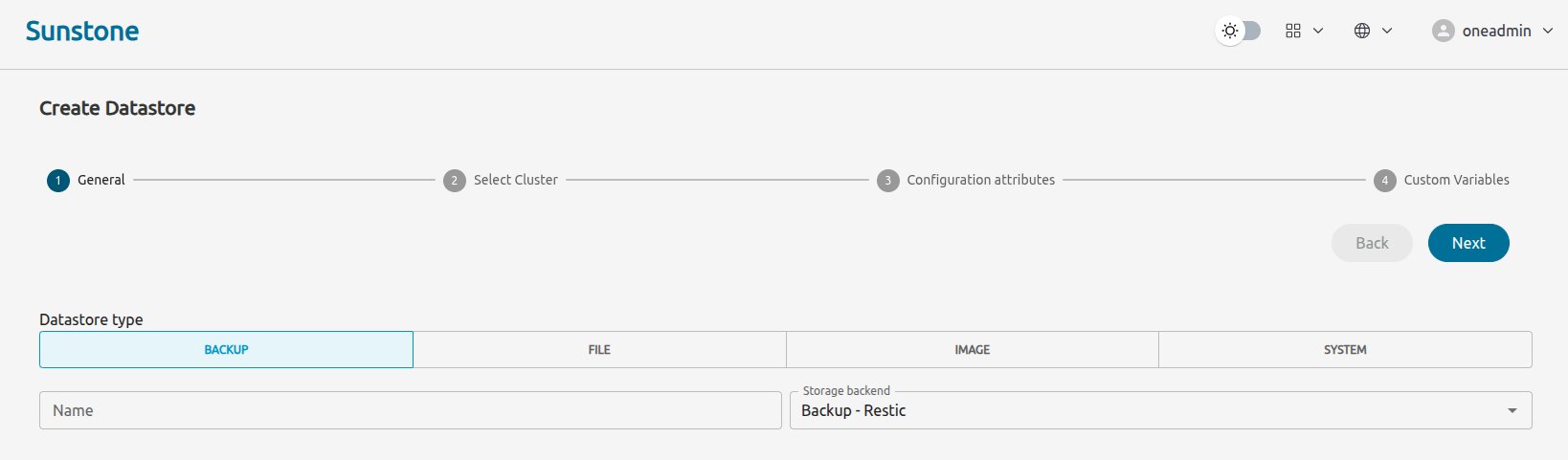

You can also create the DS through Sunstone like any other datastore:
After some time, the datastore should be monitored:
