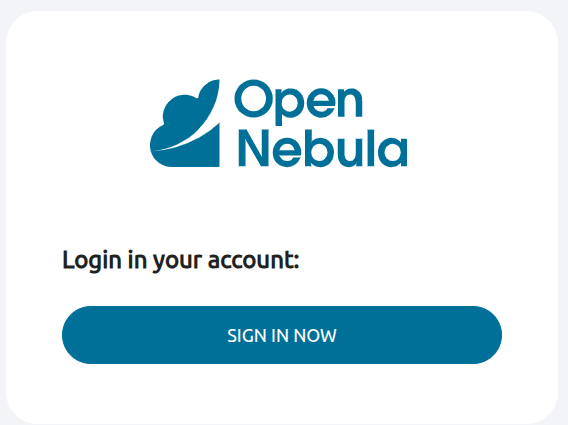

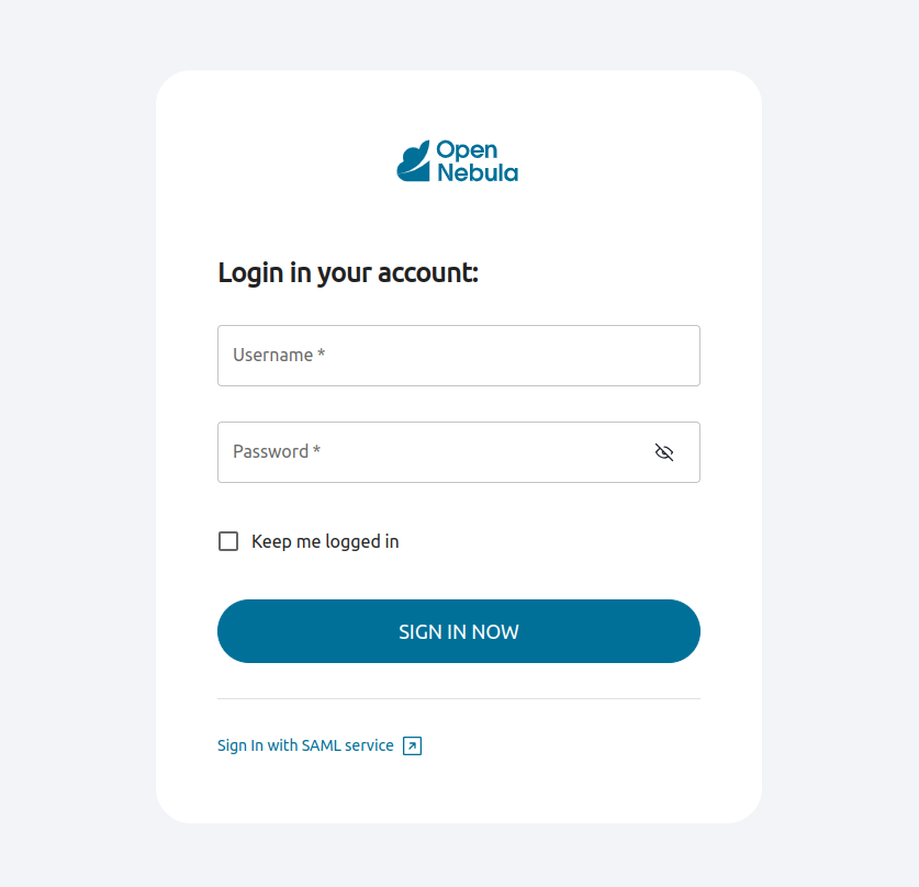

To enable the link at the bottom of the Fireedge login, you must configure :auth_redirect: <SAML_LOGIN_ENDPOINT> and restart Fireedge. Example: if using Keycloak as a SAML service, the URL must have this pattern:
:auth_redirect: ‘http://<URL_SAML_SERVICE>/realms/<REALM>/protocol/saml/clients/<CLIENT>’
sunstone_remote_login_saml
In case that the redirection is invalid, please check the Master SAML Processing URL on your provider (should be similar to http(s)://<FIREEDGE_SERVER>/fireedge/api/auth/acs)

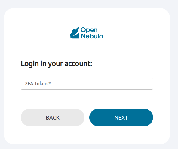

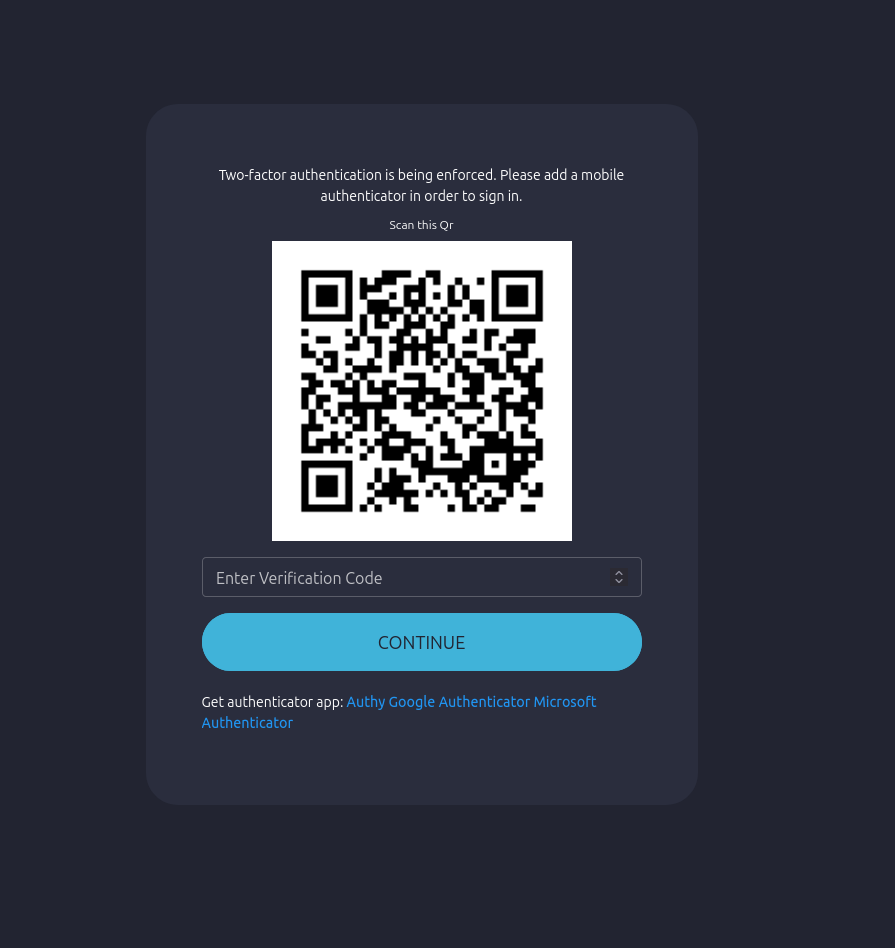

Attempting to log in without a TFA authenticator set will present the following screen, prompting the user to add one.
sunstone_tfaenforce_screen

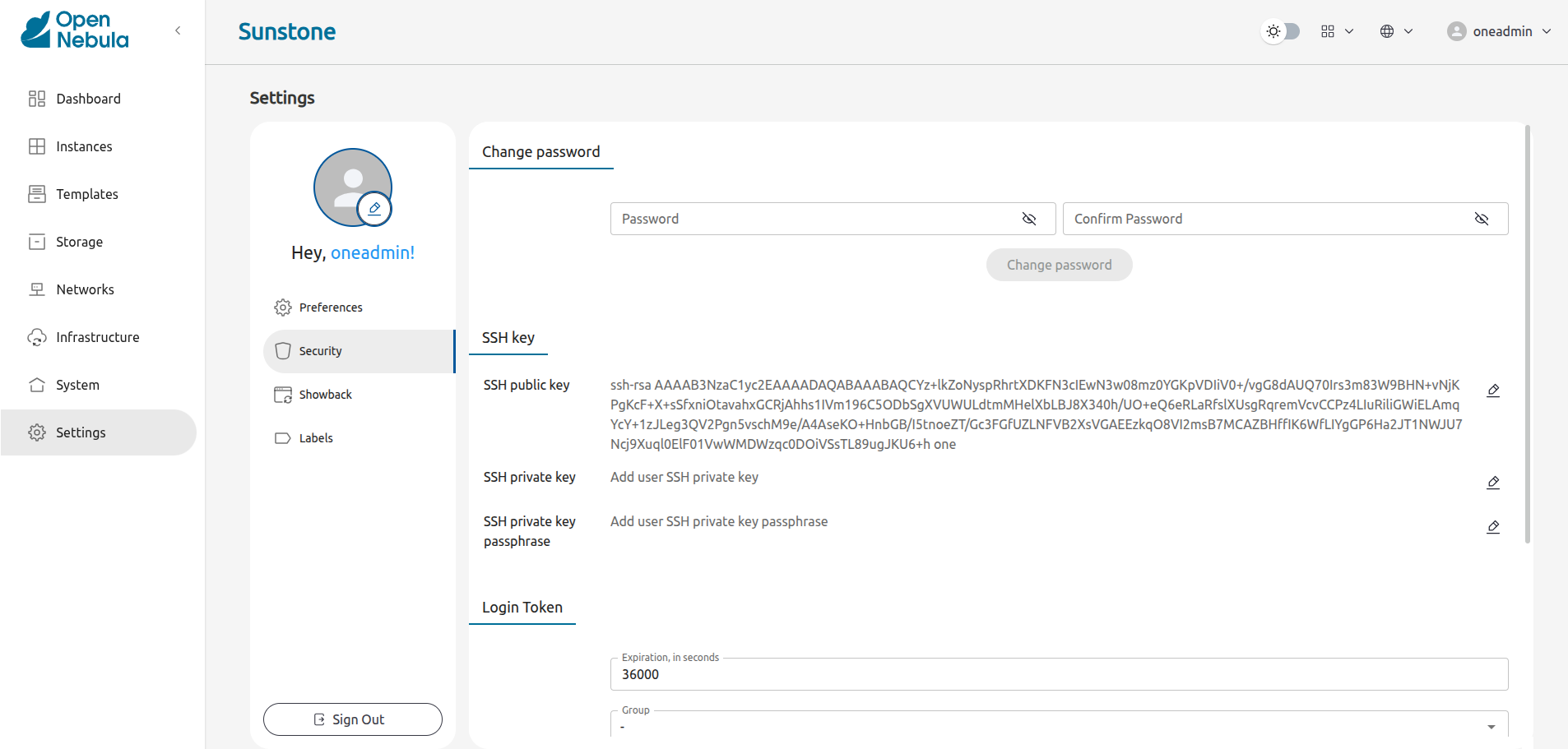

  • Log in to Sunstone and select menu Settings. Inside, find the section Two Factor Authentication.
  • In this section, find and select the button Register Authenticator App.
sunstone_setting_auth

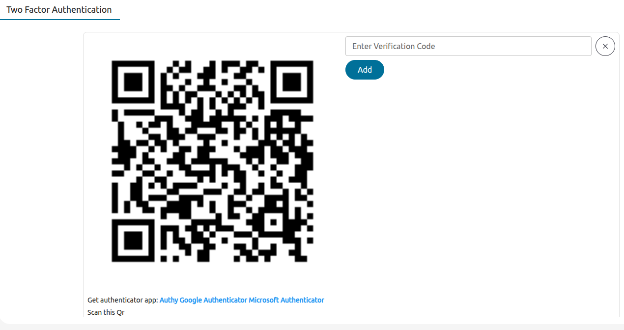

  • Scan the Qr code with the aforementioned apps and enter the verification code.
sunstone_setting_tfa_app

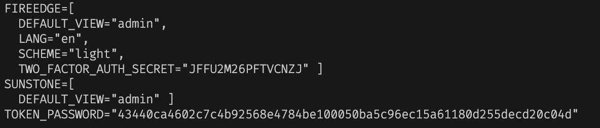

Internally Sunstone adds the field TWO_FACTOR_AUTH_SECRET.
sunstone_template_user_auth

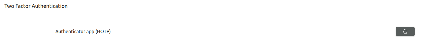

  • To disable 2FA, go to the Settings, find the section Two Factor Authentication and click the Remove button.
sunstone_settings_2fa_dissable
