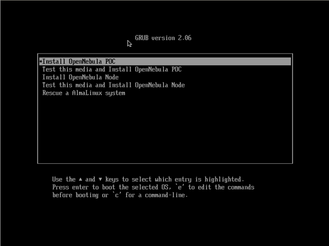

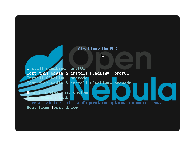

With the media inserted (or virtually mounted) on the server, after rebooting it, set the right boot device in the BIOS. Some BIOS may be able to boot the media as MBR and UEFI. We recommend to boot is as UEFI for compatibility reasons.
The bootloader will show the following screen
uefi_boot_screenmbr_boot_screen
UEFI boot screenMBR boot screen
The recommended options are the following:
  • Install OpenNebula POC will install a full OpenNebula Front-end and the necessary software to make it an OpenNebula KVM hypervisor node.
  • Install OpenNebula Node will install only the KVM hypervisor packages to create a compute node or Host that can be managed by the OpenNebula Front-end.

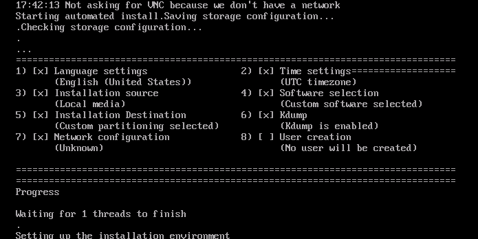

The installation interface will be in text mode and will only ask for confirmation before deleting all the data on the first disk that it finds on a screen that looks like the following:
validation_script

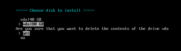

After that, a little menu showing all the available, non-removable disks, will be shown in the format disk|sizeGB. After choosing the disk, a confirmation menu with the options yes and no will be shown.
disk_selection
Answer yes to continue. You may be prompted to choose the disk to which you want to install. After choosing the disk and confirming, the installation will commence. The installation will take several minutes:
anaconda_unattended_install

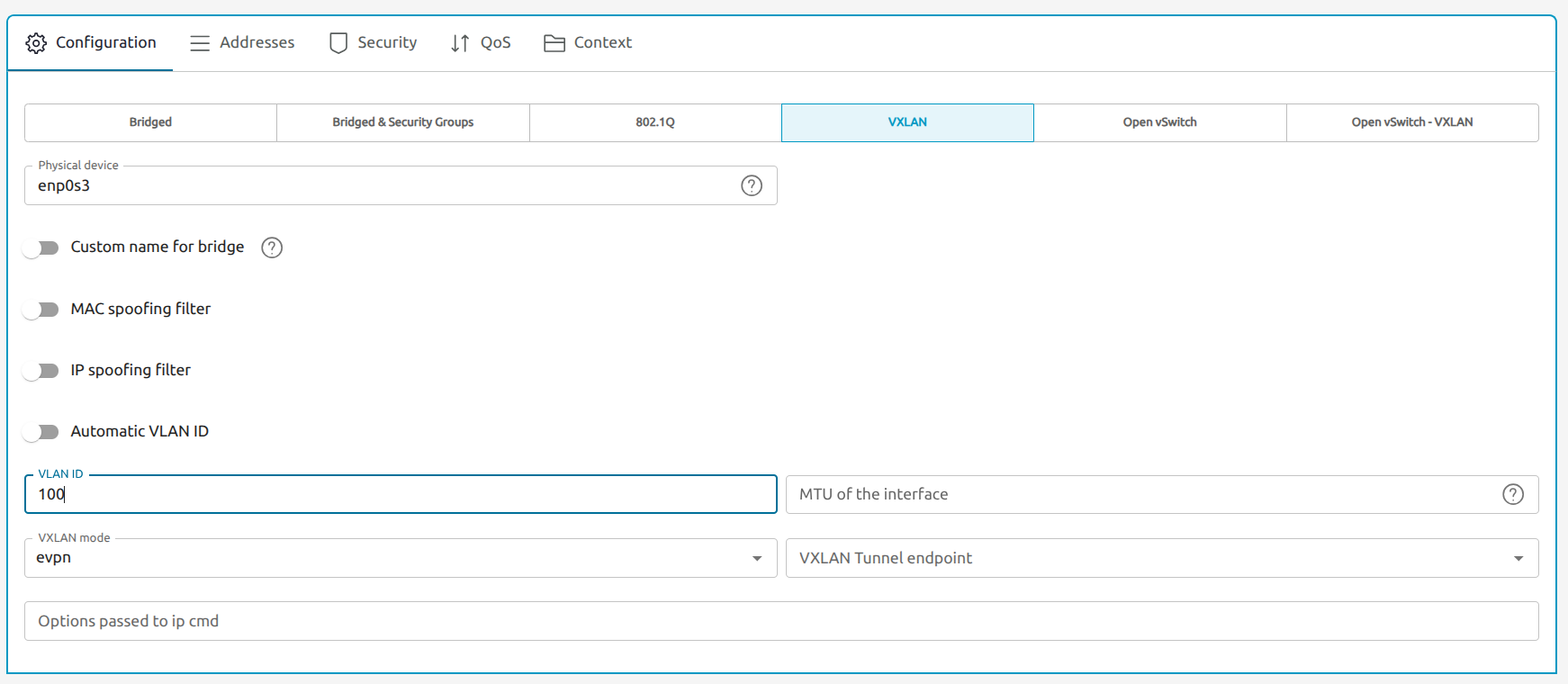

To set up a Virtual Network using VXLAN, in the Sunstone UI go to Networks -> Virtual Networks and select + Create. Name the network and click Next. Select VXLAN in the following page. Choose a number below the maximum 16777215 for the VLAN ID (e.g. 100) and select evpn for the VXLAN mode. The Physical device field should be set to the name of the network interface of the OpenNebula Front-end server that was selected earlier during the ISO installation. Run nmcli device status on the command line of your Front-end if you need to recall the name.
sunstone-network_config

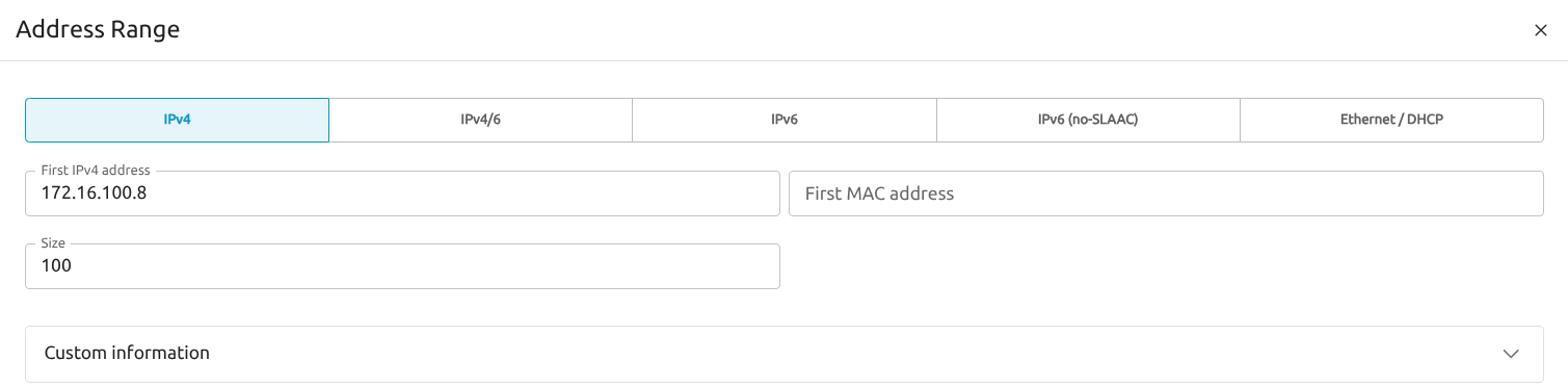

Select the Addresses tab and create a new address range with + Address Range. Select a starting address from a private range (such as 172.16.10.1 or 10.0.0.1) that is distinct from your Host’s current IP network to avoid confusion. In this case we chose an IPv4 address range starting from 172.16.100.8 with 100 consecutive IPs (172.16.100.0-7 should be reserved for the network base address, the gateway and other infrastructure).
sunstone-network_ip_range

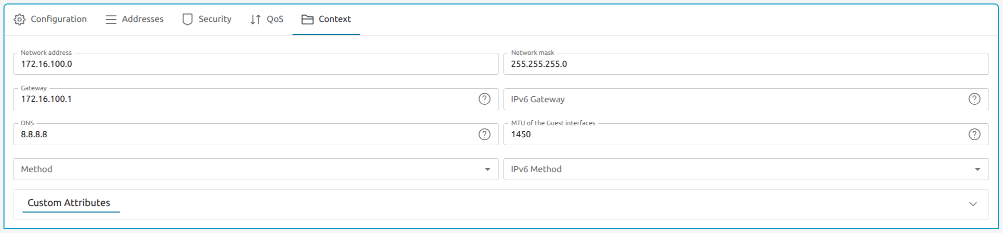

Select the Context tab and enter values similar to the following, based on the First IPv4 address you chose in the previous step:
ParameterValue
First IPv4 address172.16.100.8
Network address172.16.100.0
Network mask255.255.255.0
Gateway172.16.100.1
DNS8.8.8.8 (Google)
MTU of the Guest interfaces1450
sunstone-network_context

Add Local Route (access from external networks to the Virtual Network)
After the gateway has been created and NAT masquerade has been enabled, the VMs in the Virtual Network 172.16.100.0/24:
  • can communicate (bidirectionally) with the Front-end
  • can access to the same networks that the Front-end (i.e. internet)
Currently, any machine (even if it has access to the Front-end) cannot reach ths Virtual Network because doesn’t know how to arrive to it. For that, a route via the Front-end external IP is needed. A route can be added locally.
On a workstation with access to the Front-end, a local route to the Virtual Network can be created with the following commands depending on the operating system
  • Linux: sudo ip route add 172.16.100.0/24 via <frontend_ip>
  • Windows: route add 172.16.100.0 MASK 255.255.255.0 <frontend_ip>
  • BSD: route add -net 172.16.100.0/24 <frontend_ip>
After the route exists, the workstation should be able to reach the Virtual Machines running on the Front-end without further configuration.

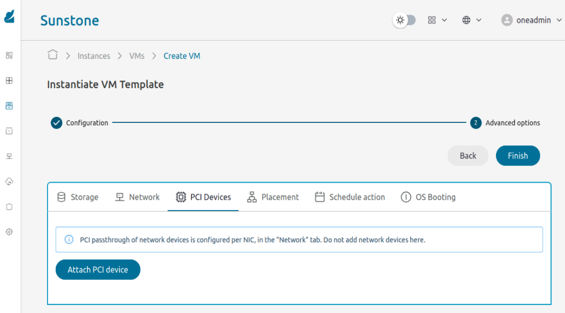

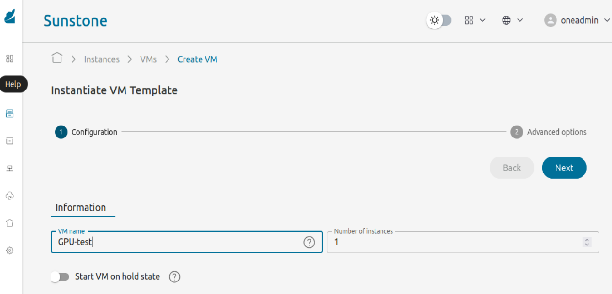

VM with GPU Instantiation
To instantiate VM with a GPU login into the OpenNebula GUI and navigate to the VMs tab. Click “Create”. Then select one of the VM templates On the next screen enter the VM name and click “Next”.
VM Instantiation

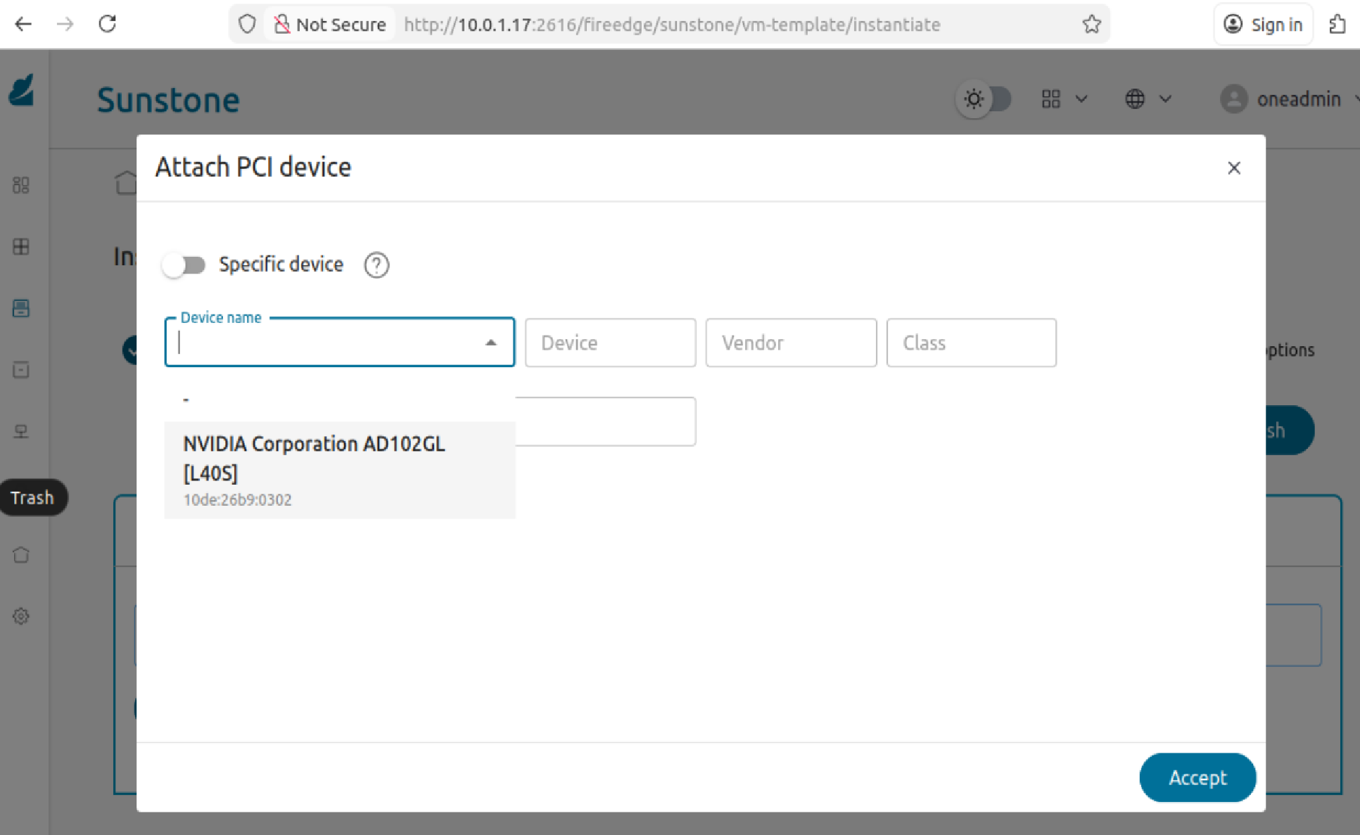

On the next screen select required Storage and Network options. In the “PCI Devices” section click “Attach PCI device”
PCI Device attachment
In the dropdown menu select available GPU device which will be attached to the VM. Then click “Accept” button and finalize VM configuration.
Click the “Finish” button to start VM instantiation. After a while, the VM will be instantiated and may be used.

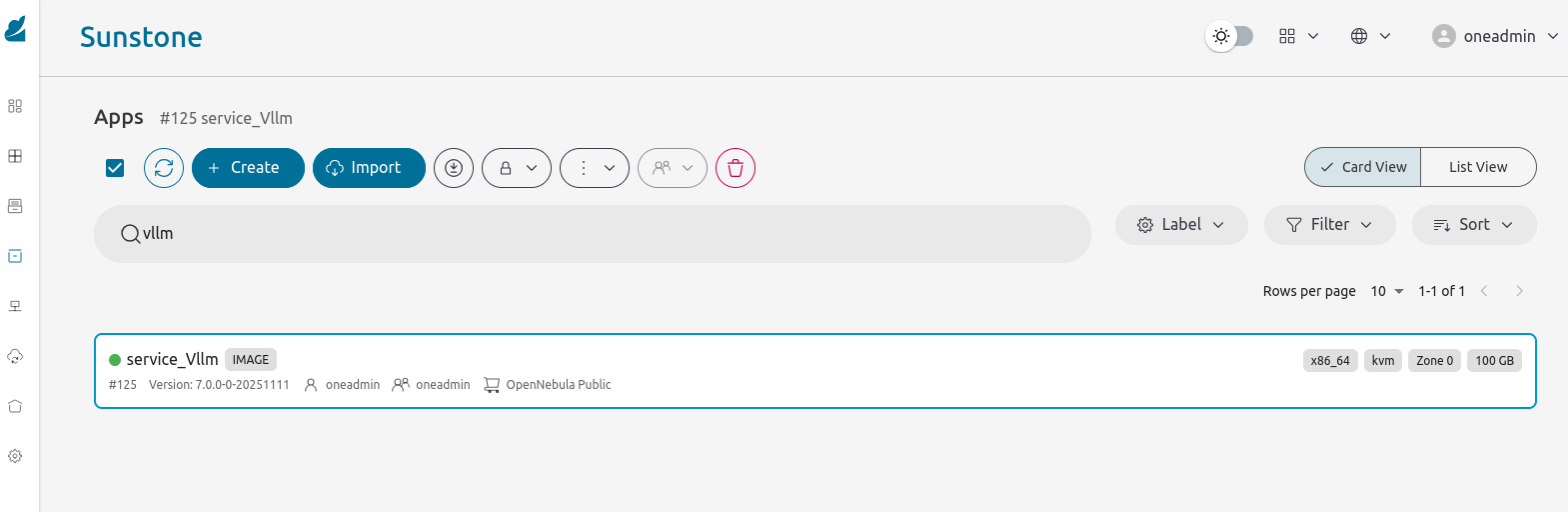

vLLM Appliance Validation
The vLLM appliance is available through the OpenNebula Marketplace. Follow steps from this guide from the official documentation. To download vLLM appliance and instantiate with a GPU in passthrough mode, the following steps have to be performed:
  1. Go to Storage -> Apps section. Search for vLLM appliance and import it. Select DataStore where to save image
  1. Go to VMs section and instantiate vLLM appliance. Specify common VM parameters. In the “Advanced Settings” go to “PCI devices” and ensure that required GPU device selected for attachment to the VM. Click “Accept” and then “Finish” to instantiate vLLM appliance.
  2. Once vLLM appliance instantiated, follow steps from the LLM inference guide to access a webchat app or execute benchmarking tests
