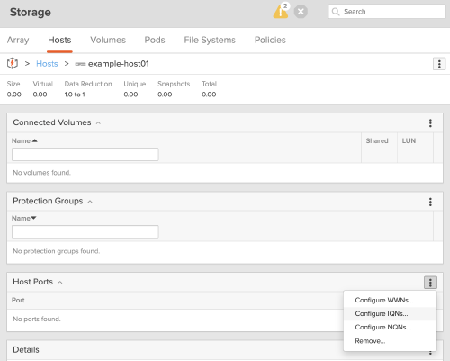

Host and Host Group
For each of the hosts and frontend you’ll need to either gather or define their iSCSI Initiator Name. If you have already started iscsid at least once on the machine it should have a name generated in /etc/iscsi/initiatorname.iscsi. If you would prefer to define it, you can modify that file’s contents to something like InitiatorName=iqn.2024-01.com.example.pure:some.host.id then restarting iscsid (and then reconnect any active iscsi sessions, if already connected). Each name must be unique.
Navigate to Storage → Hosts in the PureStorage dashboard. For each OpenNebula host and frontend, select the + in the top right of the Hosts card and set a Name that clearly identifies the host, and leave the Personality as None. You can also use the “Create Multiple…” if you have many hosts.
Once each host is populated in the list, click into each of them and then on the Host Ports card, select the Menu () button and select Configure IQNs. Paste the initiator name from /etc/iscsi/initiatorname.iscsi from the proper host here.

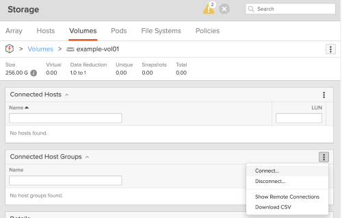

Volume Creation and Connection
From the PureStorage dashboard, navigate to Storage → Volumes. Here, in the top right of the Volumes card, select +.
Give the volume a name (this can just be the name of your OpenNebula LVM volume group or something descriptive), and set the desired size. Thin provisioning is always enabled on Pure, so there’s no need to configure anything extra.
You don’t need to configure snapshots, protection policies, or replication unless you’re doing something more advanced. For basic OpenNebula integration, just create the volume and leave everything else at defaults.
Click on the volume you just created, and on the Connected Host Groups card, click the Menu () button and click Connect…. Select your host group (or individual hosts if you’re not using a group), and confirm the connection.
Once connected, the volume will be exposed to all hosts in the group. You can update the host group if you add/remove hosts from your OpenNebula installation.
