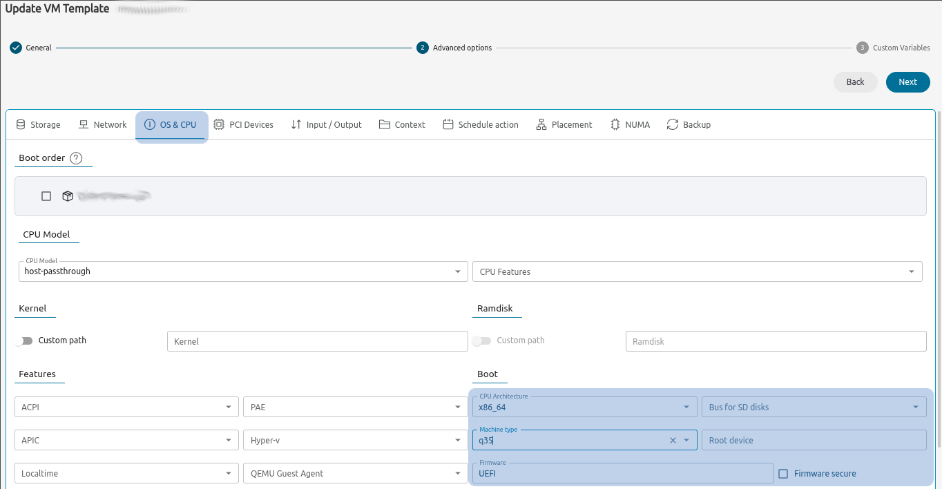

Virtual machines with UEFI BIOS
OneSwap normally detects if the VM boots in UEFI mode and sets up OpenNebula template accordingly, but in some strange cases autodetection may fail. In these cases, modify the following options on the OpenNebula template:
- CPU architecture:
x86_64 - Machine type:
q35 - UEFI firmware:
UEFI(for secure firmware the box must be checked)
