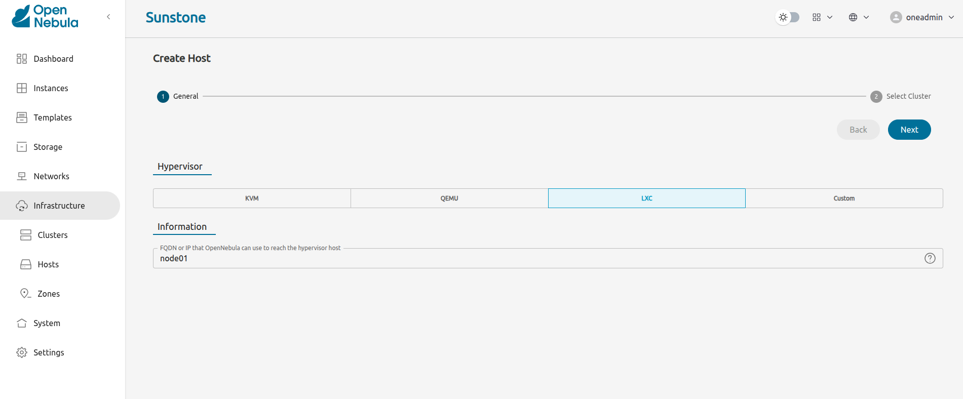

. The problem might be with connecting over SSH.Add Host with Sunstone
Open Sunstone as documented here. On the left side menu go to Infrastructure → Hosts. Click on the +
button.
Then fill in the hostname, FQDN, or IP of the node in the Hostname
field.
Finally, return back to the Hosts list, and check that the Host has switched to ON
status. It can take up to one minute. You can click on the refresh button to check the status more frequently.
