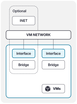

You may want to use the simplest network model that corresponds to the bridged driver. For this driver, you will need to set up a Linux bridge and include a physical device in the bridge. Later on, when defining the network in OpenNebula, you will specify the name of this bridge and OpenNebula will know that it should connect the VM to this bridge, thus giving it connectivity with the physical network device connected to the bridge. For example, a typical Host with two physical networks, one for public IP addresses (attached to an eth0
NIC for example) and the other for private virtual LANs (NIC eth1
for example) should have two bridges:
# ip link show type bridge
4: br0: ...
5: br1: ...
# ip link show master br0
2: eth0: ...
# ip link show master br1
3: eth1: ...
Remember that this is only required in the Hosts, not in the Front-end. Also remember that the exact name of the resources is not important (br0
, br1
, etc…), however it’s important that the bridges and NICs have the same name in all the Hosts.Step 6. Storage Configuration (Optional)

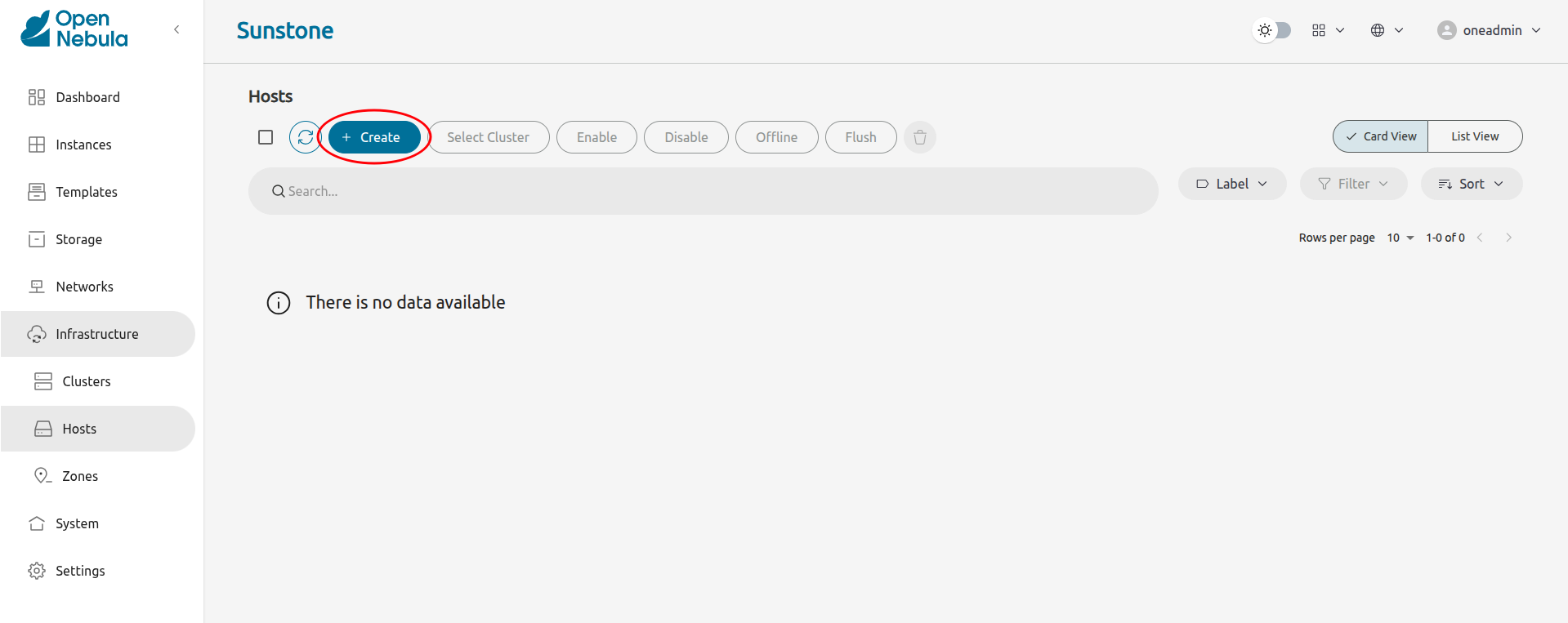

Open Sunstone as documented here. On the left side menu go to Infrastructure → Hosts. Click on the +
button.

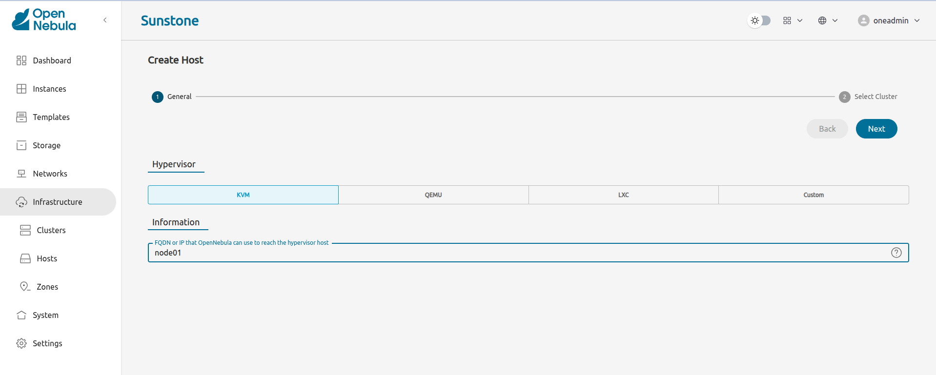

Then fill in the hostname, FQDN, or IP of the node in the Hostname
field.

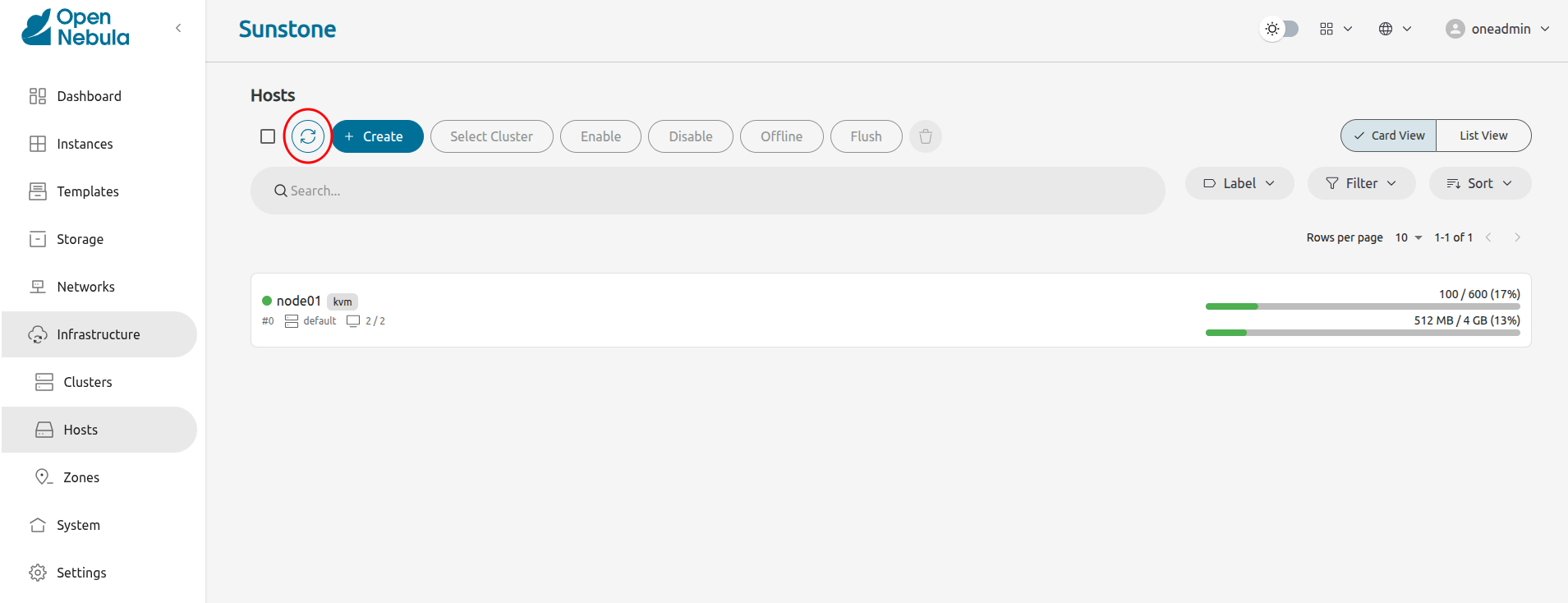

Finally, return back to the Hosts list, and check that the Host has switched to ON
status. It can take up to one minute. Click on the refresh button to check the status more frequently.
