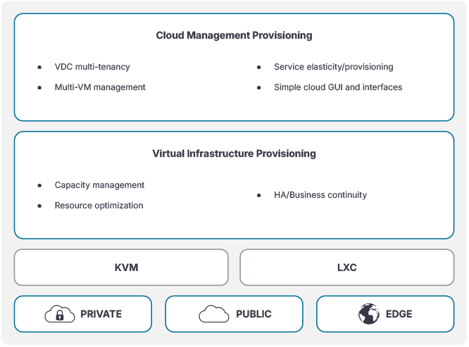

3.1. Choose Your Hypervisor
The first step in building a customized cluster is to decide on the hypervisor that you will use in your cloud infrastructure. The main OpenNebula distribution provides full support for KVM, one of the most efficient and widely used hypervisors, as well as LXC system containers.
- Virtualization and Cloud Management on KVM. Many companies use OpenNebula to manage data center virtualization, consolidate servers, and integrate existing IT assets for computing, storage, and networking. In this deployment model, OpenNebula directly integrates with KVM and completely controls virtual and physical resources, providing advanced features for capacity management, resource optimization, high availability, and business continuity. Some of these deployments additionally use OpenNebula’s Cloud Management and Provisioning features for federating data centers, implementing cloud bursting, or offering self-service portals for end users.
- Containerization with LXC. Containers have a minimal memory footprint and avoid the compute-intensive and sometimes unacceptable performance degradation inherent to hardware emulation. You can have a very high density of containers per virtualization node and run workloads close to bare-metal metrics. LXC focuses on system containers, unlike similar technologies such as Docker, which focuses on application containers.
OpenNebula allows you to deploy heterogeneous multi-hypervisor environments managed by a single OpenNebula instance, so after installing the cloud with one hypervisor you can add another. The ability to gradually integrate open source hypervisors helps to protect existing IT investments and facilitates evaluation and testing, at the same time avoiding vendor lock-in by using open-source components.

4.1. Define a Provisioning Model
Before configuring multi-tenancy and defining the provisioning model of your cloud, we recommend you consult the introduction to the OpenNebula Provisioning Model. In a small installation with few Hosts, you can use OpenNebula without giving much thought to infrastructure partitioning and provisioning; however, for medium and large deployments you will probably want to provide some level of isolation and structure.
OpenNebula helps you to define a provisioning model based on two concepts:
- Users and Groups. OpenNebula features advanced multi-tenancy with powerful user and groups management, implemented through an Access Control List mechanism that allows for differential role management based on fine-grained permissions that can be applied over any resource. The resource quota management subsystem lets you track and limit the use of computing, storage, and networking resources.
- Virtual Data Centers or VDCs allow you to assign one or more user groups to a pool of physical resources. You can also create logical pools of resources which may physically belong to different clusters and zones, and allocate them to user groups.
Finally, the accounting and showback modules allow you to visualize and report resource usage data, produce usage reports, and integrate with chargeback and billing platforms.

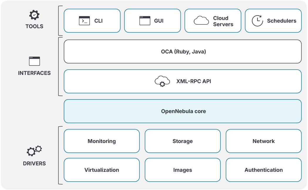

Because no two clouds are the same, OpenNebula provides many different interfaces that can be used to interact with the functionality offered to manage physical and virtual resources.
- A modular and extensible architecture with customizable plugins for integration with any third-party data center infrastructure platform for storage, monitoring, networking, authentication, virtualization, and market.
- A rich API set that offers all the functionality of OpenNebula components, with bindings for Ruby and Java as well as the XML-RPC API. These APIs will ease the integration of your cloud with higher-level tools such as chargeback, billing, or self-service platforms.
- The OneFlow API to create, control, and monitor multi-tier applications or services composed of interconnected Virtual Machines.
