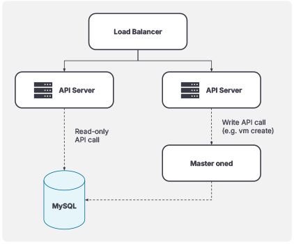

Scaling the API SERVER
In order to scale OpenNebula, it is recommended to balance client requests across multiple oned processes. This can be achieved by either using existing RAFT followers or adding oneds in an API server-only mode.
When oned is started in read-only (or cache) mode, it resolves any read-only operation by accessing the database directly. In particular, the following API calls are served directly by the server in cache mode:
one.vmpool.info one.clusterpool.info one.group.info one.vmpool.accounting one.zonepool.info one.user.info one.vmpool.showback one.secgrouppool.info one.datastore.info one.vmpool.monitoring one.vdcpool.info one.cluster.info one.templatepool.info one.vrouterpool.info one.document.info one.vnpool.info one.marketpool.info one.zone.info one.vntemplatepool.info one.marketapppool.info one.secgroup.info one.imagepool.info one.vmgrouppool.info one.vdc.info one.hostpool.info one.template.info one.vrouter.info one.hostpool.monitoring one.vn.info one.market.info one.grouppool.info one.vntemplate.info one.marketapp.info one.userpool.info one.image.info one.vmgroup.info one.datastorepool.info one.host.info one.zone.raftstatus
Read-only operations enforce any ACL restriction or ownership checks.Any other API call is forwarded to the active oned process. In this case, the cache server is acting as a simple proxy. The architecture recommended to be used with the cache server is depicted in the following figure:
When the Master oned is actually a RAFT cluster, you can simply point the API servers to the VIP address of the cluster. Note also that the MySQL server in each RAFT server should be configured to listen to the VIP address to let the API servers query the database.

Note also that you may need to tune the number of connections to the DB, increasing it for the MySQL server and adjusting the number of cache servers, considering that the overall number of connections is shared by all the servers.
Load Balancing
Alternatively, you may want to set up a load balancer that balances client requests across API servers. HAProxy is a good fit for this task. In this scenario, we are assuming one OpenNebula server plus two OpenNebula cache servers. The load balancer is listening on another server on port 2633 and will forward connections to the three OpenNebula servers comprising the cluster. This is the relevant fragment of the required HAProxy configuration for a scenario like the one described:
