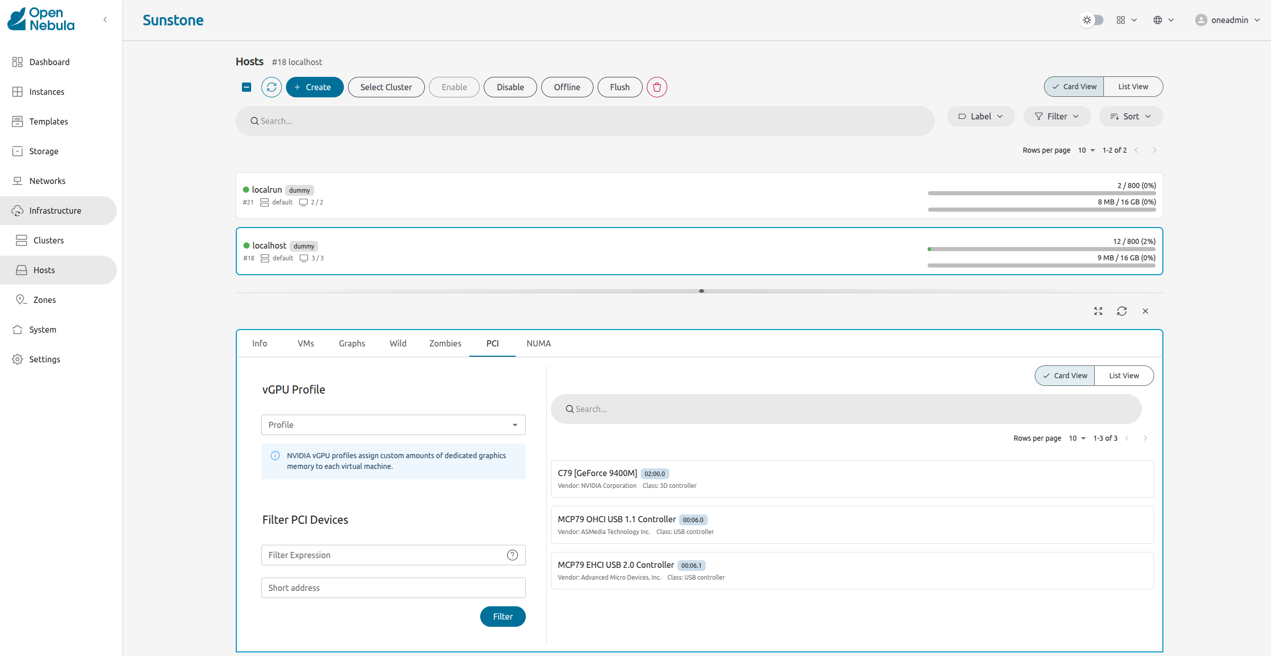

In Sunstone the information is displayed in the PCI tab of a Host:

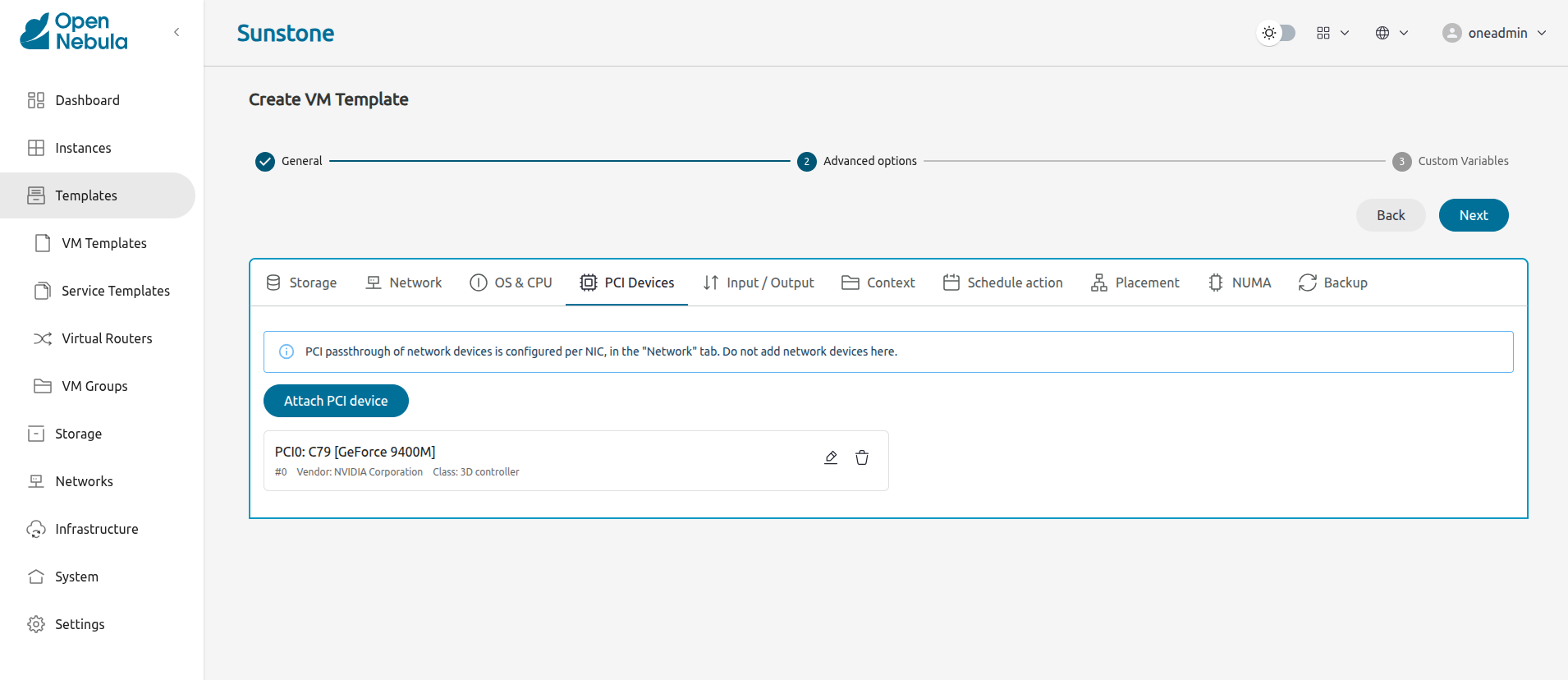

To add a PCI device to a template, select the PCI Devices tab when you are creating a Virtual Machine template:

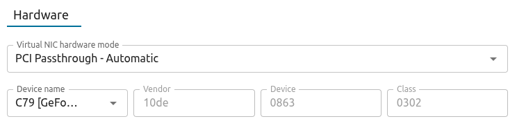

In the Network tab, under advanced options, the hardware profile of the interface can be of three types:
- “Emulated”, it includes the hardware model emulated by Qemu.
- “PCI - Automatic”, OpenNebula hardware scheduler will pick the best PCI device for the NIC.
- “PCI - Manual”, user can specify the PCI device by its short-address as shown in Host information.
Use the rest of the dialog as usual by selecting a network from the table.
