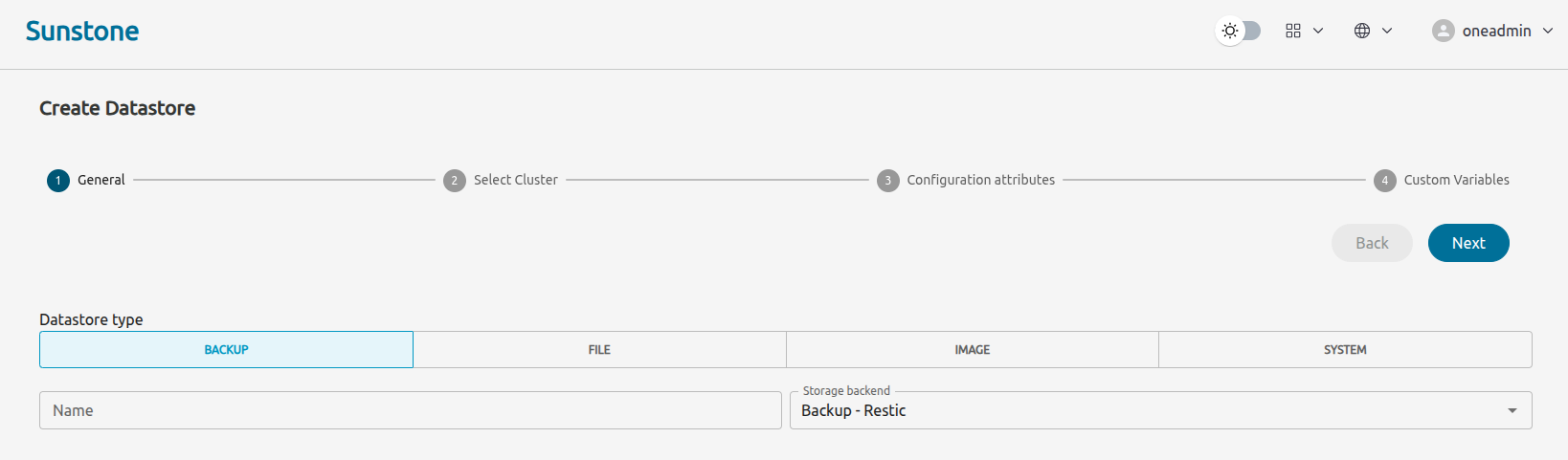

You can also create the DS through Sunstone like any other datastore:
restic_create
