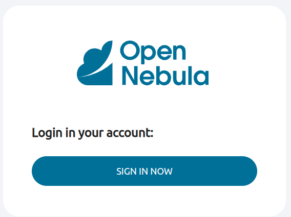

The login screen will not display the username and password fields anymore, as all information is fetched from the user certificate:

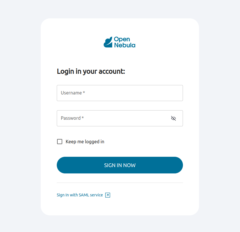

To enable the link at the bottom of the Fireedge login, you must configure :auth_redirect: <SAML_LOGIN_ENDPOINT> and restart Fireedge. Example: if using Keycloak as a SAML service, the URL must have this pattern:
:auth_redirect: ‘http://<URL_SAML_SERVICE>/realms/<REALM>/protocol/saml/clients/<CLIENT>’
In case that the redirection is invalid, please check the Master SAML Processing URL on your provider (should be similar to http(s)://<FIREEDGE_SERVER>/fireedge/api/auth/acs)

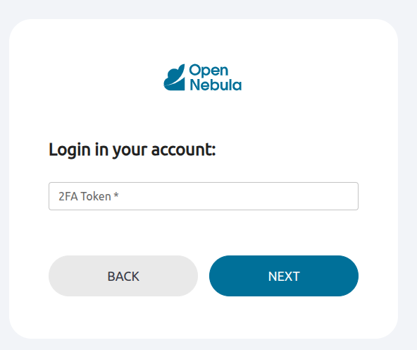

You can get an additional authentication level by using a two-factor authentication that not only requests the username and password but also the one-time (or pre-generated security) keys generated by an authenticator application.
Authenticator App
This method requires a token generated by any of these applications: Google Authentication, Authy, or Microsoft Authentication.

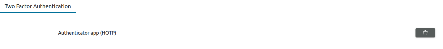

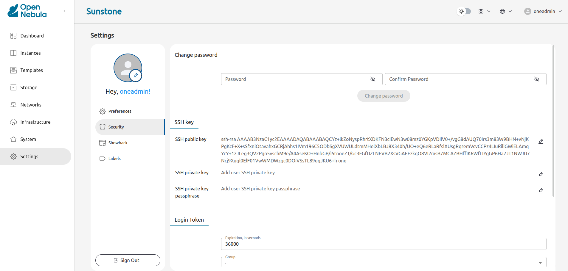

- Log in to Sunstone and select menu Settings. Inside, find the section Two Factor Authentication.

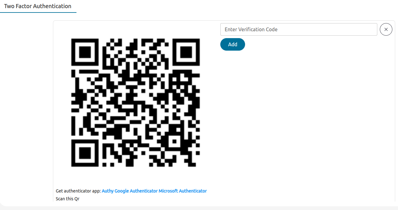

- In this section, find and select the button Register Authenticator App.
- Scan the Qr code with the aforementioned apps and enter the verification code.
Internally Sunstone adds the field TWO_FACTOR_AUTH_SECRET.
- To disable 2FA, go to the Settings, find the section Two Factor Authentication and click the Remove button.
