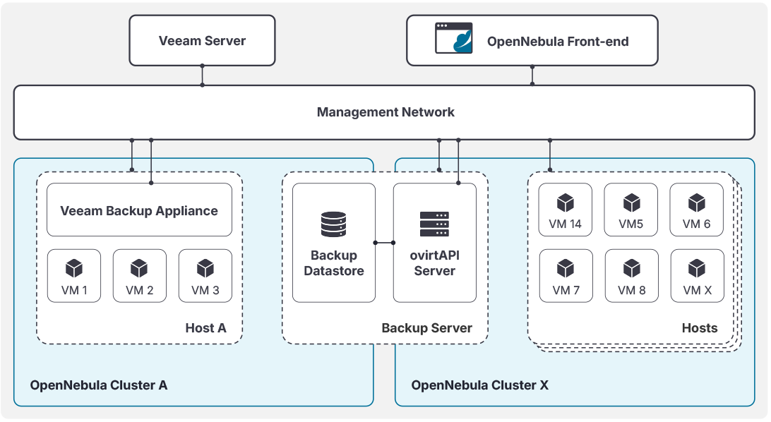

In order to achieve a setup compatible with the OpenNebula and Veeam Backup integration, the following requirements must be met:
- A Backup Server hosting an OpenNebula Backup datastore and the OpenNebula oVirtAPI Server.
- The Veeam Backup appliance, deployed by Veeam when adding OpenNebula as a hypervisor.
- A management network must be in place connecting the following components:
- OpenNebula Backup server
- OpenNebula Front-end
- All Hosts running VMs to be backed up by Veeam
- Veeam Server
- Veeam Backup appliance

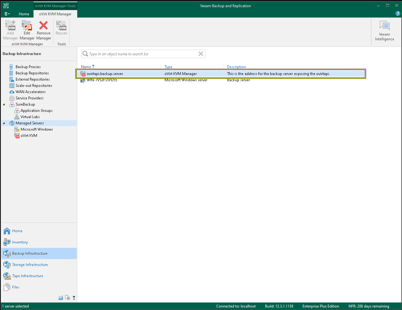

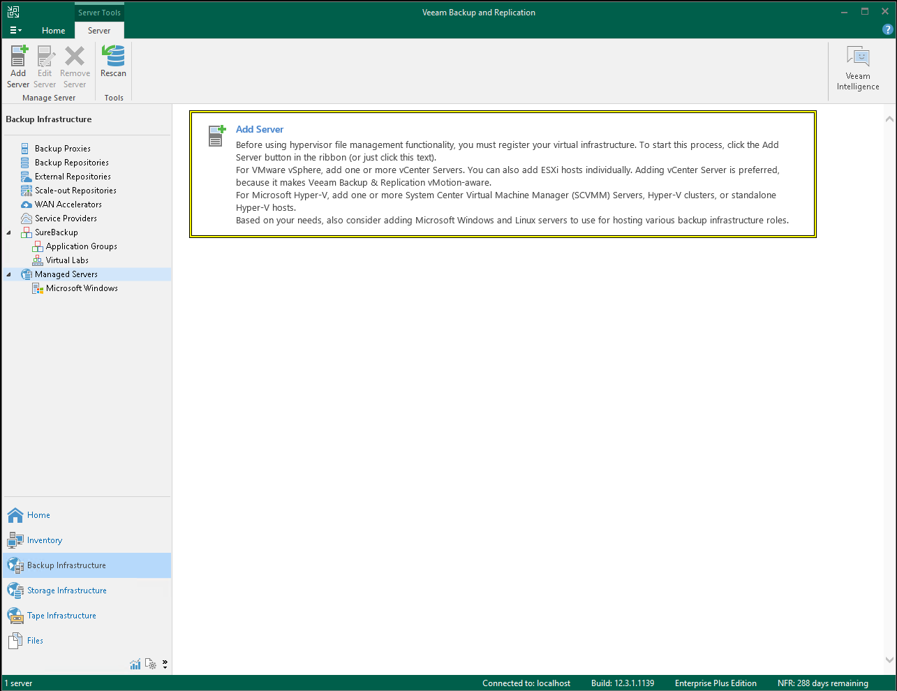

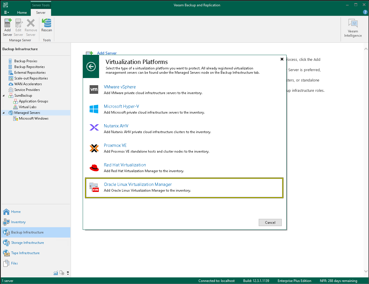

The first step should be to add the ovirtAPI Backup server to Veeam. Head over to Backup Infrastructure, then to Managed Servers, and then click Add Manager:

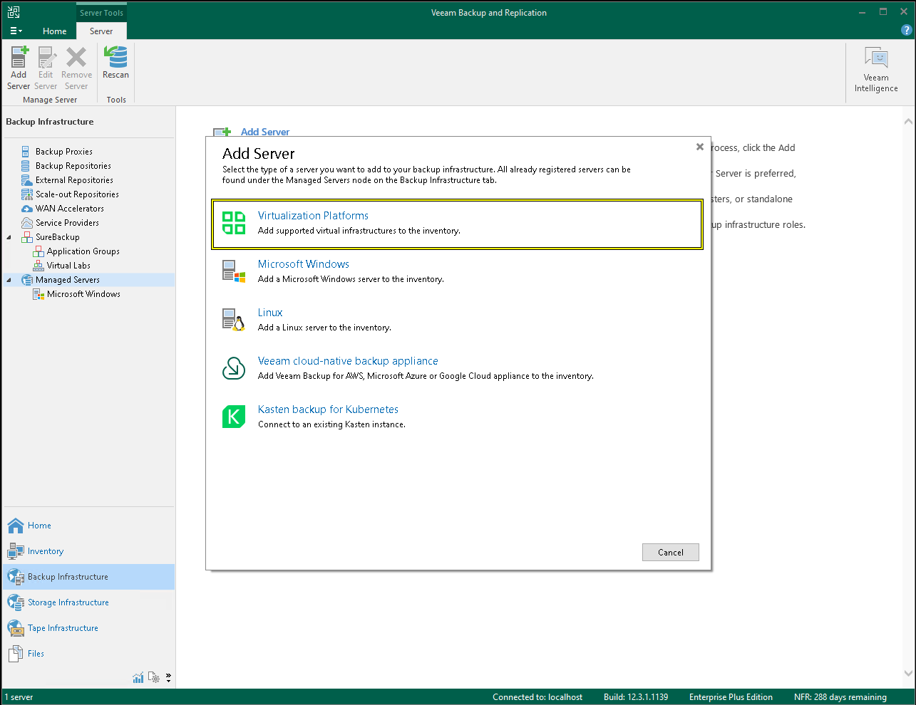

Then, choose to add a new Virtualization Platform and select Oracle Linux Virtualization Manager:

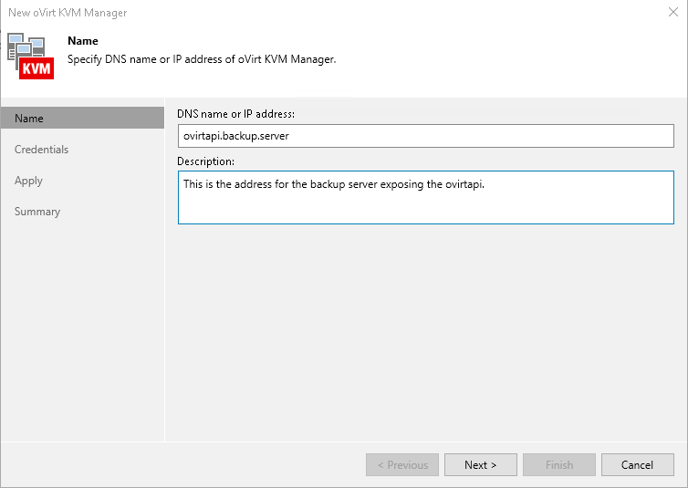

This will open a new dialog box. In the address field, you must make sure that it points to the IP address or DNS name of the server where the ovirtAPI module is installed and the backup datastore is hosted:

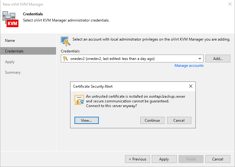

On the Credentials tab, you should set the user and password used to access the OpenNebula Front-end. You can either choose the oneadmin user or create a new user with the same privileges as oneadmin. If you are using the default certificate, you may receive an untrust certificate warning, which you can disregard:
As a last step, you can click finish and the new ovirtAPI server should be listed under Managed Servers as a oVirt KVMhypervisor.

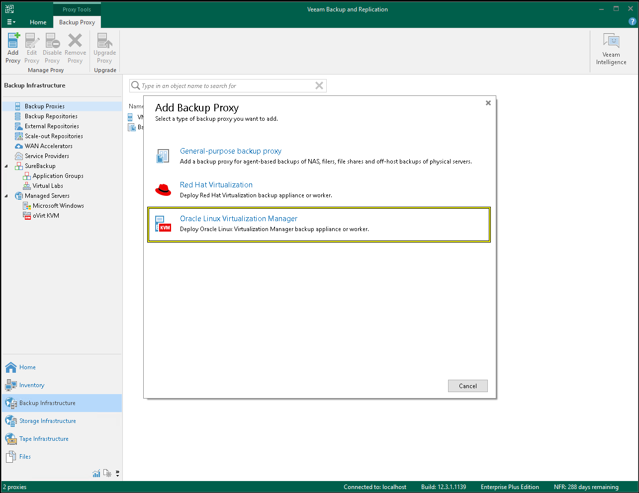

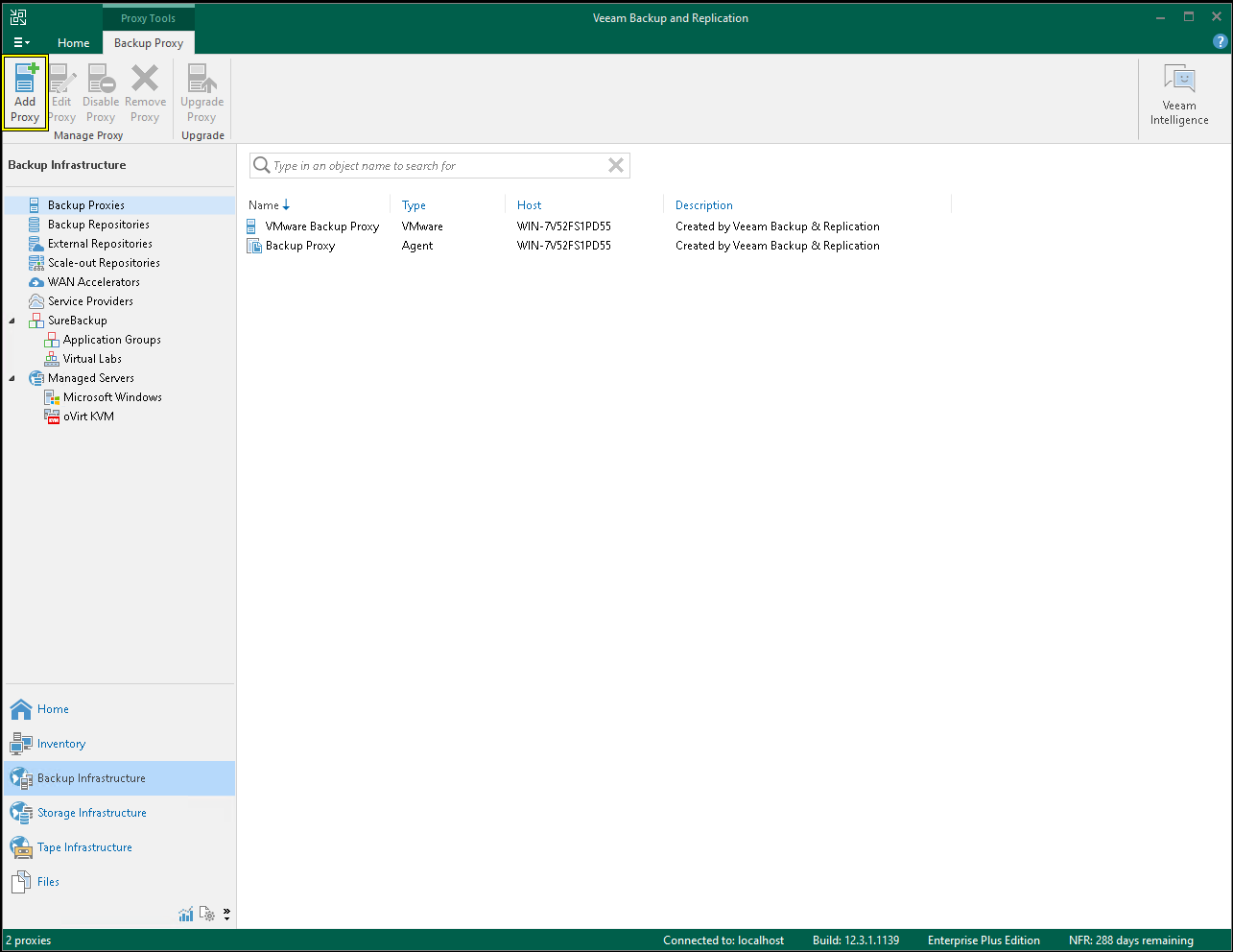

In order for Veeam to be able to perform backup and restore operations, it must deploy a dedicated Virtual Machine to act as a worker. To deploy it, go to the Backup Infrastructure tab, then Backup Proxies, and click Add Proxy:

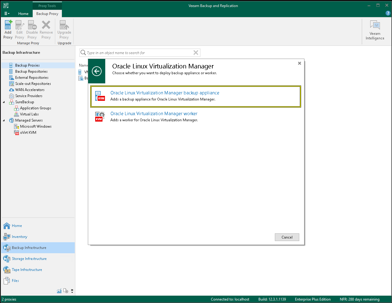

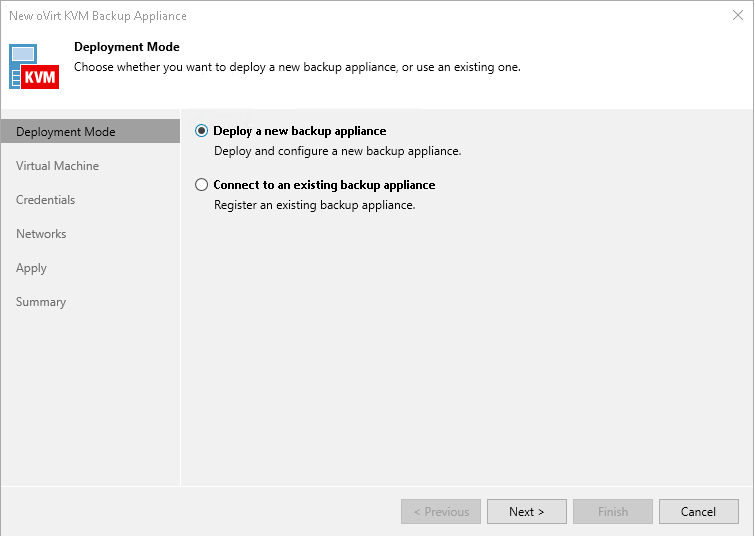

A new dialog box will open. Select the Oracle Linux Virtualization Manager, then click to deploy the Oracle Linux Virtualization Manager backup appliance:

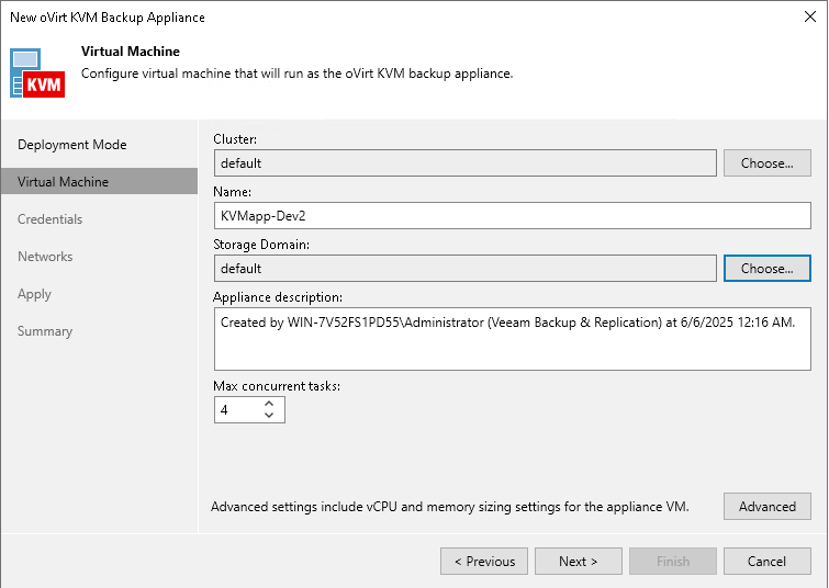

This will open a new wizard to deploy the appliance. You should choose to deploy a new appliance:
Next you should choose the cluster on which to deploy the appliance, as well as a name and the storage domain where the appliance image should be stored:

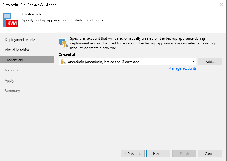

For the appliance credentials, you should choose the same ones that you set up when configuring the virtualization manager in the previous steps:

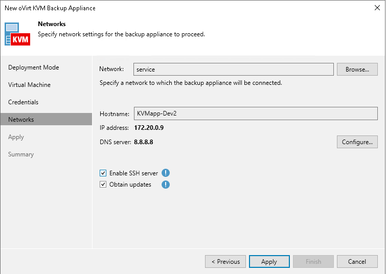

In the Network Settings tab, choose the management network that the appliance should use. It is recommended to manually choose the IP address configuration that the appliance should use:

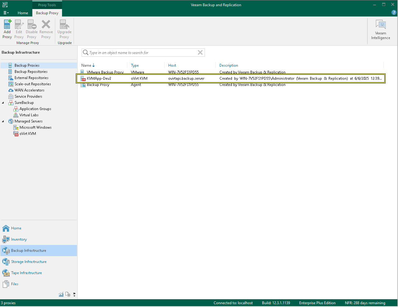

In the next step, Veeam will take care of deploying the appliance. Once finished, you should see it listed in the same tab:

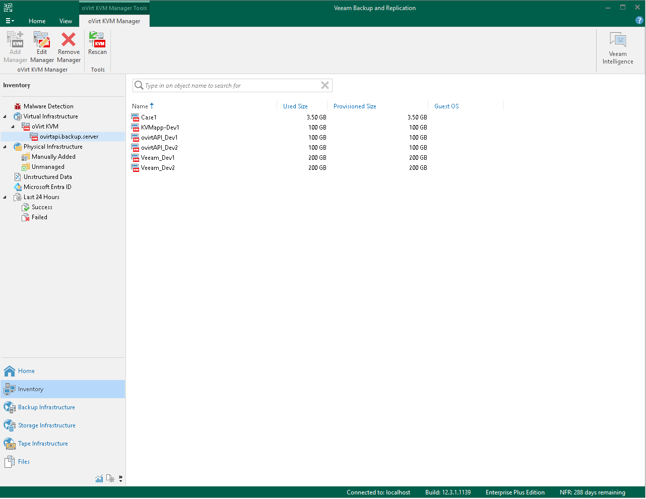

If everything is set properly, you should be able to see the available Virtual Machines in the Inventory tab under the Virtual Infrastructure -> oVirt KVM section.

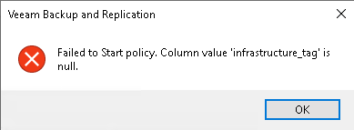

- When trying to start a backup job, the following error may appear. It can be solved by refreshing the backup job properties (even if no configuration is changed):
